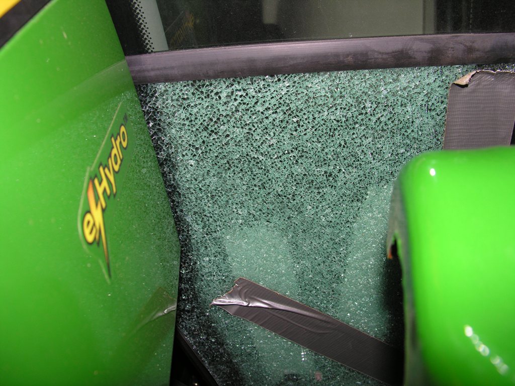

I agree the removal could get a little sketchy....the masts sometimes "pop" off the mounts as the front of the loader frame hits the ground and the masts then raise up. I think i'll always have the tractor wanting to inch in reverse a little as this process takes place.
I wouldn't worry about putting it on unless you get a little too happy with the hydro pedal.
