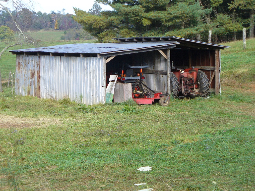

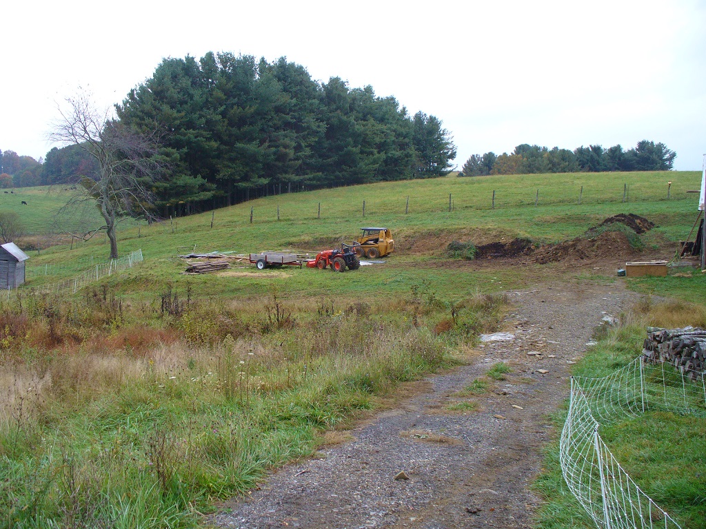

Update: A year and a half later I'm finally working on this project. :confused2:
It turns out the building is only going to be 40'x48', I originally miscalculated how many trusses, etc there were. That said, the shop and equipment storage area are both only going to be 24x40, which is kind of small. As my needs for a larger shop develop, I might just pour the other half with concrete, have the full building be the shop, and build another shed for equipment. Honestly, a 60' long building would have been pushing it size wise for the site anyways.
First order of business was tearing down the old shed. I salvaged all the tin and most of the wood and plan to use the materials to build a little three sided shed at another farm. It took a while since I was salvaging all the materials, but after a couple days I got it down.

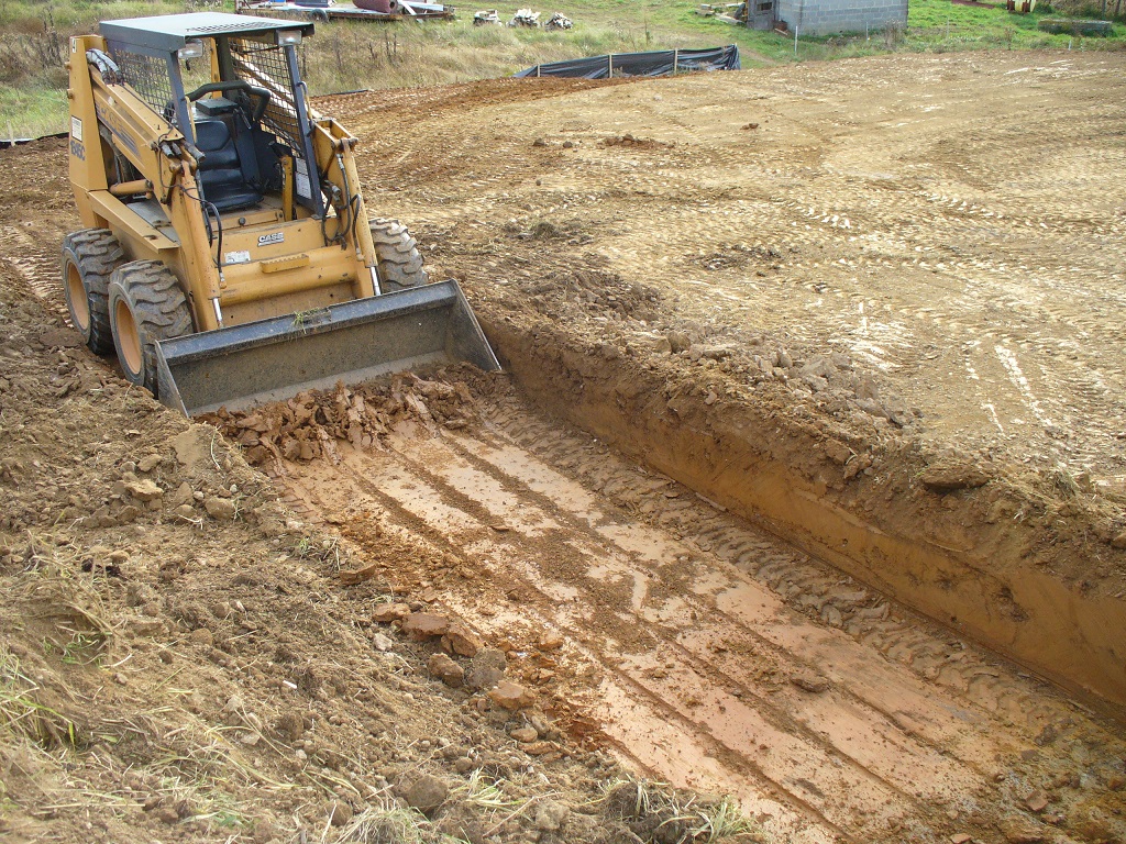

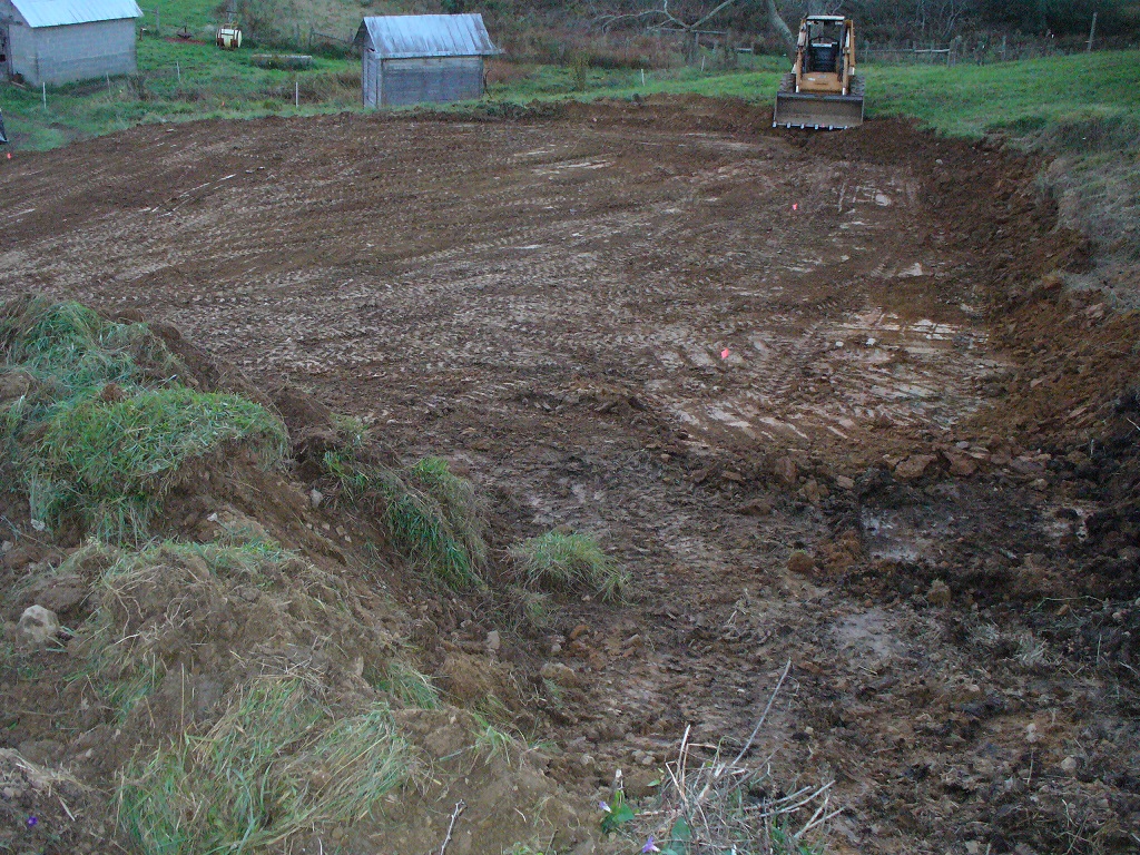

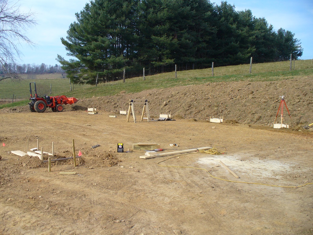

The site was already mostly level from an old building that came down years ago.... Basically all I have to do for site work is cut the bank back a little behind the building, strip off the sod and do some minor leveling. Already got started on that, more on that later.
HA! Hundreds of yards of dirt later and about 22hrs on the skid steer I'm almost done with the grading.
After I got started moving dirt and really laid out the footprint of the building, the area needing to be excavated kept getting larger and larger. Glad I got the skid steer last spring, I don't think the B3200 would have been up to this task.

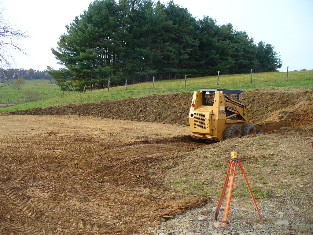

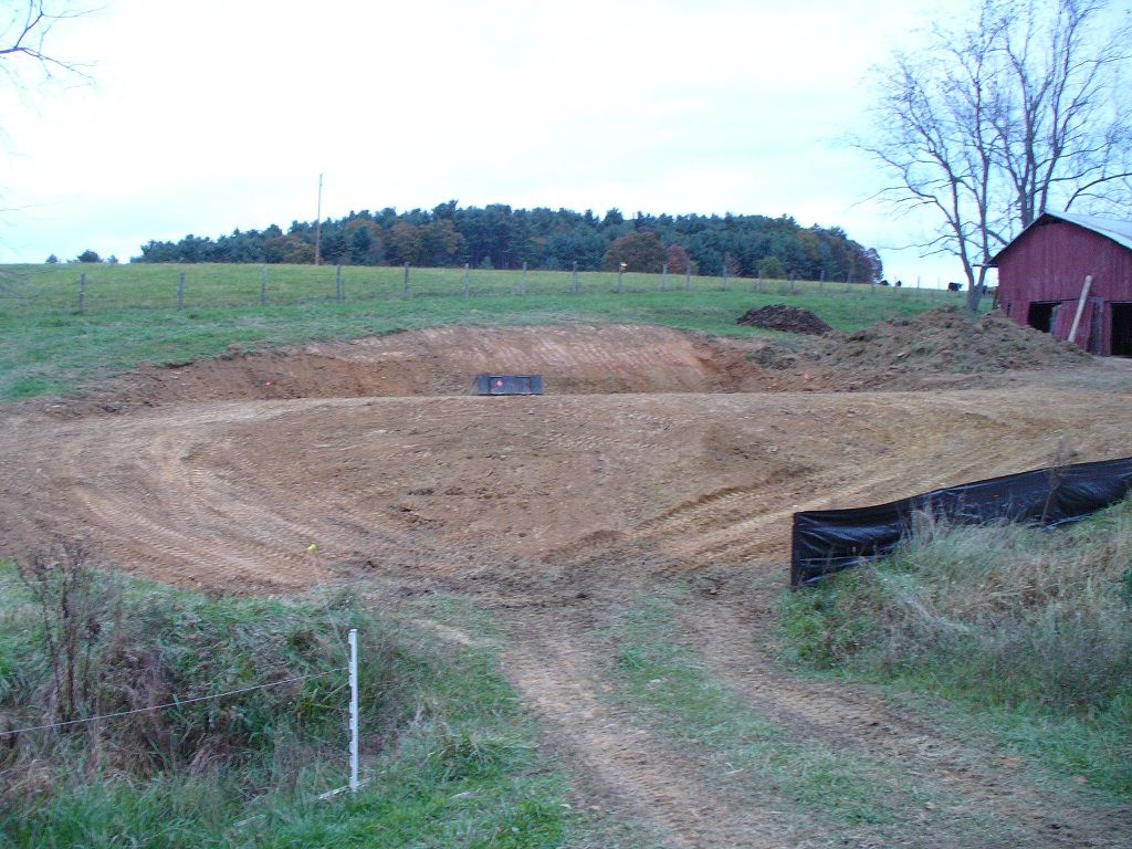

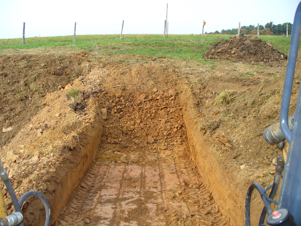

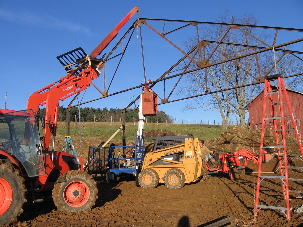

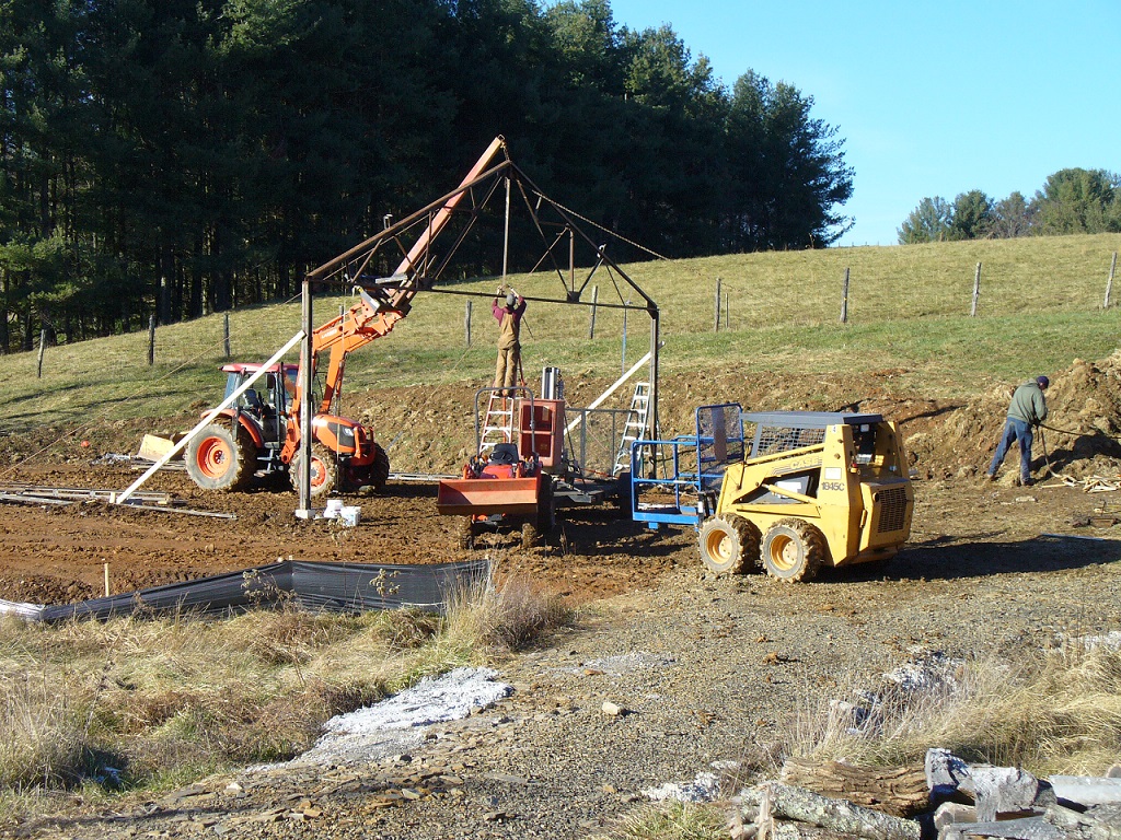

I'm finally done excavating and have been spreading top soil and doing some seeding. The next pics are of me enlarging the area in front of the shop, eventually I'll cut this back even more and build a retaining wall/loading dock.
The 1845C doing what it was made for:

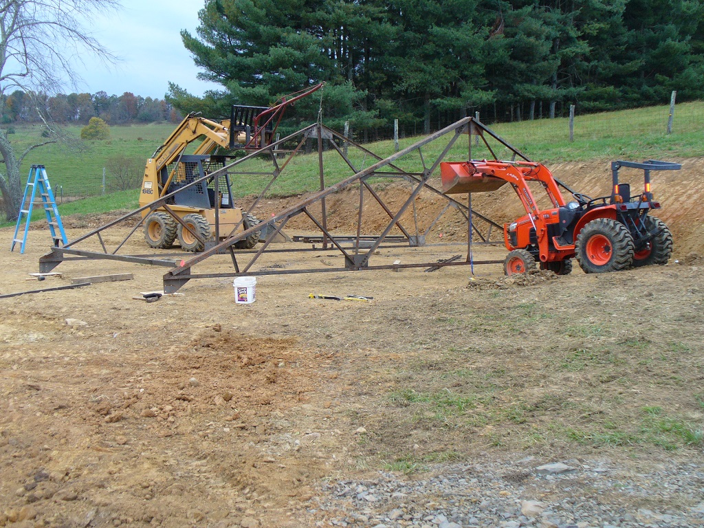

Last pic for now is of a couple of the trusses setup with the lower purlins. We set them up to get the spacings for the concrete piers. One of my friends who is a surveyor and has CAD capabilities helped me with the measurements and drew up the plans for the pier locations.
