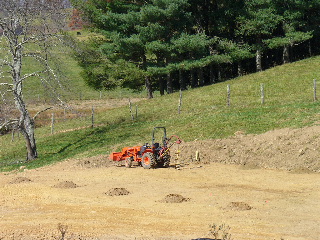

We did end up going with the 12" piers and drilled the holes today. With some good help we were able to lay out the whole building in about 15min. With a transit and a 100' tape it's really easy:
1. Set the two pins (we use 16D double headed nails) for the back wall/long side with a tape measure and line them up with whatever you like. I lined them up so this building would be parallel to the barn.
2. Set the transit over the first pin using a plumb bob and get the second pin in the cross hairs. With the tape still stretched out, set the nails at the spacing for the piers or posts (12' OC in our case), using the transit to keep them in line between the two pins.
3. Rotate the transit 90* and set the next corner pin, which was 39'11" for this building.
4. Move the transit to the other corner on the long side and repeat step 3.
5. Stretch the tape between those two pins for the other long side and repeat step 2.
6. Check the square either by checking angle to the opposite corner, which was 39*45" for this building, or checking the diagonals which were 62' 5 1/8"
As we went we sprayed a small 2" circle around the nails with spray paint and set some reference nails 5' out at two corners so we could setup the transit again after the holes were drilled. The nails were then removed and the holes drilled with a 12" auger to a depth of about 48". Once I get the holes all cleaned up I'll make some little 9" square forms for the above ground portion of the piers. I'll see if I can get some pics up soon.

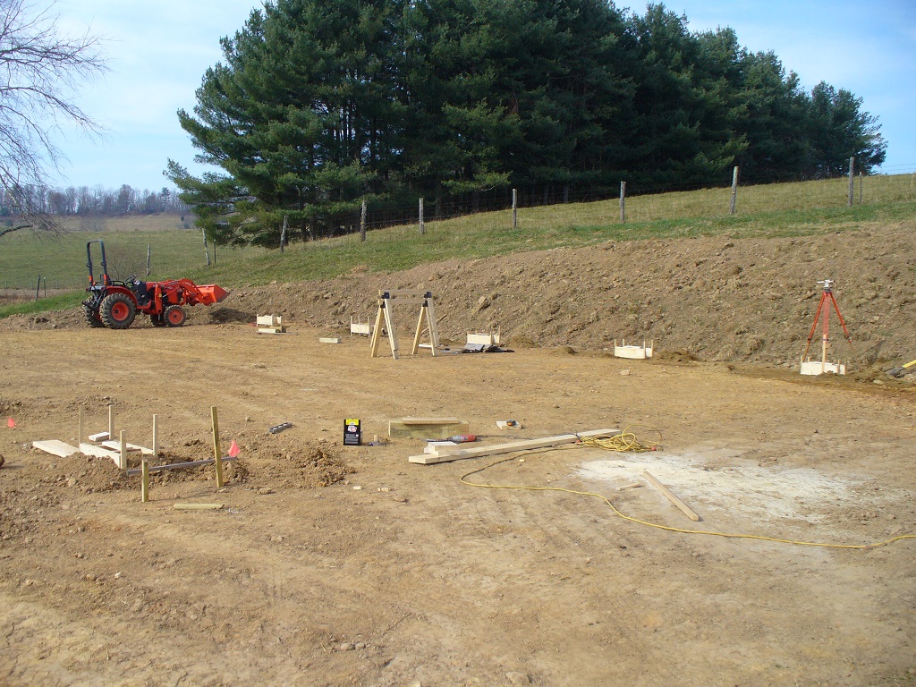

Some progress pics and info:
Holes for piers were drilled down to a depth of 4' and a diameter of 12":

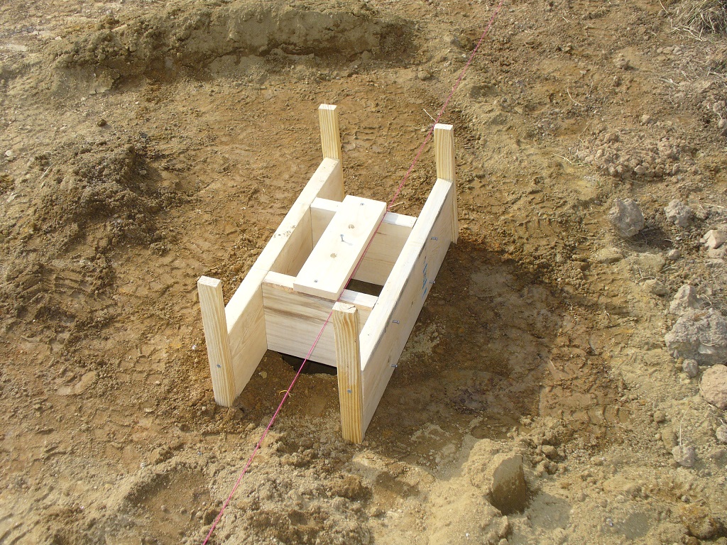

Building the forms, set using the transit and a string line, forms are built out of 2x8 and built to position the anchor bolts:
Finished piers, everything turned out square within 1/8":

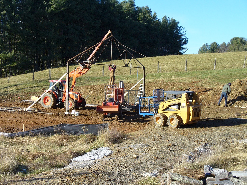

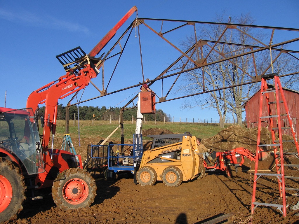

Once the piers were cured it was time to start erecting the building. The first truss was brought over and hung using a jib crane on the M9540. Once suspended we installed the posts, and set it in place, bolted it down and secured it with bracing and some triangulated rigging:
The second truss was brought in and set in a similar fashion. The tractor and jib crane were used to hold it in position while we installed a few purlins to secure it:
The M9540 worked out great, with the jib crane fully extended it would reach to 25', the top of the building is about 22'. That said, these trusses with posts attached are about at max capacity weight wise with that boom so far out:

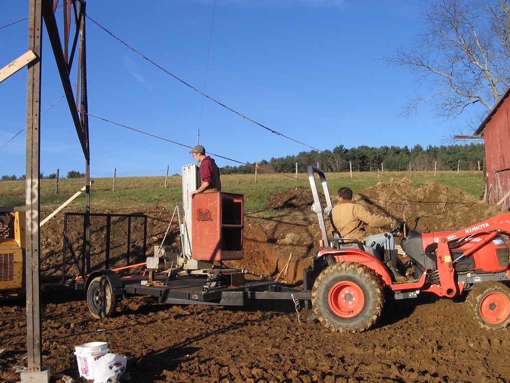

This bucket lift strapped to a trailer behind my B3200 was a real time saver. My father-in-law bought it at the same time we took down the building originally, we've used it for everything from attaching bracing and rigging to hoisting up purlins and tin:
