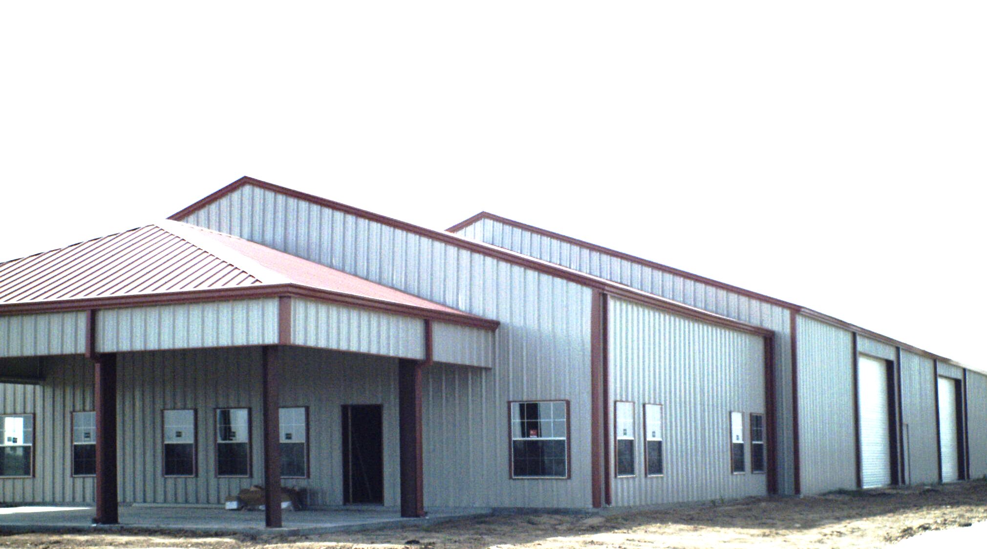

Hey Mike,
Thanks for showing off pictures of your project.
Just to let everyone know. Mike's Metal is a vibrant part of Bastrop Texas and a mainstay in the Central Texas Construction Industry. Whether you need a small tractor shed like Mike here or a 10,000 sq ft air plane hanger, we can do it. just as we have been doing all over Texas and Louisiana the last three and half years. view our website, and give us a call. Mike's Metal Steel Building Construction If you need a cost comparision, let us know. Remember to ask about rigid end walls, what type insulation, do they include doors. We have found lately, many suppliers are providing "purlin" buildings without rigid end walls and have seen buildings delivered with no doors or trim. when pricing compare apples and apples. if you need help email us.
