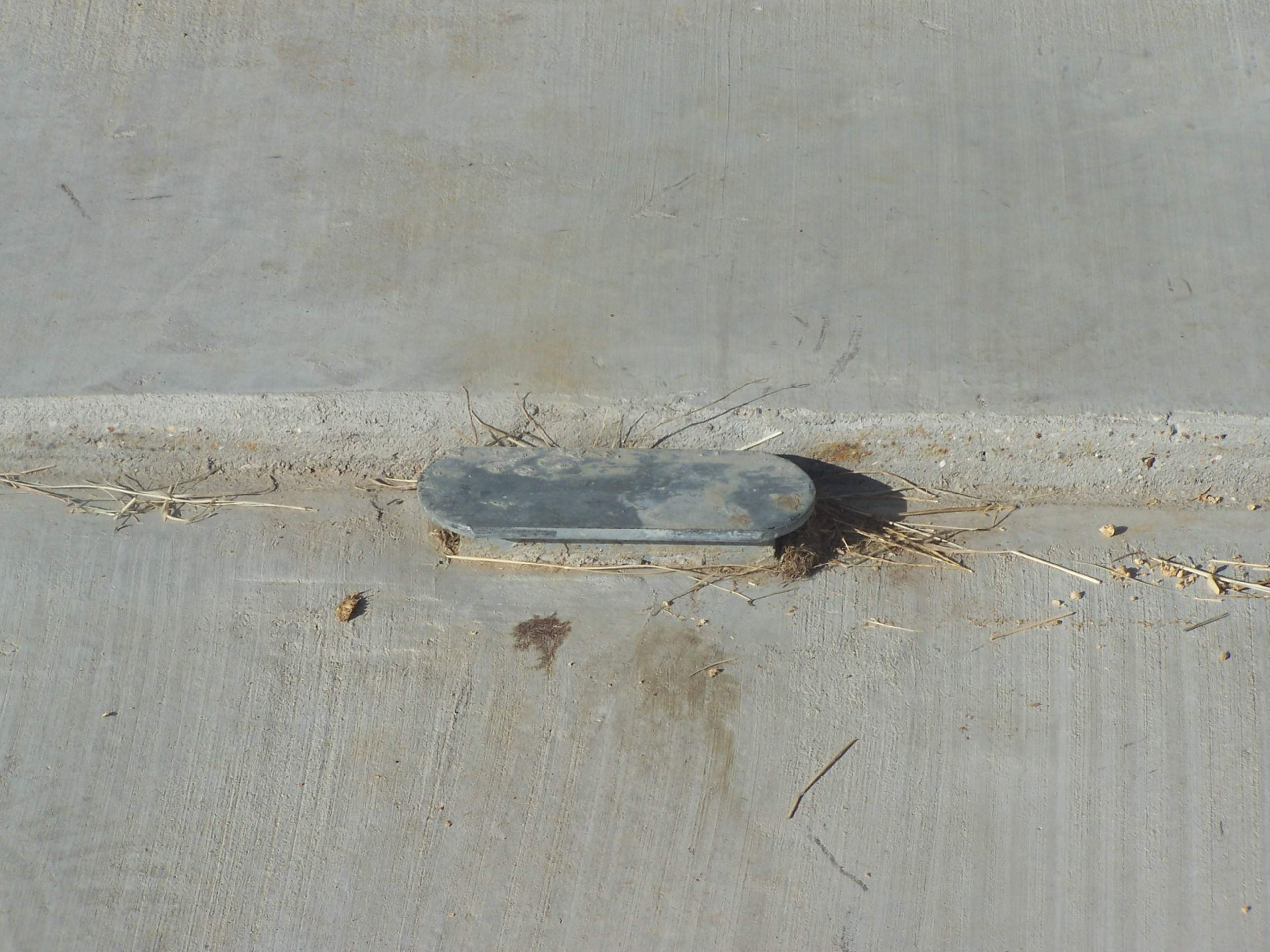

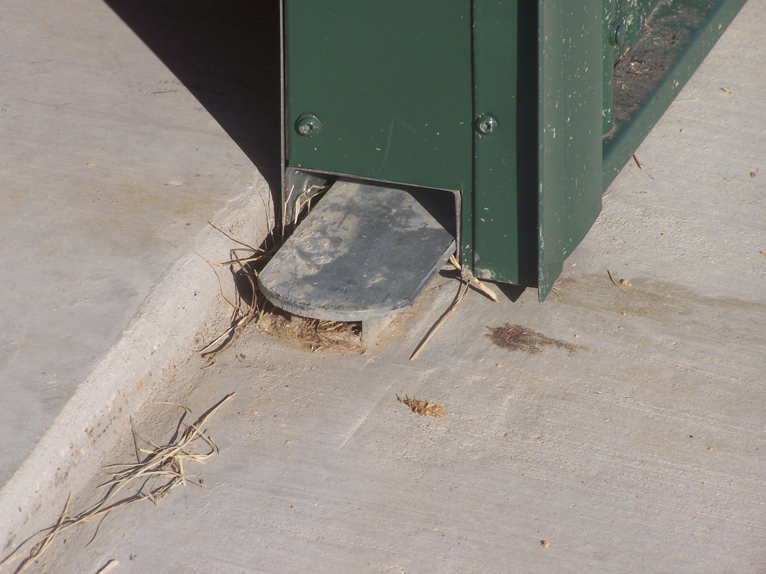

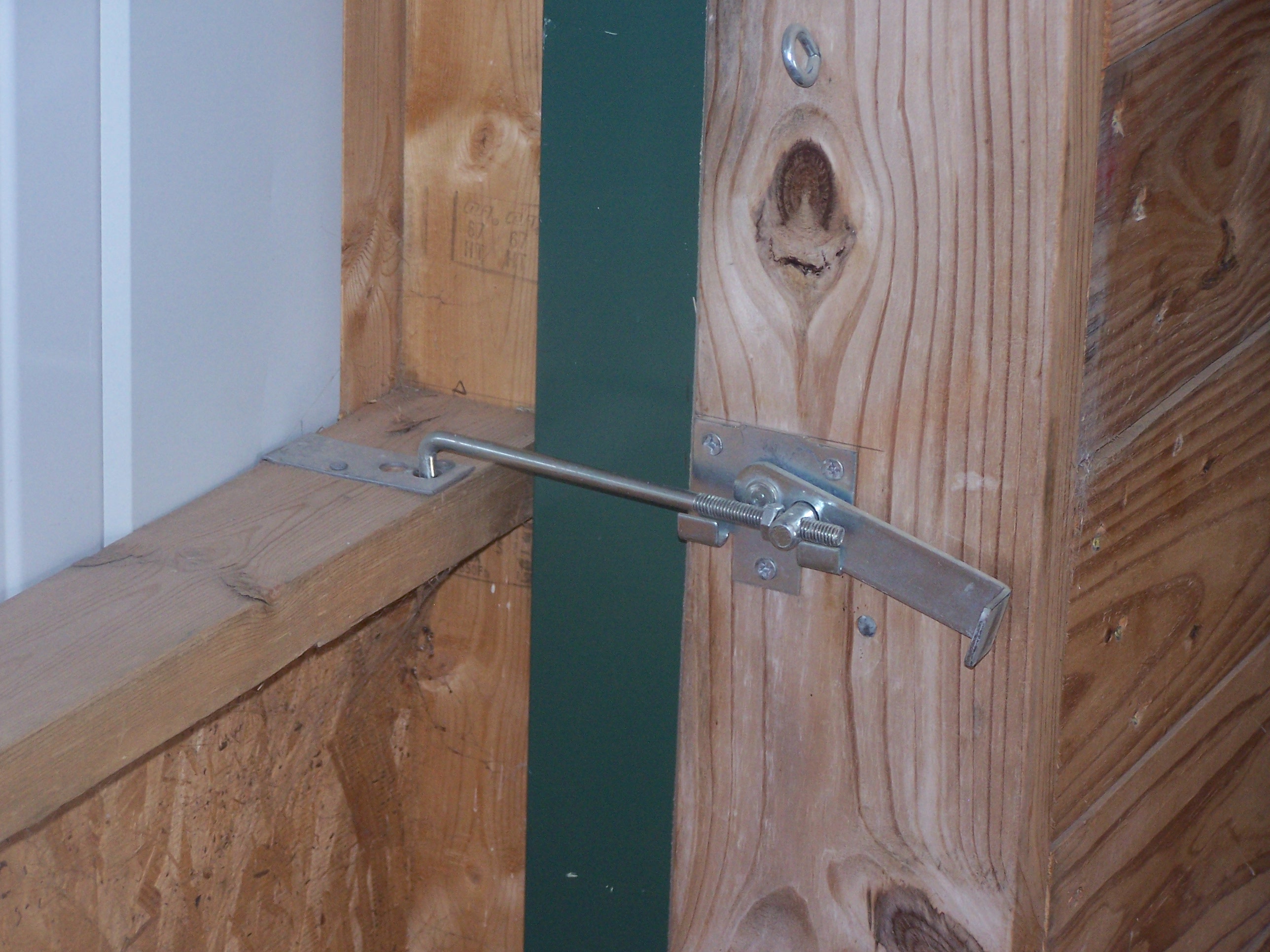

Very nice barn and thread!
Any particular reason you went with 2 different types of doors?
The barn doors add to the look and also give you about a foot more vertical clearance than the roll up doors. IMHO -What you loose using the barn doors is they are less secure than the roll-up doors. The barn doors have a cam lock mechanism on each side holding them closed against the walls but they can still bow out in the center where they meet. My plan is to use a vertical rod that will lock in the center that will slide into a recessed pipe in the concrete when I get that poured. That should add some security to the doors.
   / 40x64x12 Pole Barn started (and finished!) #28

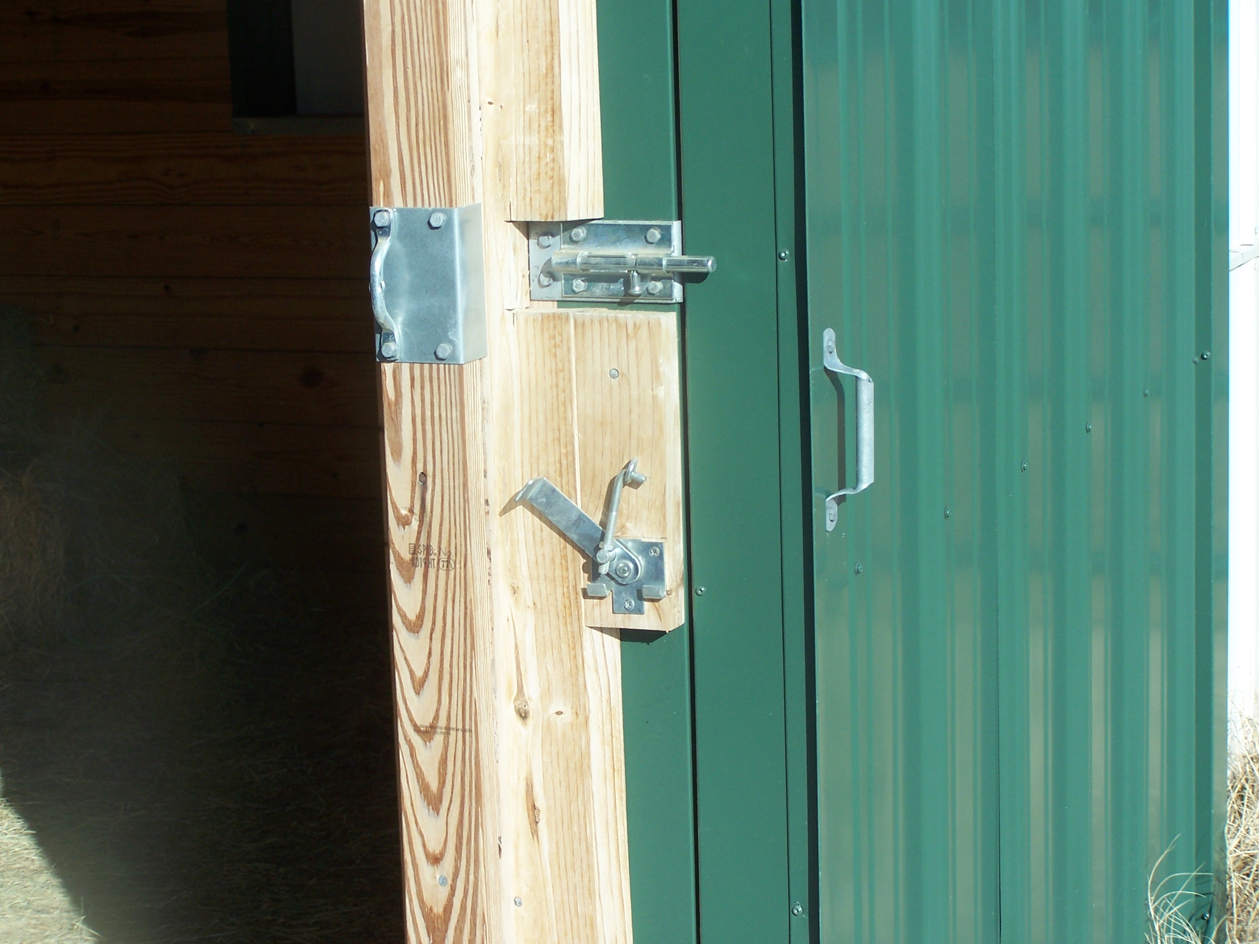

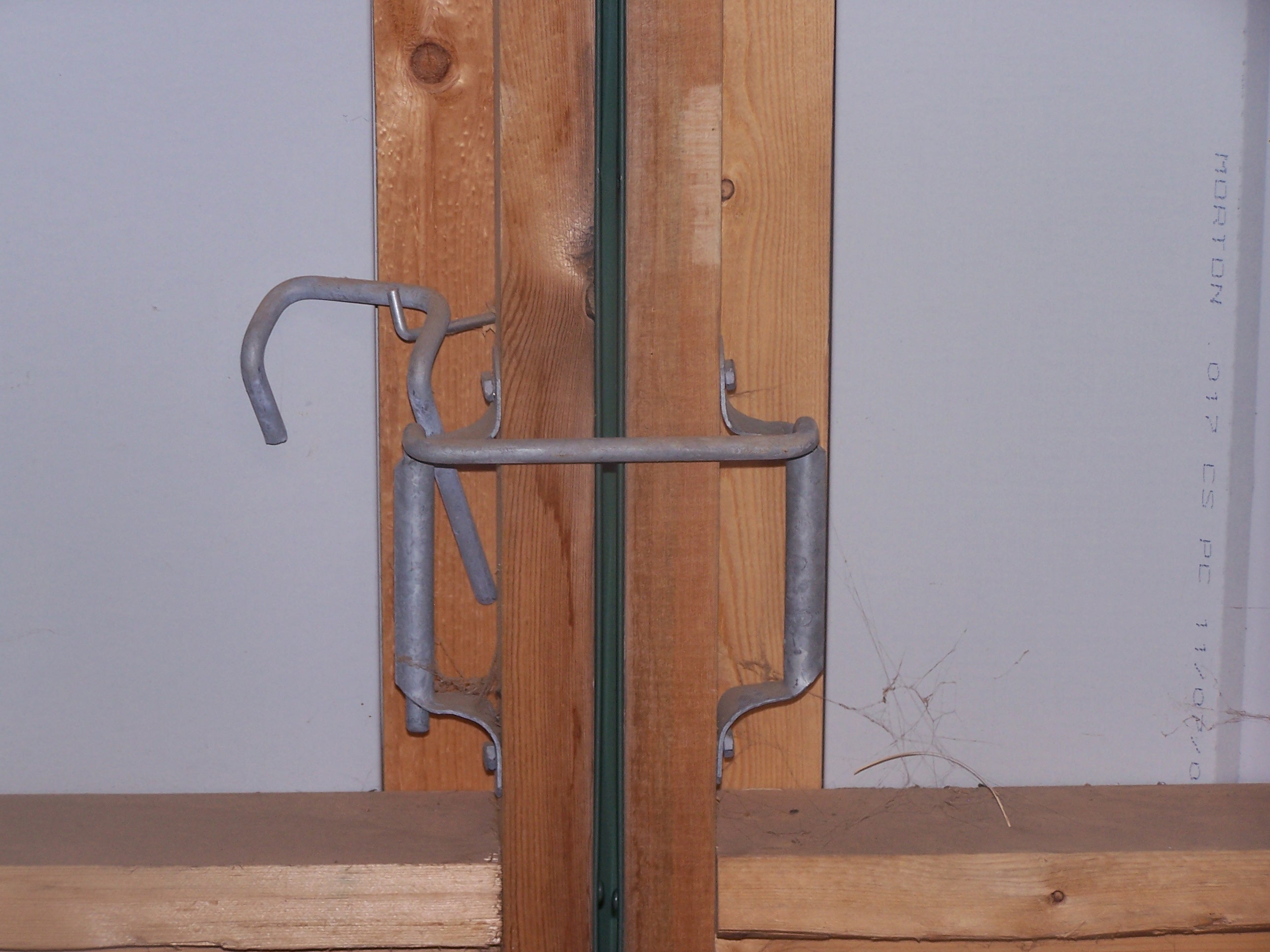

Nice building. My Morton building has the cam locks on the sides. Here is how the bottom is secured. The door handles are secured inside with the large bent rods. The smaller rod is for the outside handles. Once the sliding doors are secured from the inside they cannot be moved and are watertight even in a blowing rain.

That center plate is exactly what I need also. I'll have to look around to find one of those. My cam locks look just like yours for each side.
