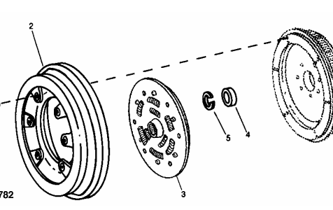

I'll suggest to check trans pump pressure. Also check to be sure hyd filter relief valve isn't stuck open. Another thing to check is determine if torsional damper clutch is holding & center hub isn't stripped out.

Since you found a possible pin, I would follow the linkage from reverser lever down to the control valve. Unhook linkage at the valve and try shifting the valve by hand to see if that lever feels normal. There should be three distinct positions. Forward, reverse and neutral. It is possible a pin fell out of the valve linkage internally while in neutral position and now won't move. Also another thought, if you have access to a borescope camera, try removing the starter and then look around inside the clutch housing to see if you can see any broken springs that could indicate a failed torsional damper. Lever 17 in first diagram will be reverser valve.

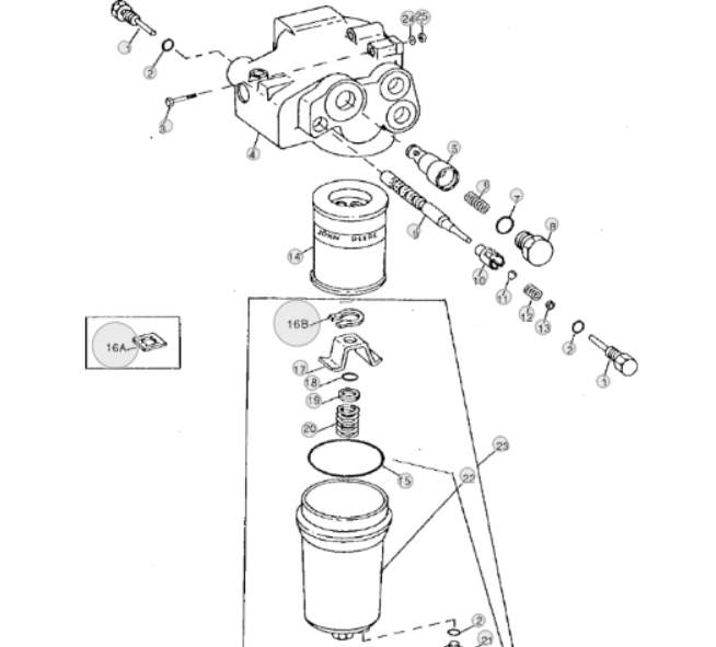

ordered a hyd pressure gauge yesterday.. the operators manual isnt showing me anything about a filter rv.. any ideas where to look for it? and how would i check the torsional damper?
   / 410C transmission wont pull #20
Without the aid of a tech manual will guess relief valve is key 5 or maybe 9.
