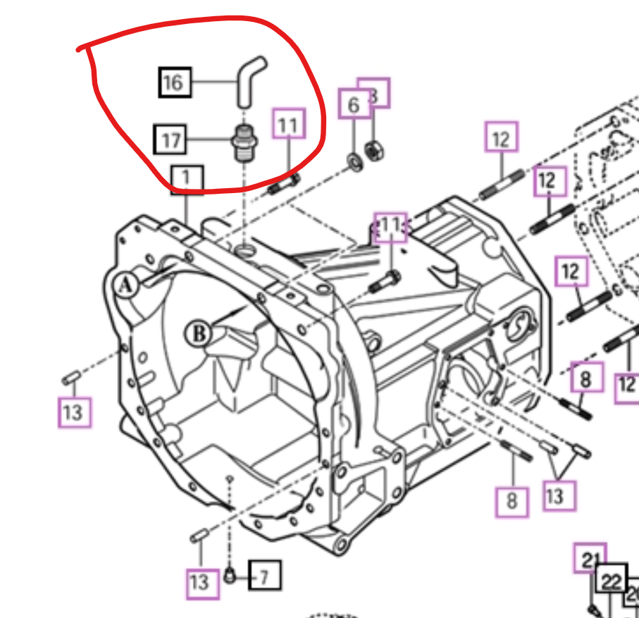

I can crawl around and look for the vent. Any idea what general location it might be? tying to save some time if anyone knows where to start. The only thing I see on the diagrams is a line at the top of the bell housing called "oil line" which looks to be in a totally inappropriate location, directly over the clutch, for an oil line.
   / 2665- keeps gaining oil in the crankcase. Any other sources other than Hyd Pump? #12

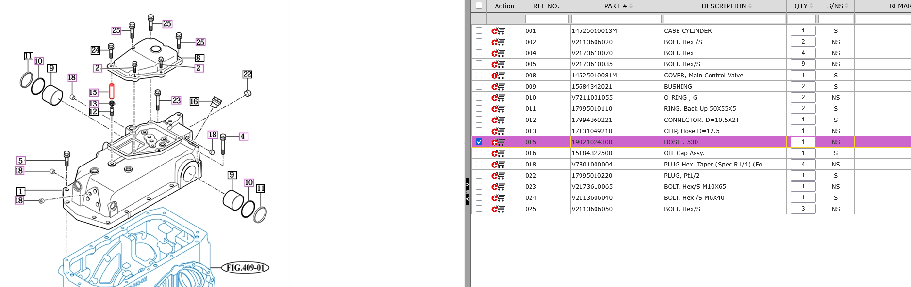

This should be it (#15), albeit it's not very evident. It's essentially a short piece of rubber hose, probably coiled, on top of the rockshaft housing. Probably under the seat and hard to get to.

#13
Thanks, I was looking in the wrong place for it. TPH hydraulics, of course...
It's a cab model, so it's even more fun to get to!
   / 2665- keeps gaining oil in the crankcase. Any other sources other than Hyd Pump? #14
It might be accessible from the rear though. It usually is. Unless there is a fuel tank in the way.

Found it, exactly per the dwh. Can sorta reach it through the rt wheel well. I'll put a wire through it tomorrow, but everything looks pretty clean under there.
