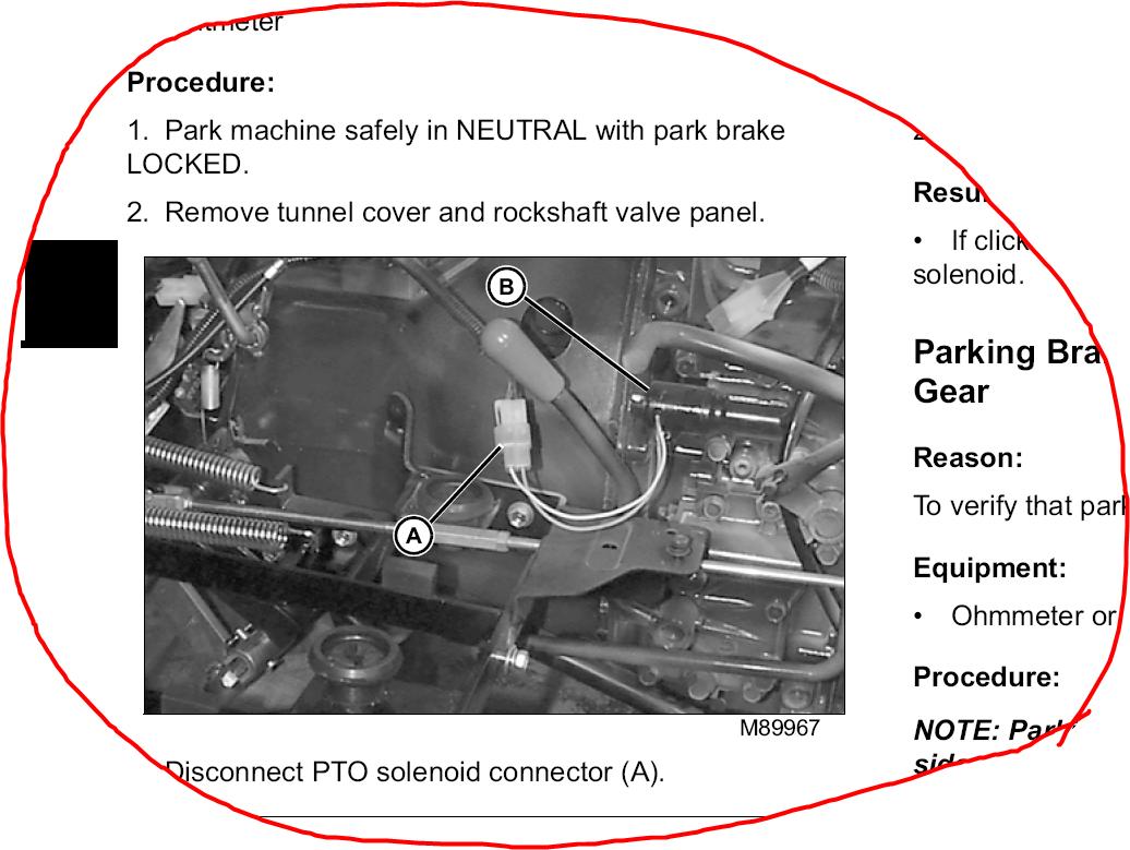

The PTO is electrically operated, and since you mentioned squirrels chewing wires you need to check the wiring to the solenoid:
