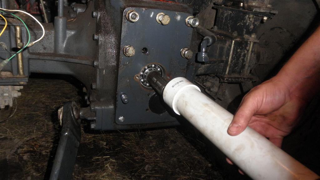

A 2" pvc coupling and short section of pipe made a great tool for tapping in the PTO shaft. I do not have pics tonight but I also installed the gear shifter fork.
BTW - I found the spring and ball for the shifter fork in the oil when I scooped and soaked up the last of the oiul from that chamber. They must have dropped there when the shaft came out of the fork. I made a tool from 1/4" round stock to compress the spring while I reinstalled the cotter pin behind the spring.

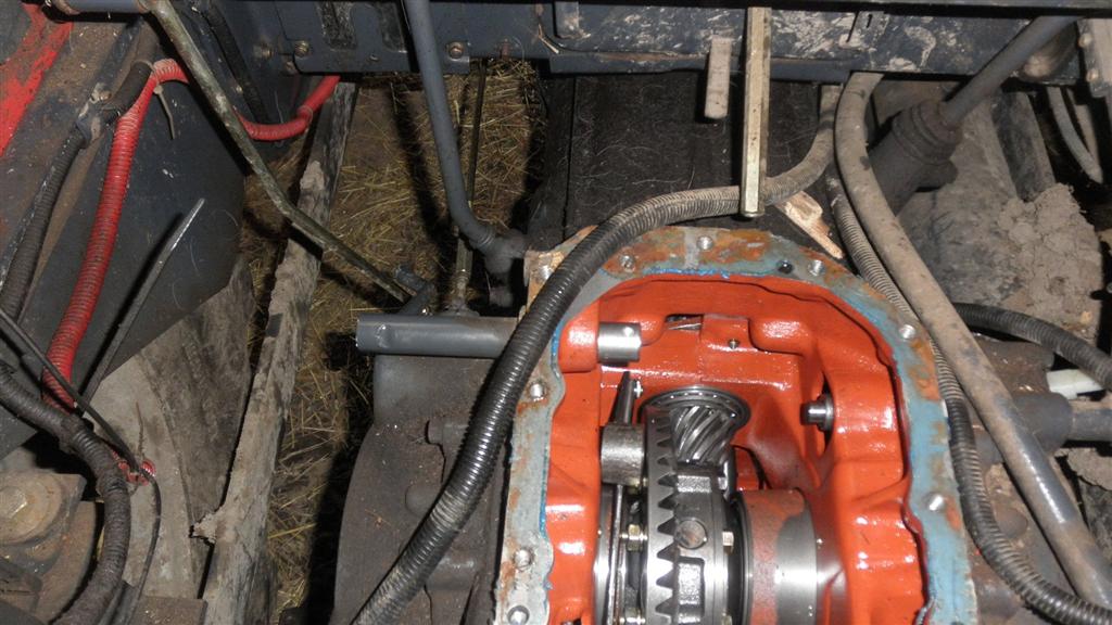

well i have the cover off of my tractor and can see the gears. I am very thankfull to find that my top gear is fine. However the bottom fixed gear is half chewed up, due to the top gear not seating all the way into the bottom gear. I have not tore the gears or shifting fork out yet. I am going to call Galen on monday and see if he would like to stop over and see first hand what is going on with our tractors. I would be interested to know if this problem is more then just our tractors or not. And again thanks so much for the step by step and pictures.

I am working on mine tonight.
If upper gears are good, I think you can get lower shaft out without pulling the upper ones.
I may be too late, but if not : try moving them to nuetral and dropping the drawbar bracket off the outside of the tranny. My lower shaft pulled easy, so you may be able to do it without pulling upper one with a little wiggling.

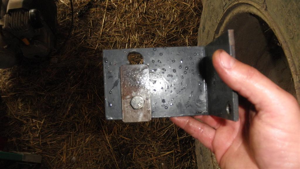

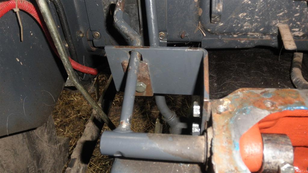

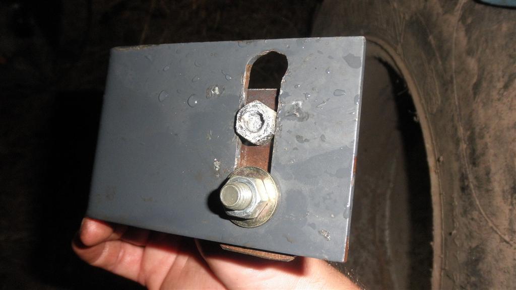

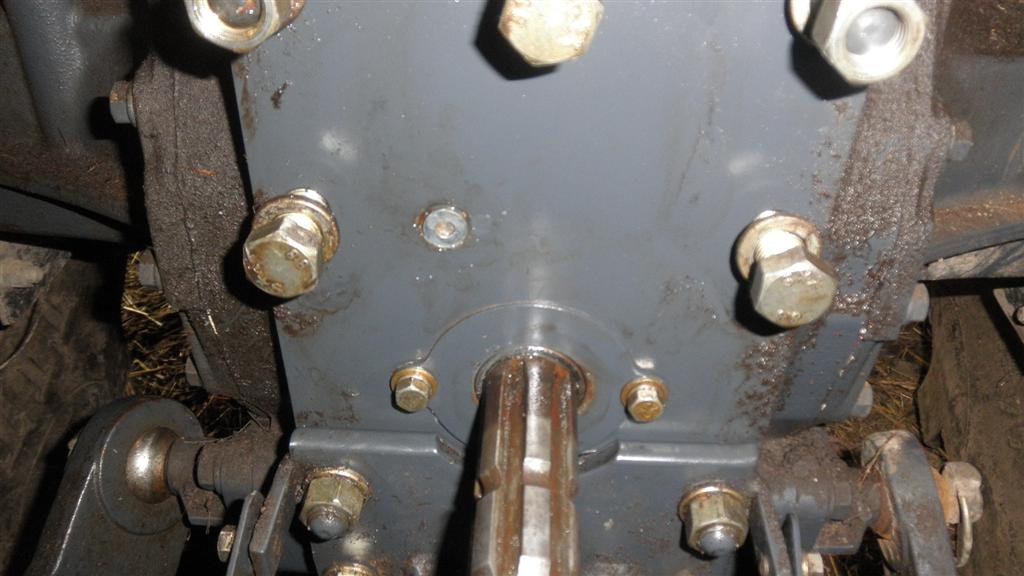

Modifications to improve location of shifting detents and a modification to limit the machine to 540 were completed Friday.
1. In the first picture the drilled dimple in the shifting shaft (upper left corner of tranny case as seen in photo) was deepened to around 1/4" deep and then reinstalled.
2. Second picture is back side of bolted in blocking plate to keep it in 540.
3. Third picture shows front side of same bracket
4. Fourth picture is the bracket with blocking plate installed (as seen from back of tractor). Note the shifter extension that goes out into operator platform is left off.
5. The last picture shows the washer I used as a spacer to hold the shifting fork guide shaft slightly forward.

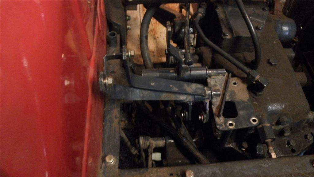

Worked on a lot of misc. stuff tonight. these shifters were reinstalled, as well as the 3pt drain speed knob. Working my back out, probably 2-3hrs of work left at this pace.

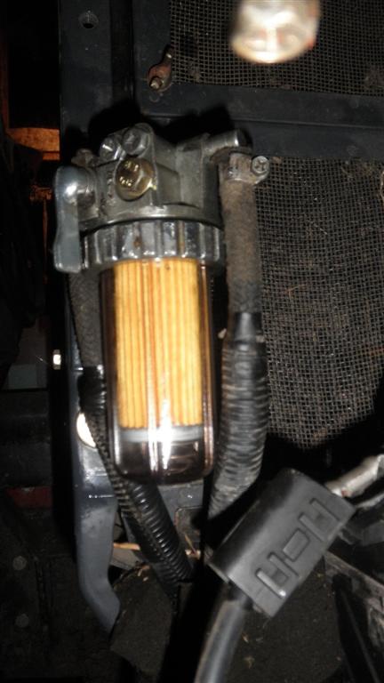

It looks like i got every once of life out of that fuel filter. this was one of the small jobs tonight. I am going to get alot of long overdue maintenance done while I am motivated.
