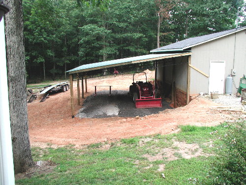

I am almost finished with my tractor shed, here is a picture.
24ft x 34ft

Here is a different angle /forums/images/graemlins/smile.gif

I like those steel cieling raftor beams. Major beef there! Did you dig out as close to the building building floor as the pictures makes it look like? I would be concerned about the soil eventually giving way from undernieth. Or are you planning on a reinforcement wall? Nice set up!

I just built a similar type structure on my existing pole barn. I used wood joists, but I braced between my poles horizontally and perpendicular. I am also enclosing the long end and attached my joists to the end of the existing roof rafters. Don't know how the steel assists in side to side strength, but you may want to think about some cross bracing. Look at the walls on your current structure.

Yes , I did dig flush with the concrete pad with intent of forming inbetween the post and pouring a wall. The steel truss are also braced from the bottom cord of the truss and I may also brace each post. Thanks and happy 4th /forums/images/graemlins/smile.gif
