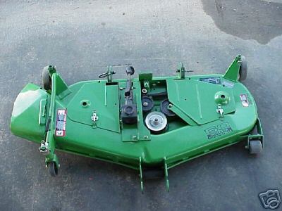

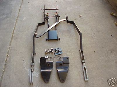

OK My 4115 has these messurments.
1. 13"
2. 6.5"
So it is the same as the 4110. Also I looked on Deere site and the only difference between the 4110 and 4115 is the wheel base is 6.5" longer than the 4110 and the engine size.
Also I looked at the parts page and compared the 3 point hitch pieces and they all have the same part number which means there all the same size and lengths. I then looked up the belly mower and compared the linkage and its all the same. It part number LVB25263.So since the 3 point hitch and the MMM all use the same parts then I don't see why this kit wont work. The only thing I might need to do is to lengthen the brackets on the MMM but thats is easy to do since they are threaded rod and can be adjusted. I just got my MMM and will have to measure the links. I might ask the dealer if I can get this kit and if it doesn't work then take it back. I thank its around $400?
   / 4115 Deere Mid Lift Mower Deck
#42
Which picture is it?? I see the 4 hydraulic rear couplers but no part number in the picture
#44
Asked the Deere dealer is I could buy the kit and if it didn't work then return it. They stated once its bought then you cant return it. I thank it will work as everything checks out but Deere doesn't list the 4115 on the kit?? Any idea on how I could buy it and return it if it didn't work?? I might call Deere direct and ask??
