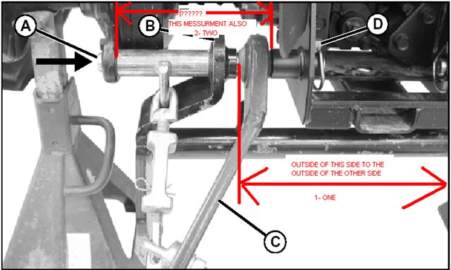

#38
Can some one look at the attached picture and post the 2 measurement for the 4110 as noted in the picture? I will do the same for the 4115 and maybe we can see whats difference is about the rear of the 3 tractors and make some adjustments for the hydraulic lift kit for the 4115 since it is only available for the 4100 and 4110. /forums/images/graemlins/smile.gif

   / 4115 Deere Mid Lift Mower Deck #39
I used a tape measure on my 4110 but couldn't get right on top of the pieces so I had to 'eyeball' the start & end point. These are close but not exact;
1. 13"
2. 6 1/2"
-Norm
   / 4115 Deere Mid Lift Mower Deck #40
Sorry for the long delay on any responds, but I been snow sking and just got back. My measurement are the same as the other post(give a take 1/8"). the pdf file you sent me has a part number on the rear coupler which is common for 4115 and 4110. I think the kit is showing 4115 tractor because the mower rear links are further apart. My links are 18" apart what is a 4115 or 4110 rear mowers links distance apart ?
