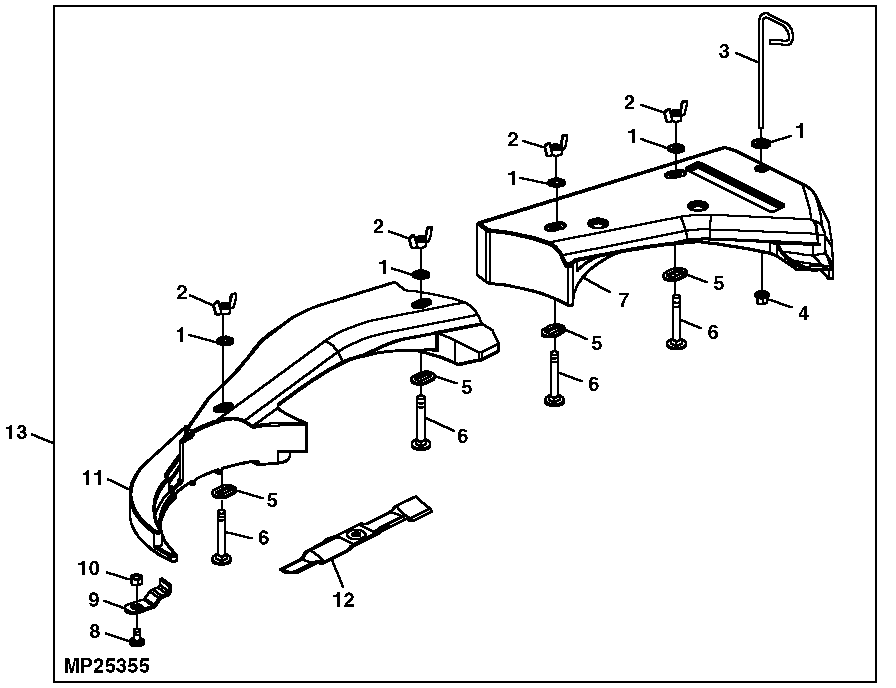

#15
I do have a 54" MMM, Jim, though I wasn't planning to have to use it as underwear. I have the mulching kit installed under it and it's not the most robust assembly of parts but rather just rotation molded polypropylene balloons held in place with a few winged locknuts on carriage bolts (I was a little disappointed with its construction upon installation last year, especially for the ~$200).
In fact, I'm afraid to remove the kit because the carriage bolt's anti-rotation lugs engage against molded pockets in the plastic balloons, a very poor design if you ask me. I'm now remembering that some of them did spin in the pockets during installation and it wasn't fun finishing the job. I think I had to press the carriage head firmly against one side while tightening the wing nut. (see image) But that's a subject for another topic.
I have a good size piece of galvanized sheet metal lying around. Maybe I'll whip up at belly pan of my own.

En,
Got it. Three is the floppy link I was talking about. It costs an extra bolt, but put bolt 1 through 8 and 3 only. Then another bolt through 2, 3, and 4 only. Moving link #3 (plates really) between 2 and 8 still give you some flex for mowing rough terrain and the front stays rigid so you can easily hook up with a quick hitch. Without a quick hitch, you probably still want link 3 up front for your top link.
Life is easier with a quick hitch.
Correction: Life is easier - a year later once you've modified all your equipment - with a quick hitch.
Joe
