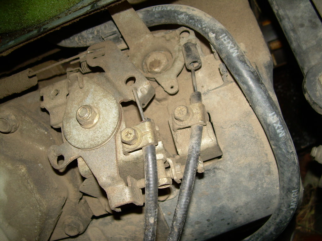

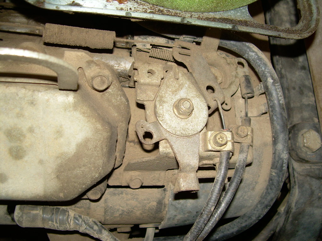

I put a new head on the 22HP Robin engine on my PT422 and have it almost complete except for the throttle and choke connections. I made some notes but want to make sure I got all the springs in the right holes. I'm having the PT towed to Ditch Witch and having the valves adjusted and the float position rebuilt on the lift valve. I would appreciate it if someone could post a picture of the connections. Not sure if it matters but the oil filling cap is black and on the side of the valve cover.
Thanks
Dan

I sent them again and will send them here as well.
/ 422 New Head...
Fantastic, just what I need to get everything put back the right way. Thanks for the help!
