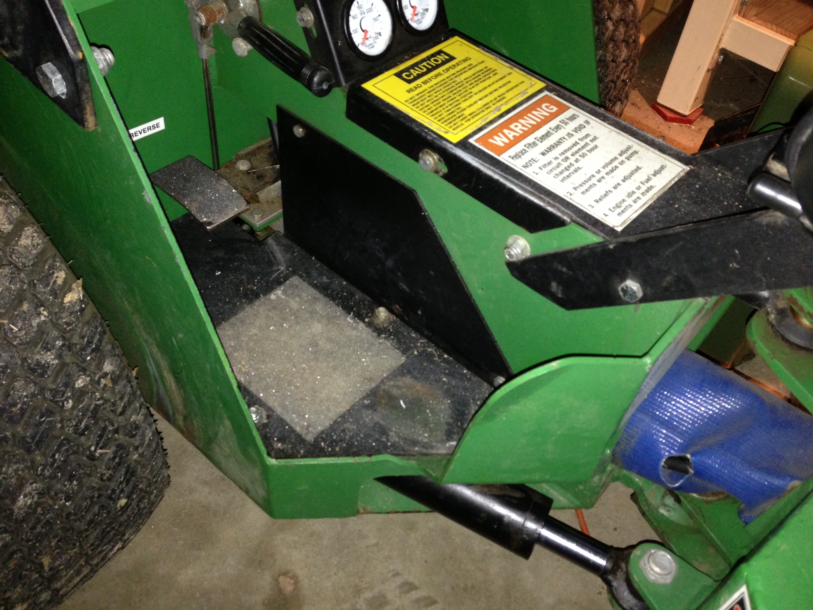

/ 422 VS 425 #8
False floor: On the 422 the steering cylinder is attached on the left side of the front tube, right were you would put your foot, so PT put a plate of steel elevated above the cylinder on both sides so your feet are at equal height. The down side is that dirt and trash can accumulate underneath and should be cleaned out from time to time.

/ 422 VS 425 #11
What is a "false floor" ?
In the picture below, the black steel floor plates (with nonskid) are bolted by 4 bolts each with risers, creating a cavity about 4" deep in which the steering cylinder operates.

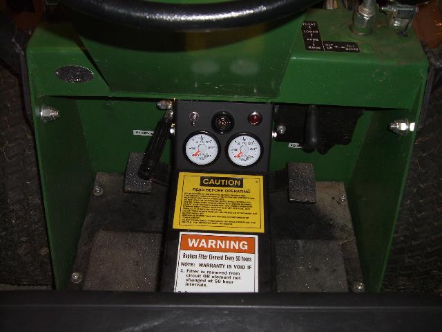

/ 422 VS 425 #12
Tim_in_CT, you have to tell me what is your dash is used for. I see a warning light and a switch and a couple gages. What do these connect to. Looks like a good install.
/ 422 VS 425 #13
temperature sender on the hydraulic cooler, temp sensor on engine oil, red light/buzzer/switch connected to low engine oil pressure warning.
My installation, not a factory option.
