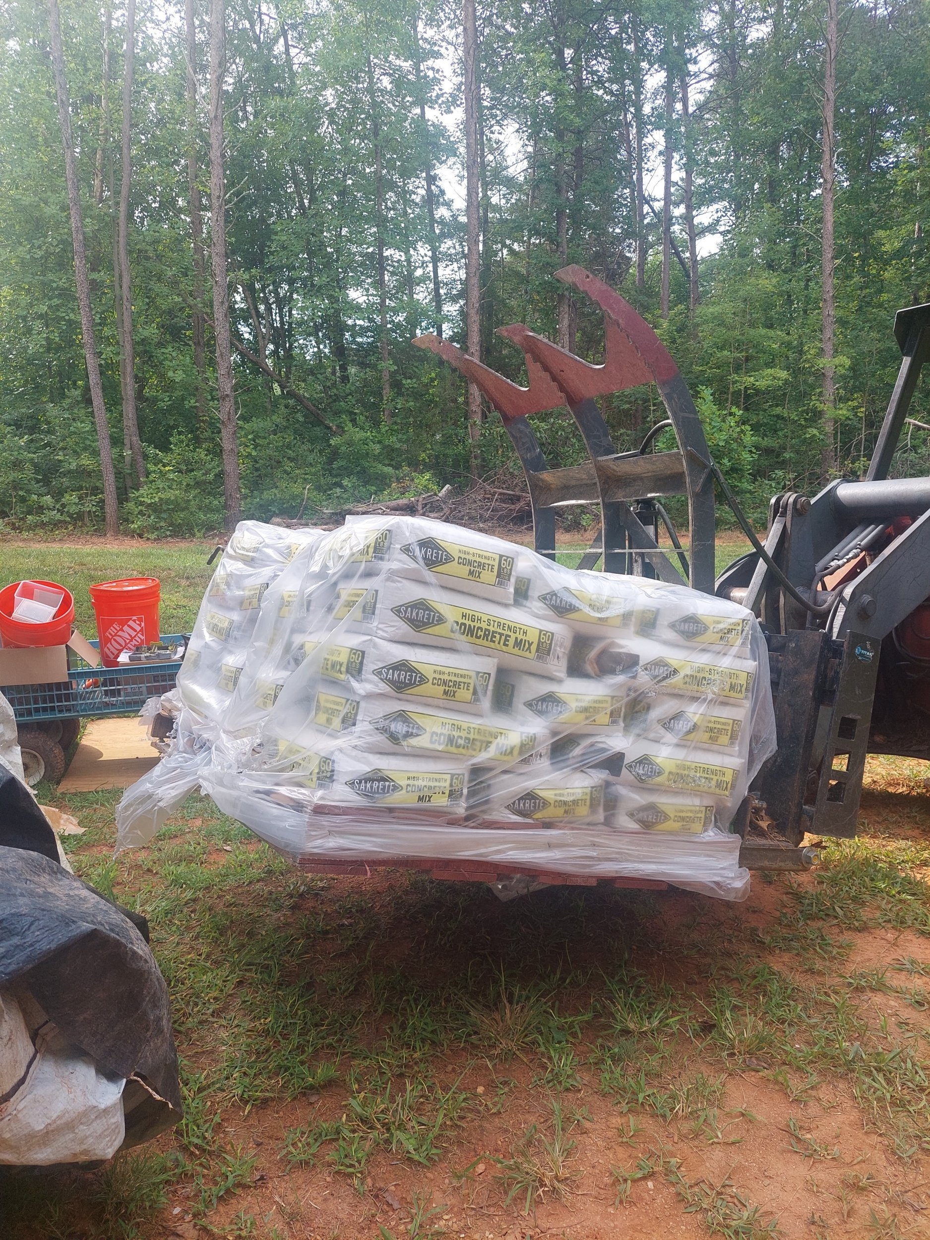

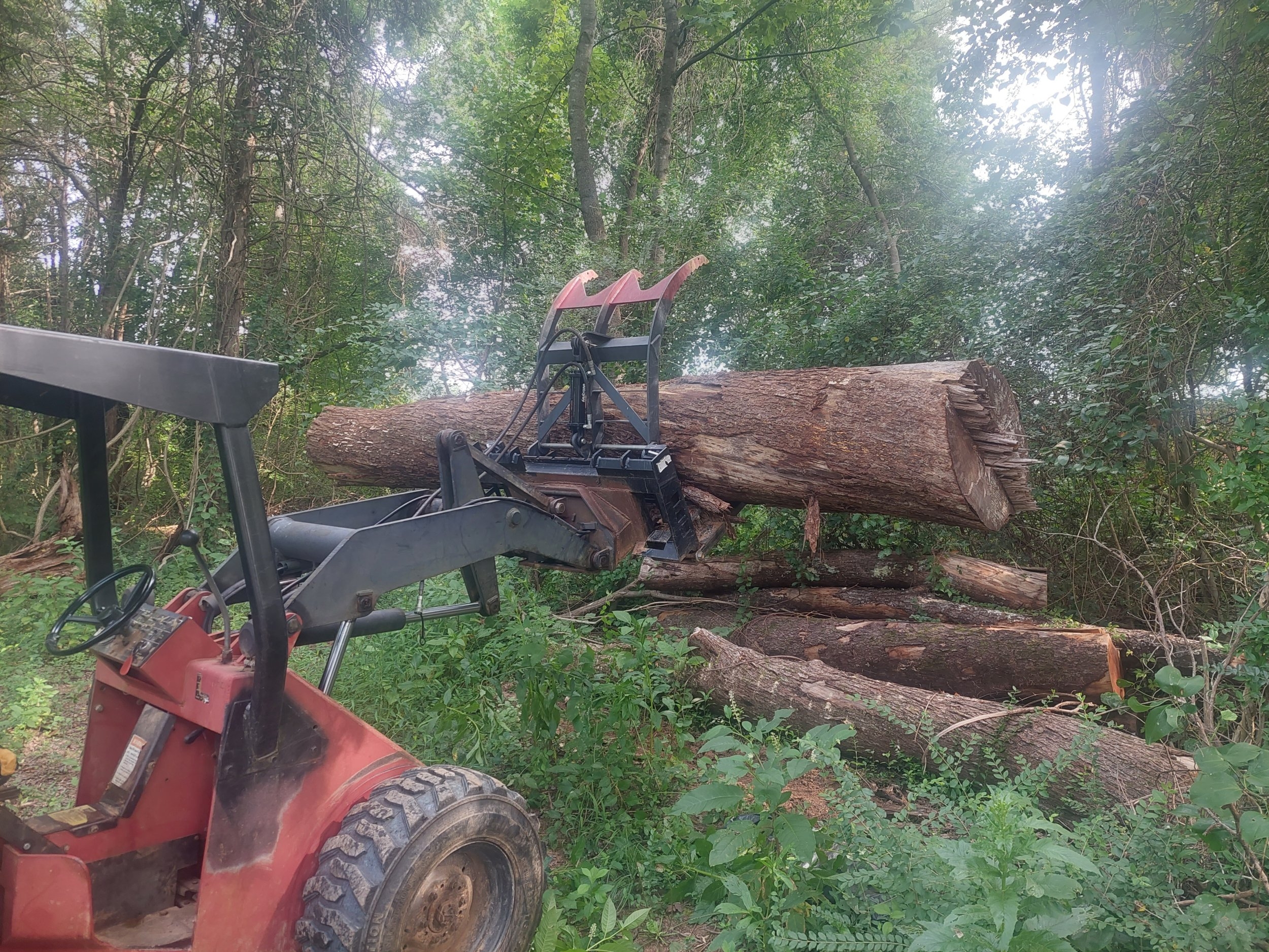

Its your lucky day porkchop!
I have the day off and I am starting my deck build project.
Real world results from a 15 year old machine (PT1460).
First photo is a log I cut to make room for my orchard area (14 feet long and 25 inch in diameter)
Second photo is an actual weighted test. I needed 40-60 pound bags of concrete for my deck posts. (2,400 pounds plus the pallet). Back end is feeling light with this pallet and I could not lift it any higher.
I am very happy with this machine as a loader and a lifter!
It is 6ft 8inches to the top of the ROPS.

And thanks for the pics PowerTracManiac. That's exactly the kind of stuff I was hoping to see. That pallet demo is pretty impressive, especially factoring in the weight of the forks and grapple too like MossRoad pointed out. I got a chuckle out of the fact that the 1460 is actually 3 inches shorter than my BX with the ROPS up. Being able to roll a brute like that through a regular size garage door is nice. It's kind of a shame that Power Trac hasn't done more to promote their product over the years. I think they could have sold a ton more of them.

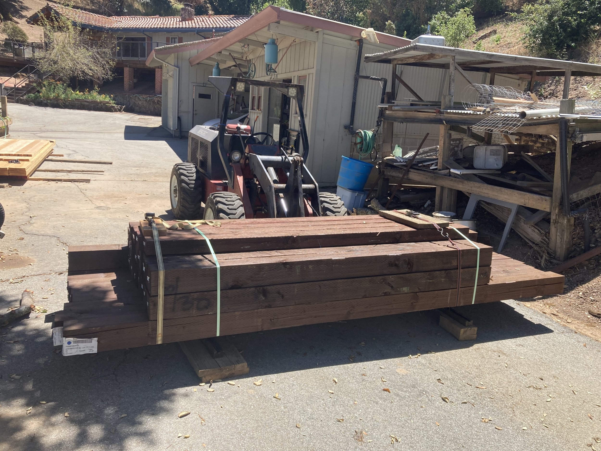

Attached below is a 1445 lifting a stack of pressure treated, carefully. Those are pressure treated 12' and 8' 6x6s, and a few 4x6-8' tossed on top, fresh from the mill, and pretty wet. (Because the center of mass on a Power-Trac moves forward as the tractor turns/articulates, what the tractor can lift bent 45 degrees is less than it can lift going straight in, and vice versa, often leading a rear wheel lift or two, if one turns sharply with a heavy load out front. I move very slowly and carefully with heavy loads to make sure that any "oopsies" will be the bucket or forks dropping a couple of inches at low speed. You will get the hang of it quickly.)
I find my 1445 invaluable and have accomplished many projects easily and very short amounts of time thanks to it.

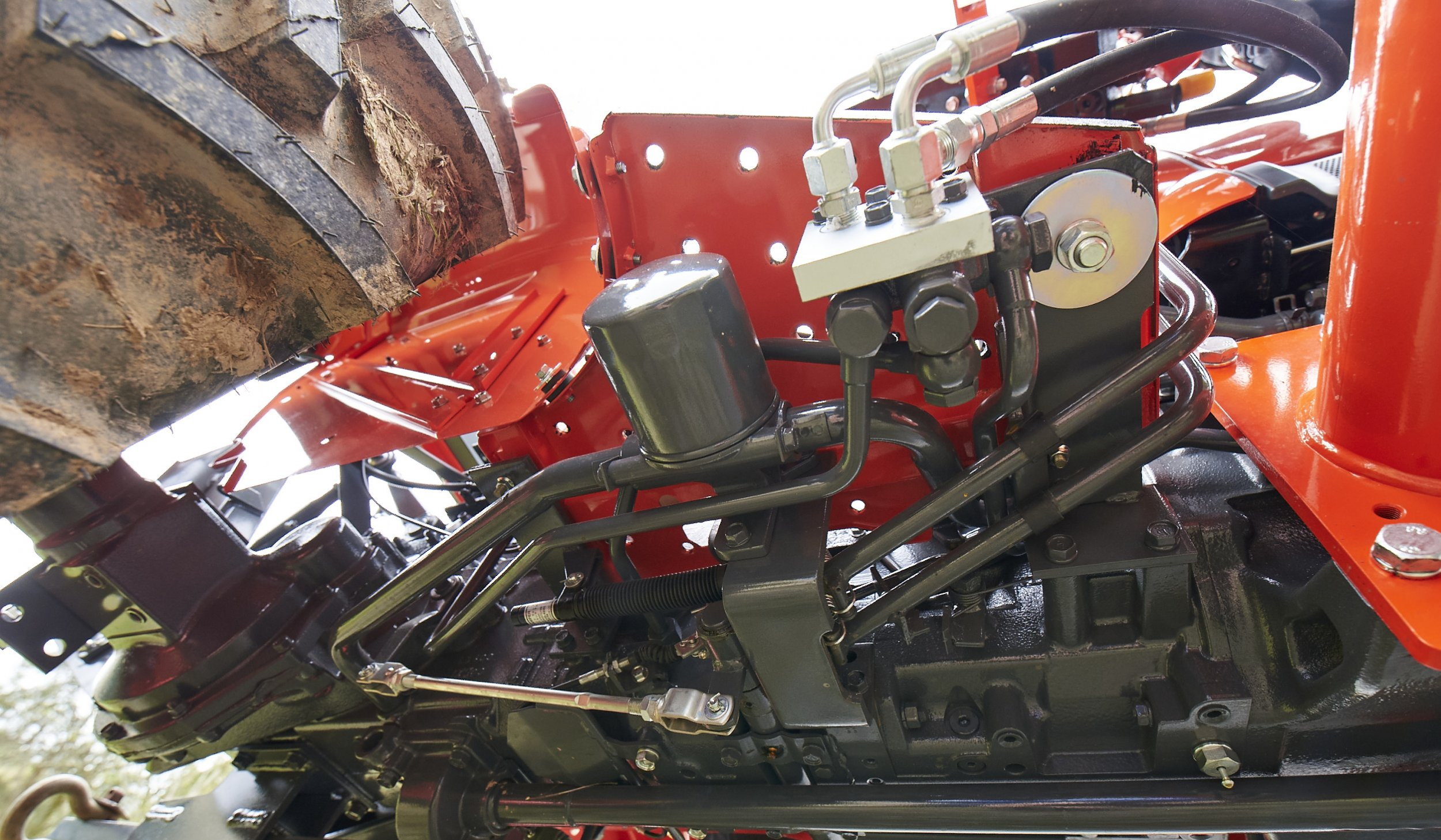

I don't have a picture of the MX5200 I recently bought to post at the moment, but in my personal opinion, the hydraulic filter on the MX5200 is mounted under the operator platform similar to my L2501 like the photo I'm attaching.
Besides the matter of ground clearance, you may want to take a closer look at where the hydraulic lines and filters are positioned on the MX5400 if you are thinking about buying one to use in the woods.
