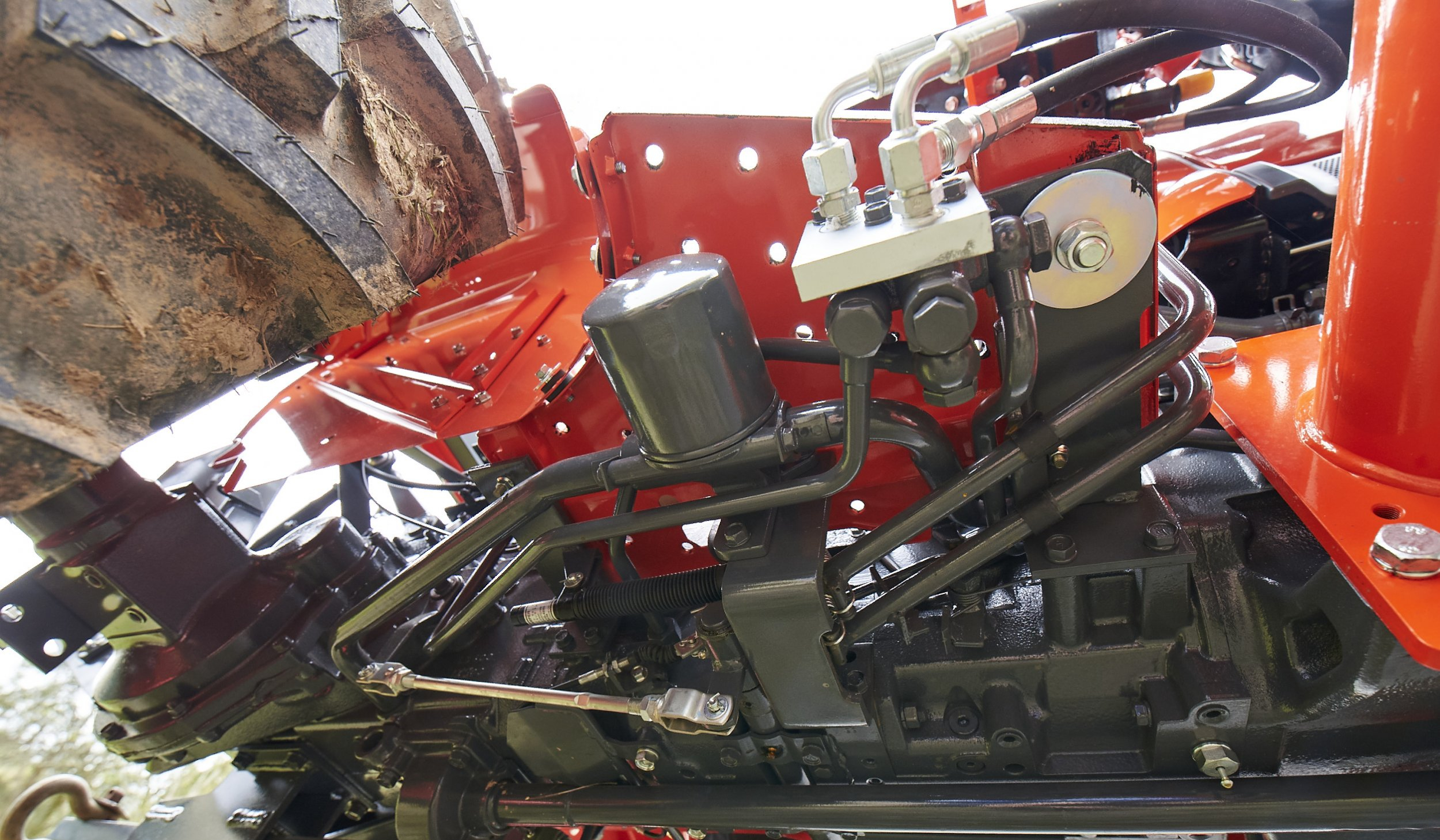

I don't have a picture of the MX5200 I recently bought to post at the moment, but in my personal opinion, the hydraulic filter on the MX5200 is mounted under the operator platform similar to my L2501 like the photo I'm attaching.
Besides the matter of ground clearance, you may want to take a closer look at where the hydraulic lines and filters are positioned on the MX5400 if you are thinking about buying one to use in the woods.
