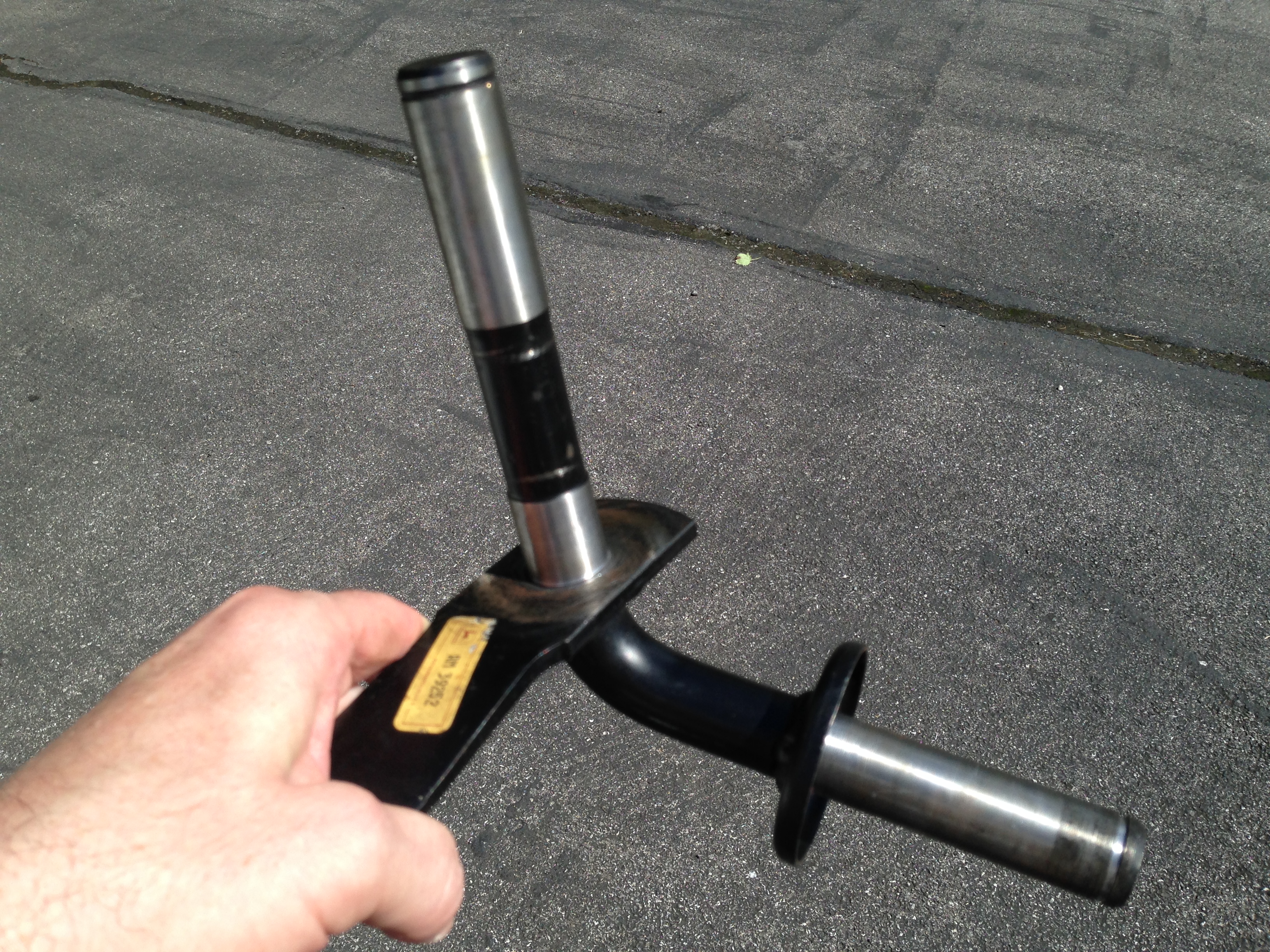

What was your final outcome? I am in a simular situation right now. I had my steering spindle break right at the same spot back in June. All I could find were used spindles on eBay. I bought a set and they lasted less than 10 hours of mowing. The same one broke again in the exact same spot. I do not understand why this is a weak point or what to do to make it stronger? I am a professional welder and could properly weld the spindle; however, I do not trust the structural integrity of the metal to keep from shearing again. Any ideas?

I guess I forgot to post about my final outcome. Our local John Deere dealer happen to have a spindle in stock. It was in the back in a cardboard box full of various parts. The spindle was the wrong diameter by a total of about 0.015 of an inch. I took the spindle to a machine shop to see if the fellow thought he could take the extra stock off. He had the part for about five days before he figured out a way to mount the spindle on a lathe to get the extra stock off of the end (that the wheel attaches to). It worked and I installed the new spindle in the tractor, but I didn't replace any bearings or bushings. The spindle seems fine so far.
Geez! Really? That stinks.
This is what I suggest you try darrollr if the cost is not too high - which only you can determine. If you can not find a John Deere dealer that (just) might have one of these in stock - have one made. I say this because after talking on the phone to people at three or four local machine shops one gentleman stated that he may be able to fabricate one. He said (and it makes sense) that it would be much easier to machine a straight piece of metal stock then heat it and bend it into shape - than try to lathe a piece of metal that is already bent into shape. Of course the shop has to have all of the equipment (or have access to all of the equipment) to be able to machine it, bend it, heat treat it quench it, or whatever else may be required. When talking to the head of the parts department at out local JD dealership (while looking for bearings to fit) he could bring up very detailed drawings of individual parts with all of the dimensions listed (basically like a blueprint). Maybe you could have someone look up a blueprint of that part and print it out for you. You could then give it to a machinist, so he would have all of the correct dimensions for grooves, angles, metal type, diameters, etc. to make a new part and give you a rough cost to make it.
The machine shop that I actually went to had changed hands (ownership), but the fellow working there (the current owner) had been working there for years. In the they past had built an axel from scratch for an older larger (for farm use?) model John Deere tractor that parts were no longer available for. A JD service guy told me they had used that particular shop quite a few times (in the past) to make parts that were no longer available for other machines. So you may want to check into having a machine shop make you a spindle from scratch as an option. It can't hurt to check it out at least. The cost to get a new part built may not be too terribly expensive. Give it a try.
I don't know either. Of course I know very little about welding.

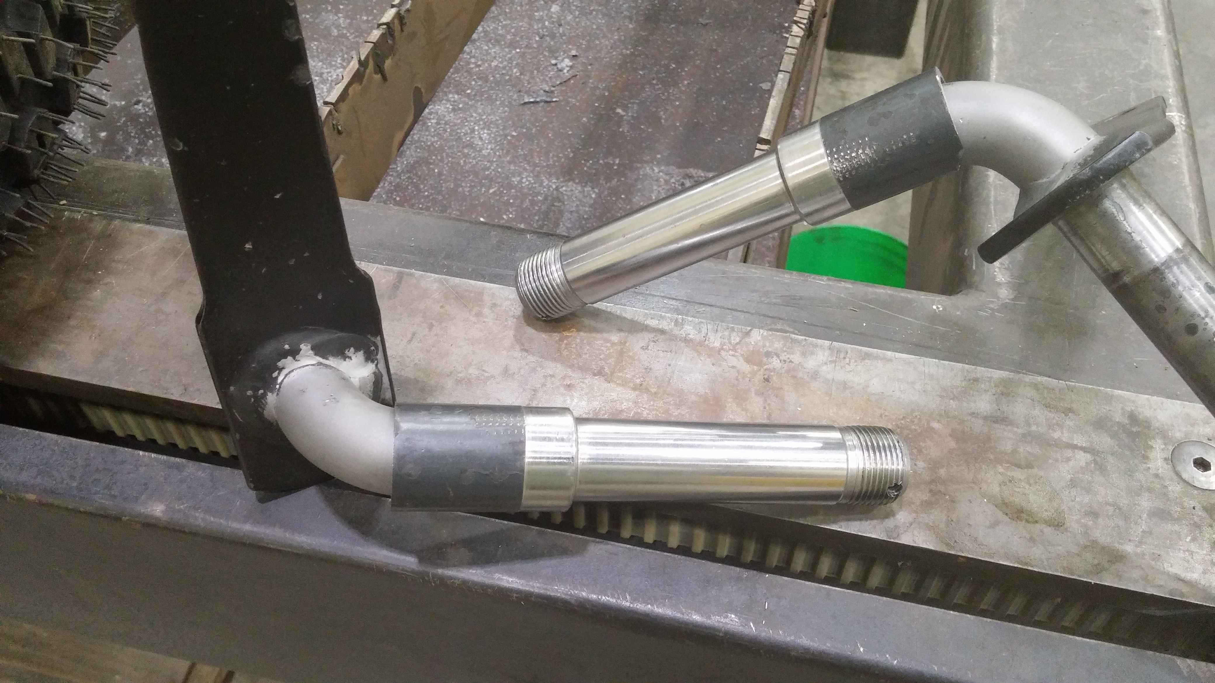

I am going to try and weld this broken one to get me through the rest of this season. However, I found another forum thread that talks about building new spindles all together so I am planning on going that route.
That is cool darrollr. I did not even think about doing a search for building a spindle. Good luck with your tractor, and thanks for the information kind sir. :)
