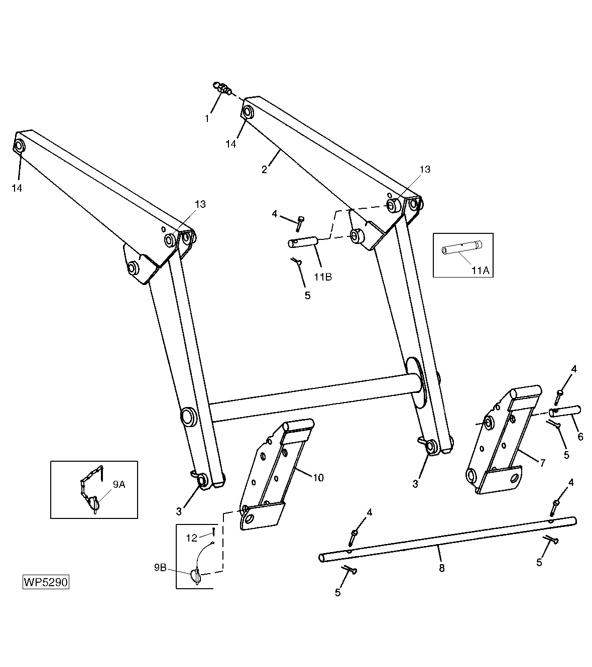

What is causing them to break? Where are they breaking? Can you post a picture?
The original holders where made from plates welded together like this picture, and that is what JDParts shows for the part numbers you gave:
7 AW28607 Holder
10 AW28606 Holder
The first gen "cast" holders (made in China) as I recall showed up on the 300/400 X/CX loaders did have some breaking issues around the holes, but where quickly updated with extra webbing to correct that issue and I haven't heard of any breaking in many years.

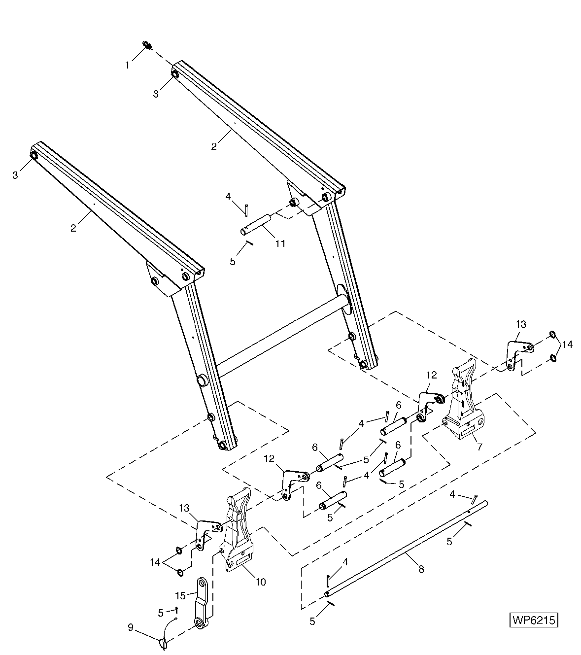

I can only suggest getting the new updated parts and start fresh. If pulling from hooks on top of the bucket, then the bottom of the bucket should be forced against the cast parts and the pressure well distributed. If you are back-dragging or somehow pulling low then you can "pull" the bucket away from the cast parts and then there is huge forces place on the pin and where the pins touch.
7 W47351 Holder LH
10 W47350 Holder RH
Here are two threads I found for you that address these 1st gen holders, unfortunately some pics are missing since the post's are so old:
