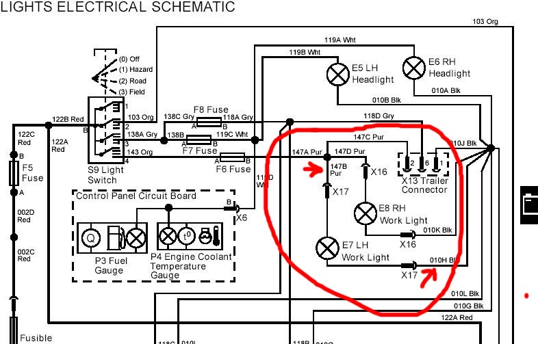

Anyone have electrical schematic of the lighting circuit on a 4300? I see mine already has a fuse for a work light, and I'm wanting to tie into existing lighting circuit to add rear work lights. I think I just need to find where the wiring stops and add from there.
Thanks,
Ben
/ 4300 Lighting Schematic #2
That pair of wires and I believe a connector is under the seat on the left side. Folded back and taped together if I recall correctly. Look for a purple wire. Here is schematic for the 4300.
