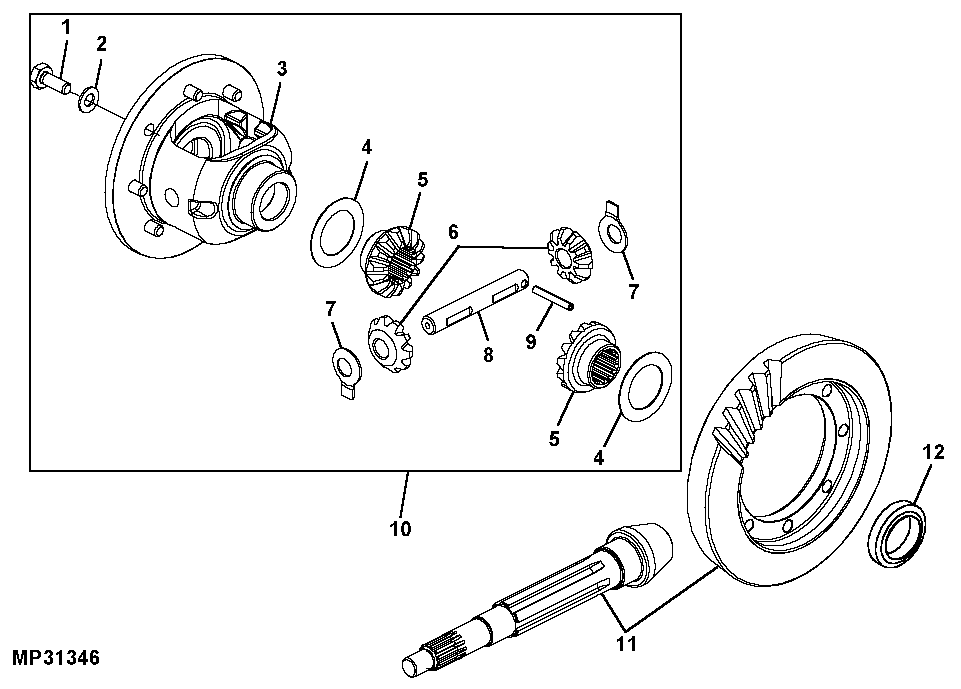

I am looking for some feedback on a potential issue. A few months back, I had a bearing fail on the left rear of my 4300, the bearing broke apart and was pushed thru the casing. A chunk of money and time later I got it back together and running. While I had the left rear off, I did everything I could to see if the right side was still solid. There was no play at all.
I was out using it for the first time today; a little paranoid of course. Well everything seemed fine, except I hear an occasional ticking in the right rear if it's slipping and the left isnt moving. Just driving normal or with the diff locked, no noise. I don't remember if it did this before, since I never thought anything of it. It increases with speed, FYI. Anyway, now I am thinking about it!

Are rear wheel bolts tight?
Noise possibly could be the spider gears or shaft(parts key #8) in differential. Has tractor ever been run real low on trans/hyd oil??

The rear bolts are tight. It's been run pretty low on fluid before when we had an unnoticed leak. It was Even pulled home about a half mile with no fluid after the left side rear blew out. It sounds like it comes from the right center or right side (somewhere between the diff and big bull gear)
/ 4300 rear end #8
IMHO pulling it 1/2 mile without hyd oil in it was looking for disaster. I would have hauled it instead of pulling it even I had to hire a roll-back truck. I'll bet you click is in the differential spider gears.

Well, it's taken a while with my schedule, but one tooth was broken off a spyder gear, part #YZ80998. Should be ordering it this week.

Well, I put the tractor rear end up on some jack stands for about 3 months while I was too busy for it. I took the RH rear drive off, ordered new bearings for it just because I had it off (if you buy them not thru Deere it's about $50 for all 3). I noticed a metal piece sitting in the bottom of the center section after the fluid was all drained. The piece "looked" like it would go to a spyder gear based on the size/shape.
The RH rear drive is sitting in the garage ready to be taken apart and reassembled. Fast forward to April...
I had my oldest son a couple weeks ago remove the top portion of the rear end so we could get closer for inspection of gears. After turning the drive shafts, sure enough, we found the broken spyder gear. It's the one that is on the RH side.
Parts are ordered, should be here today. If I have the time to get to it this weekend, that would be awesome, plus I'd be amazed! I would guesstimate I need 4-8 hours to finish it all up, since I still need to disassemble the locking diff, brakes, spyder gear assembly and the RH drive...then reassemble.

It's alive! My neighbor came over Saturday night and worked with my son to get it done; about 16 man-hours later it's all set. Now to rack some hours up...
