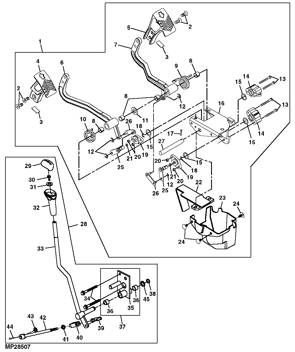

the pedals actuate potentiometers which send a signal to the computer that sends a signal to the hydrolic drive pump to increase or decrease the flow of oil
The cruise control is part of the computer, there is no direct mechanical linkage
But increasing or decreasing the flow of oil requires rotating the swash
plate on the HST pump. That is done mechanically by the pedals. The
cruise control uses some method of locking the swash plate in place. The
question is what is the locking mechanism and how is it specifically controlled.
   / 4310 cruise control #12
Not on the e (electronic) Hydrostatic models. The only thing hooks to the pedals is a potentiometer. Part number 14 is the "sensor"

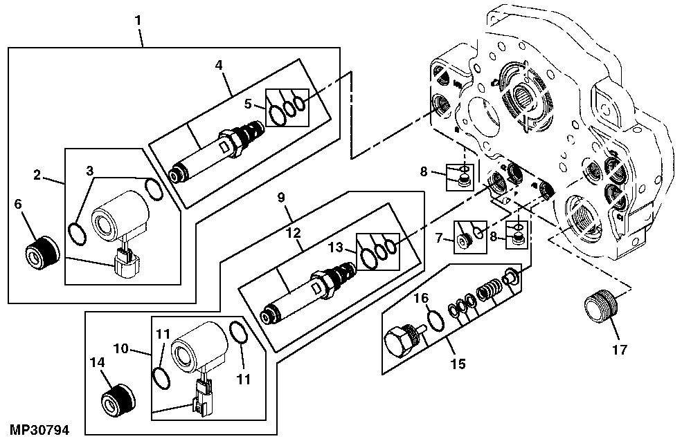

OK, so there is something that turns the swash plate. It would be interesting
if it was something like a stepper motor. How do they do it?
This?
   / 4310 cruise control #16
Yeah, I just looked it up, too. They use proportional solenoid spool
valves. That leads me to believe that the HST pump is fixed displacement.
There are no pix of that side of the HST in the parts document.
