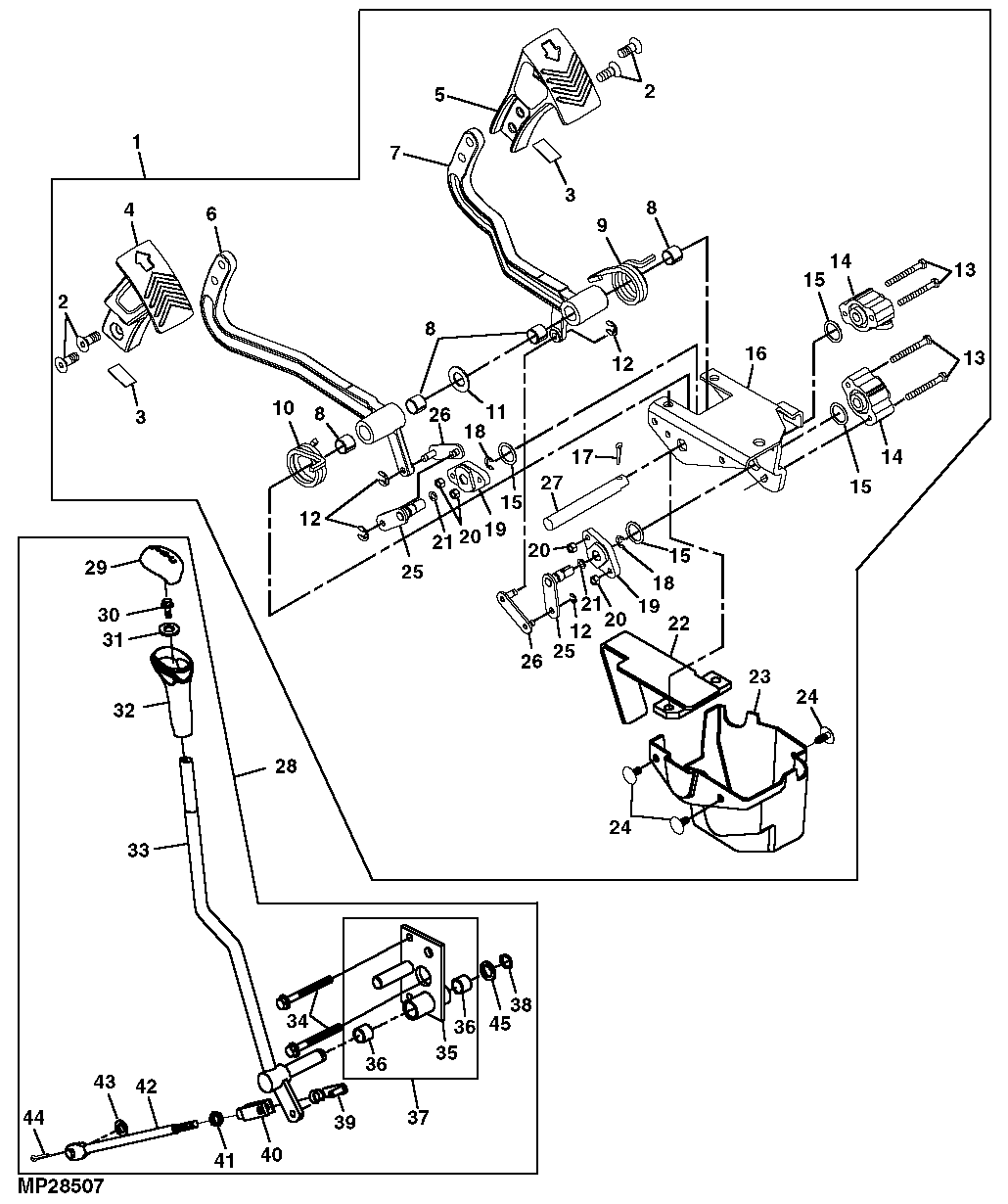

Not on the e (electronic) Hydrostatic models. The only thing hooks to the pedals is a potentiometer. Part number 14 is the "sensor"
OK, so there is something that turns the swash plate. It would be interesting
if it was something like a stepper motor. How do they do it?
This?
/ 4310 cruise control #16
Yeah, I just looked it up, too. They use proportional solenoid spool
valves. That leads me to believe that the HST pump is fixed displacement.
There are no pix of that side of the HST in the parts document.
