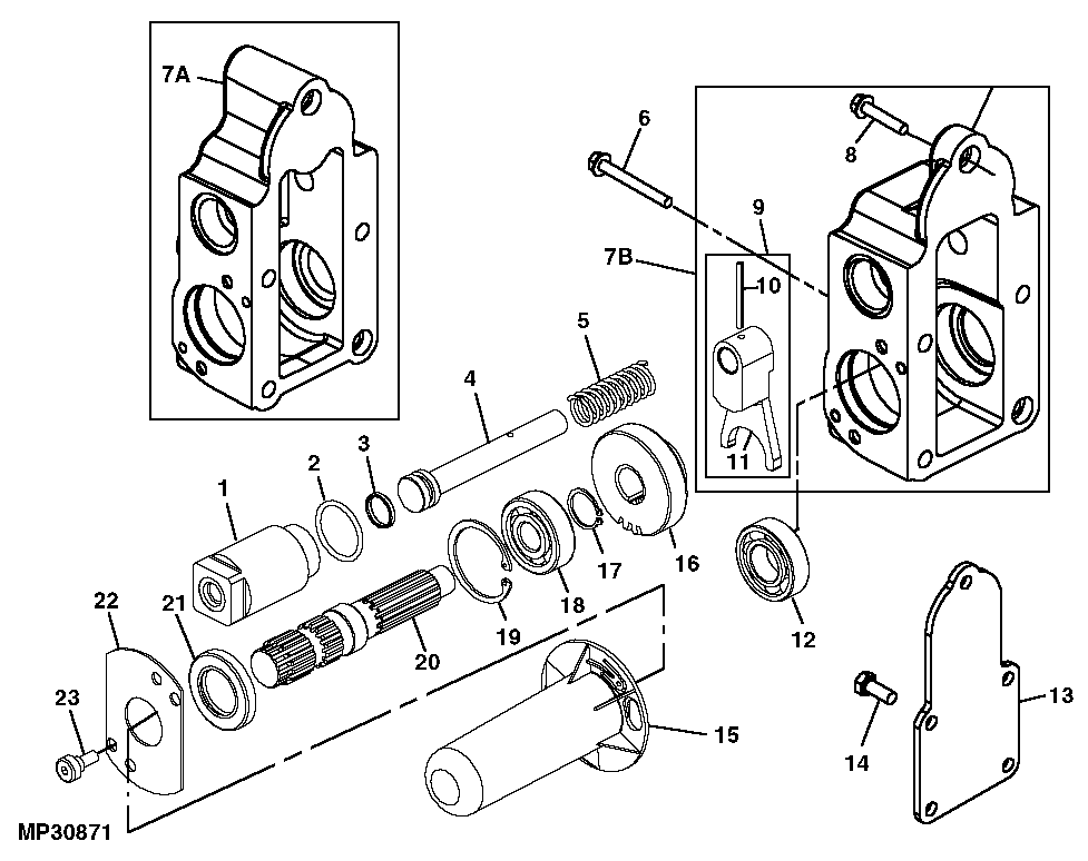

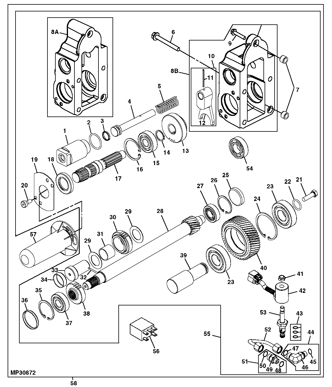

I need to retract this statement a little. I was going by memory and thinking it was the same setup as the 4x00 series that uses no electrics for the mid-PTO. It seams that the 4x10's uses a much more complicated system to engage the mid-PTO. It appears it is electro-hydraulicly activated. It looks like the place to start is checking voltage at the solenoid valve (#42). It may also be corroded/seized since you have not used it at all in 800 hours. This might be a good time to get a service manual;)

As kennyd pointed out, the solonoid has a connector (2 wires) running to it, and on my 4300 I ripped off those wires while using the tractor in the woods. So my mid pto doesn't work, but everything else works just fine (will screach when wrong order attempted).
Might be a good place to look.
And in lieu of a service manual, take a look at your mid pto on jdparts (see the schematics and parts list such as kennyd posted. You will be able to see the wiring harness etc. there as well.

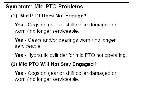

To add to JD755's post, here is a pic of the mid pto on the 4310 that shows the solenoid, and the brief trouble-shooting guide (from the tech manual).
