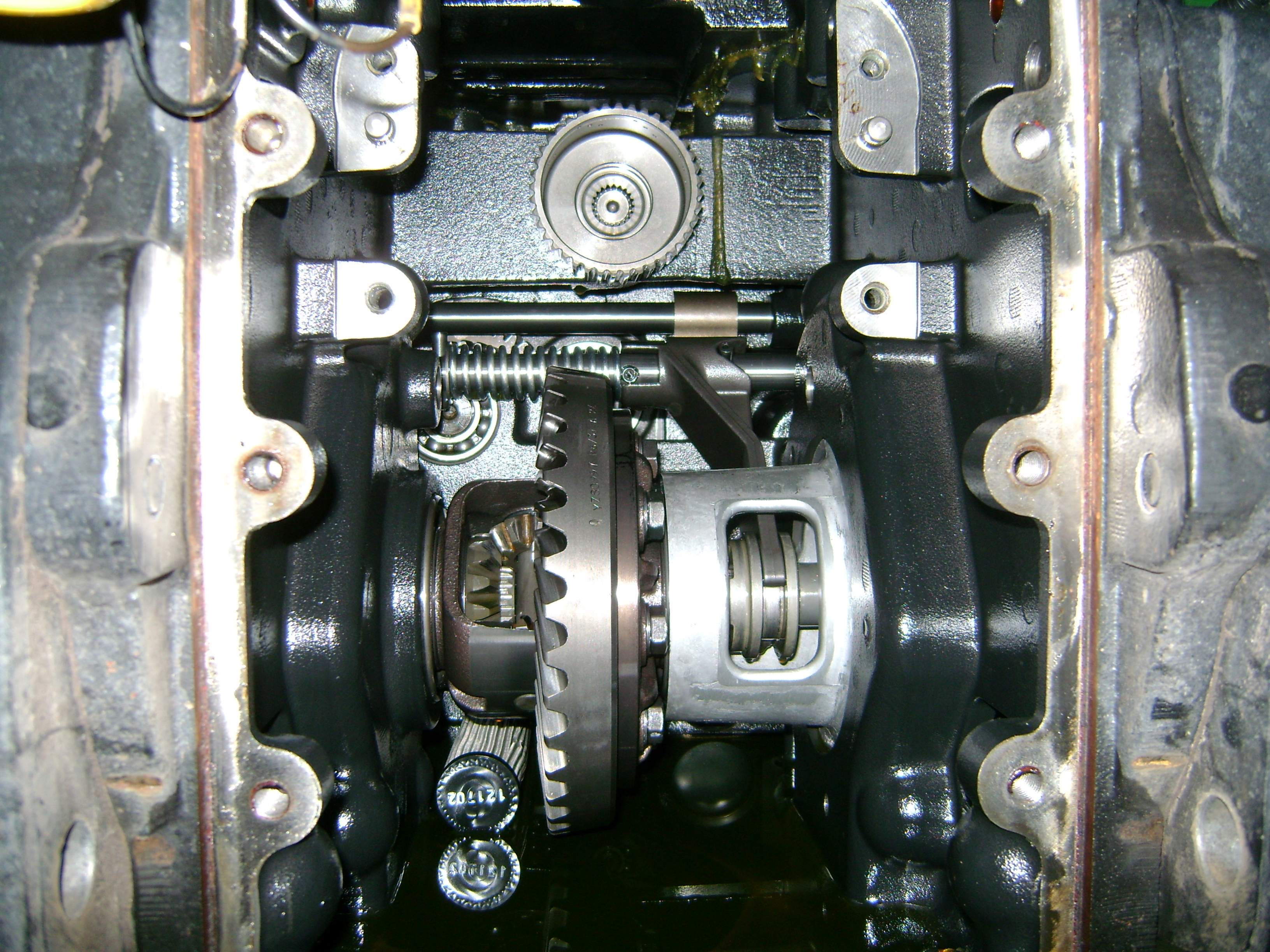

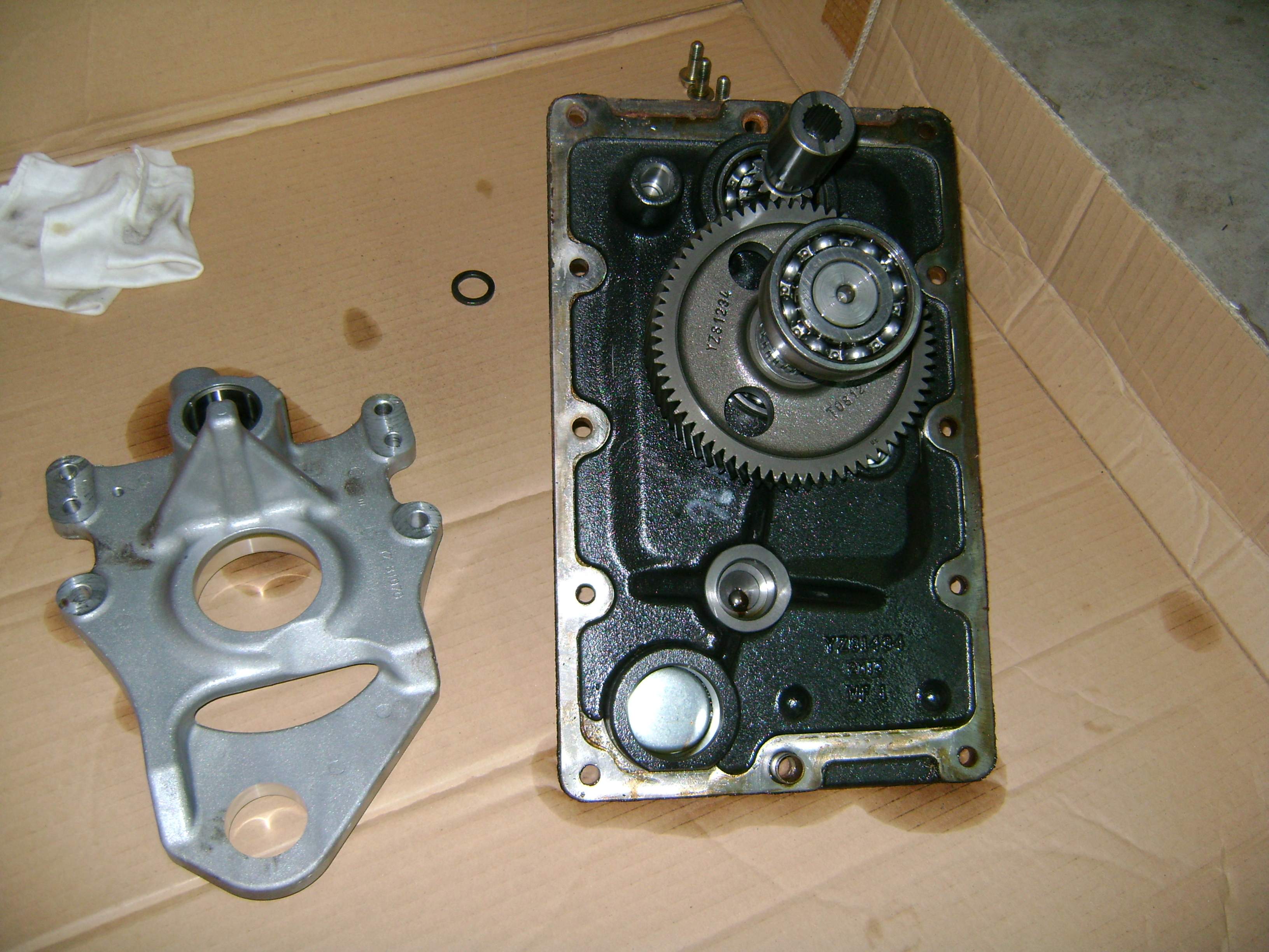

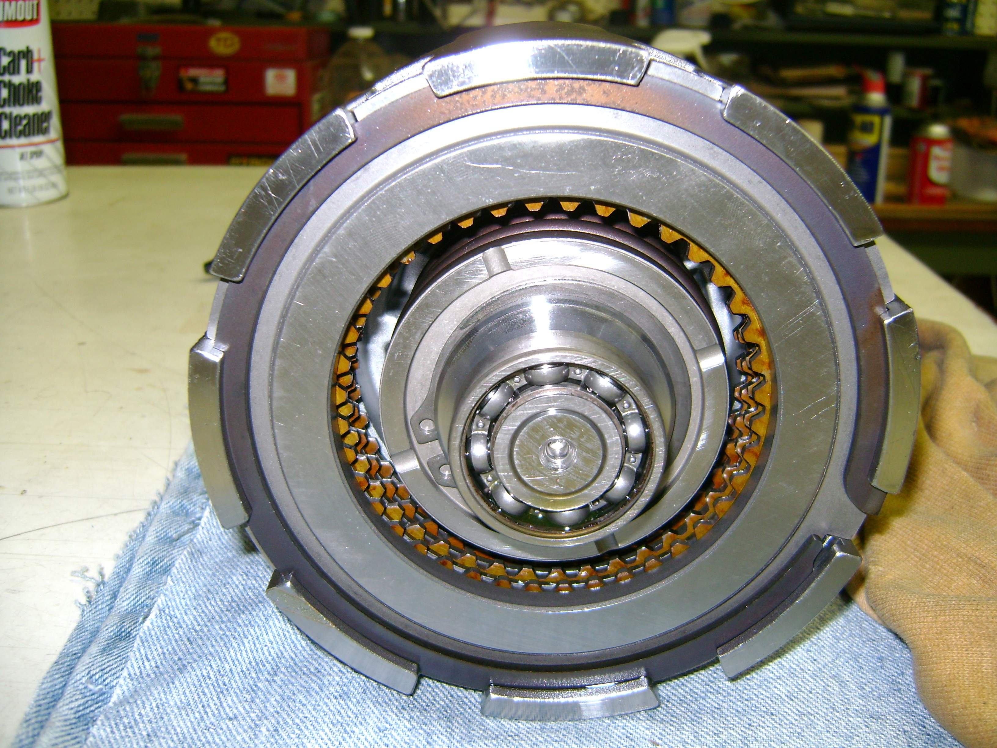

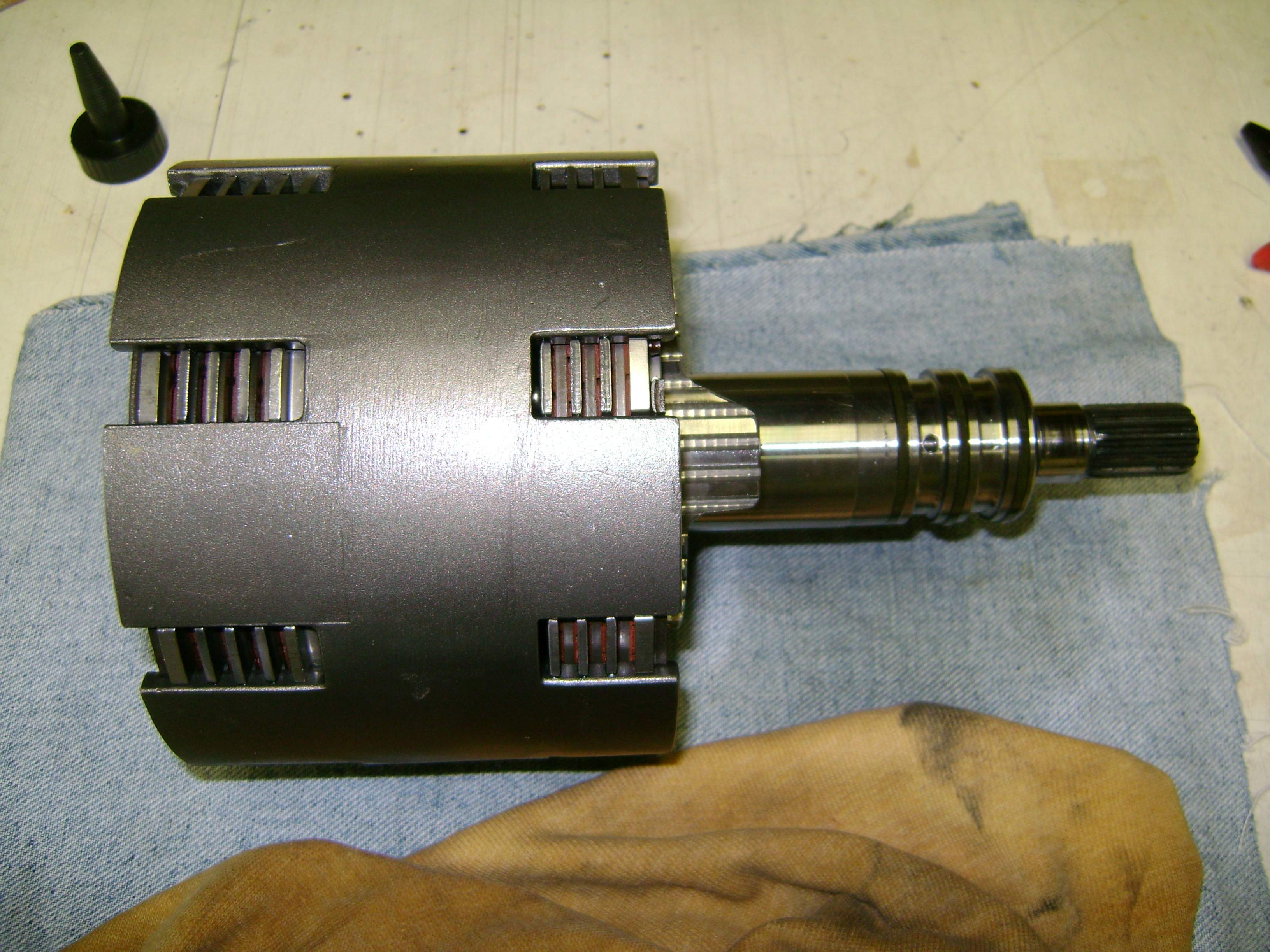

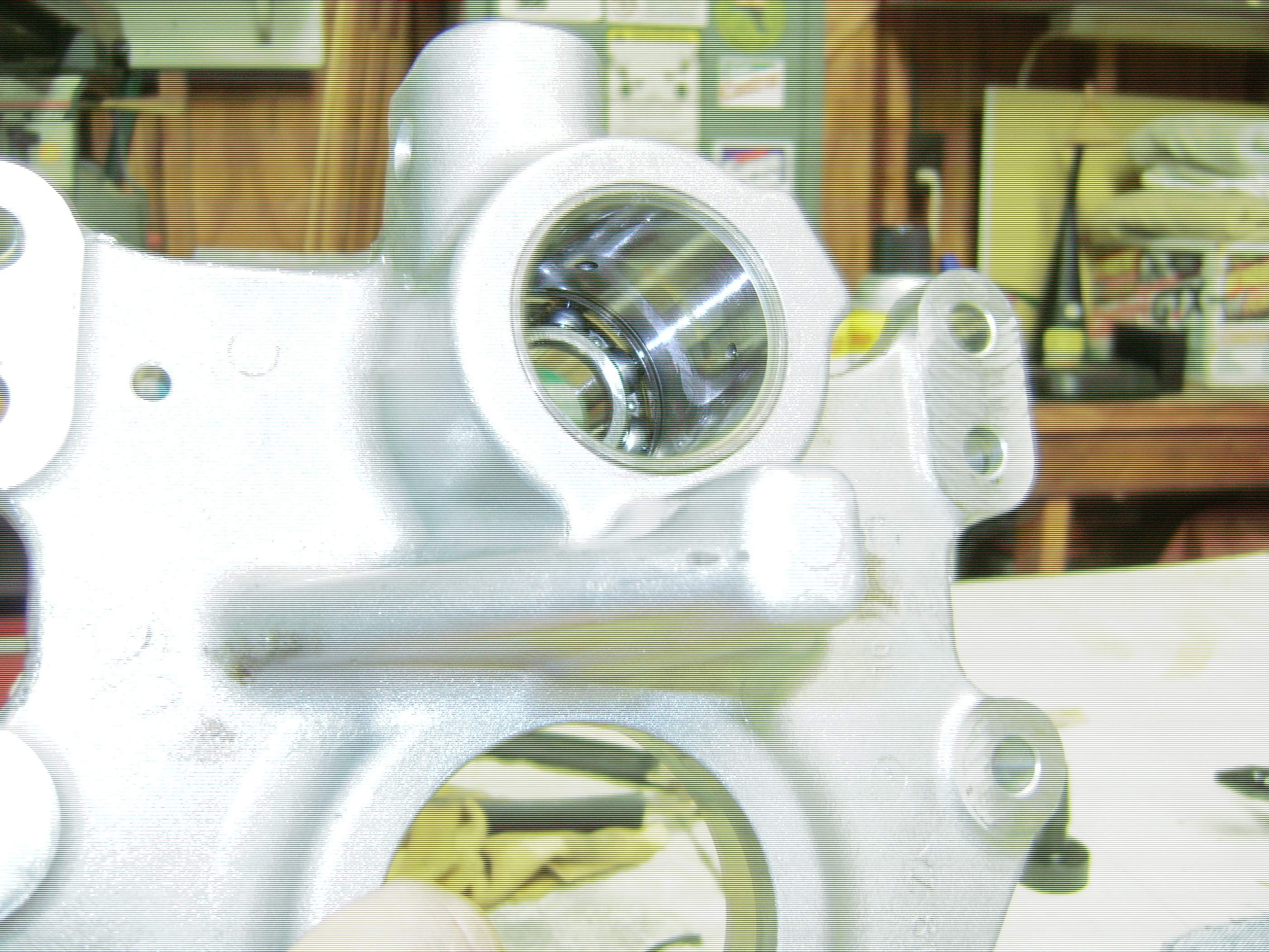

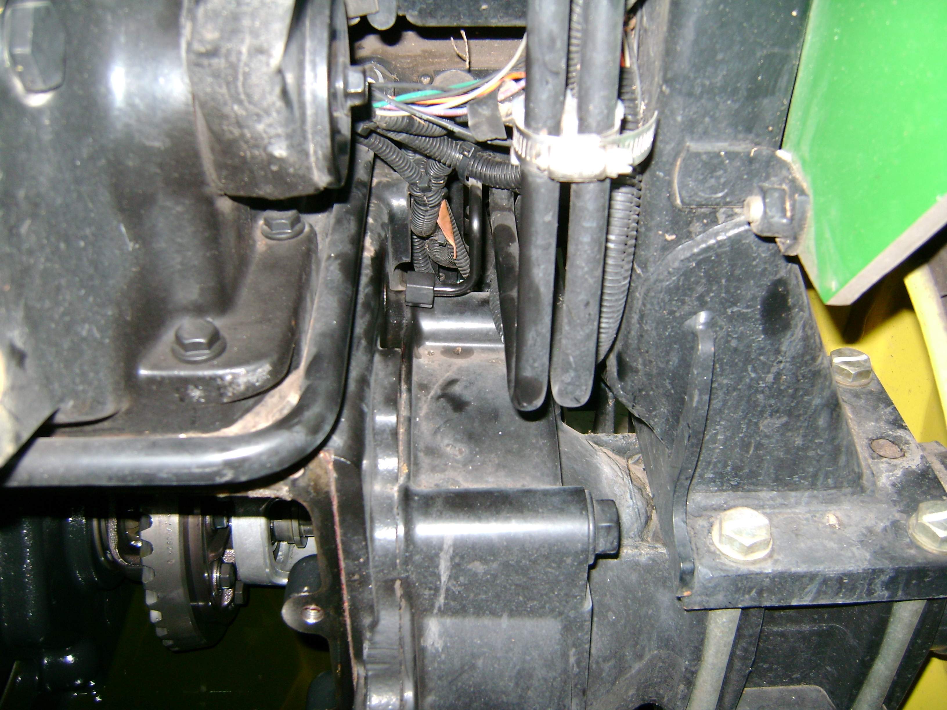

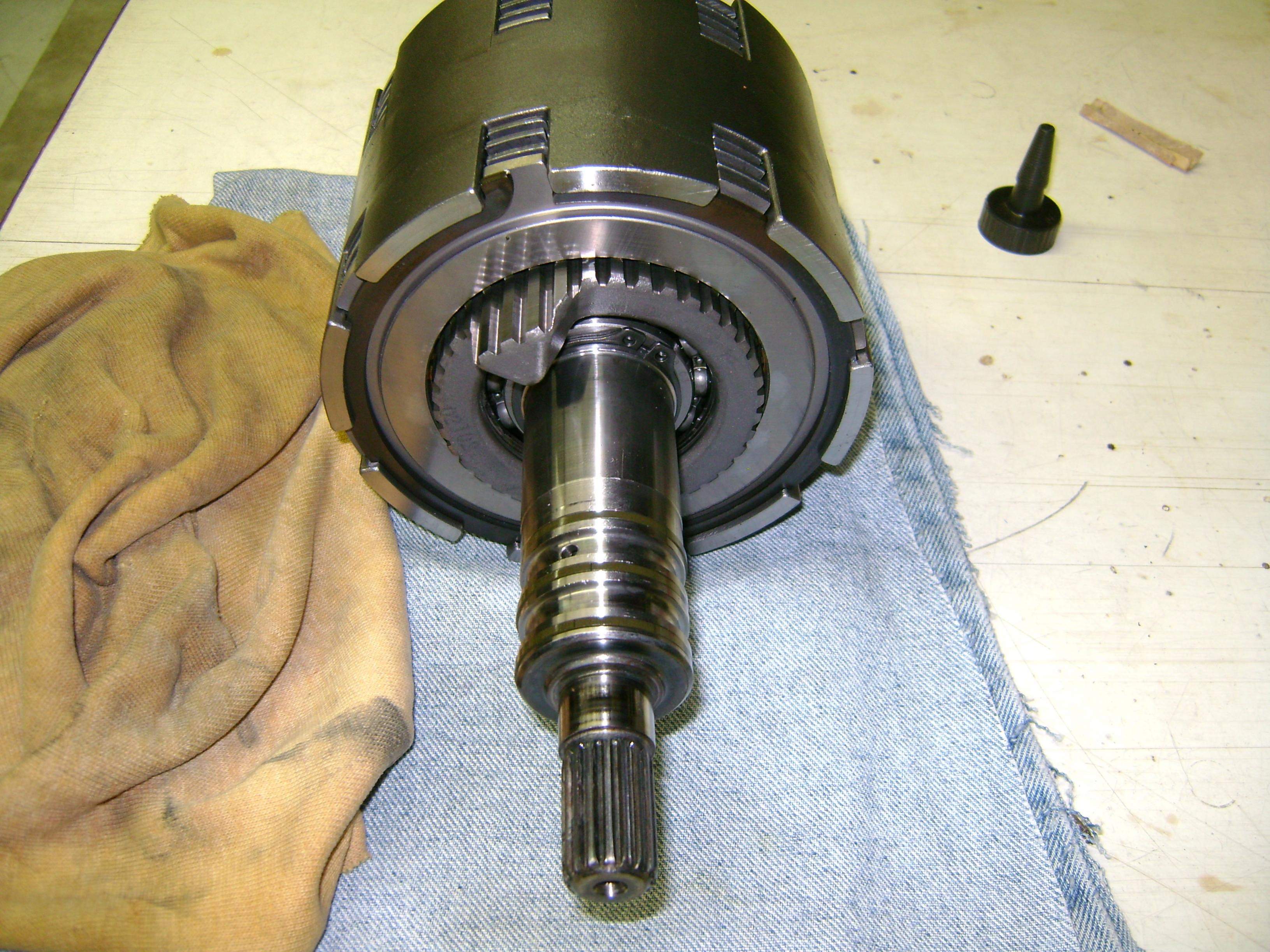

Well, I think I found my problem. The sleeve that they clutch rides in was somehow rotated out of alignment. It being misaligned means that even though I had pressure, none of that pressure ever made its way to the clutch to engage it. I was able to press it out and press it back in tonight. I will try to get it put back together this weekend. I will keep everyone posted.
Here are some pics of my machine apart.
1. Brake side of the PTO Clutch unit.
2. The entire PTO Clutch unit. It is bigger than it seems.
3. Clutch side of the PTO Clutch
4. The backside of the PTO rear plate with the bearing plate to the left.
5. My machine all opened up. dfkrug - note the rock shaft not removed. I will let you know how easy it is when I get it back together.
6. The hydraulic port the provides the pressure for the PTO clutch
7. This picture tries to show the holes misaligned

   / 4310 Rear PTO problems #27
Yeah that sure is different. The shaft of your PTO clutch is the spool of
a spool valve, which does the shifting for you. No shifter fork to get in the
way, like on the 4300.
I can see part of you diff lock... it is the same as mine. Can you see how
warn the diff side of the lock is?
(Your pix are hard to see....you need to reduce the size.)
