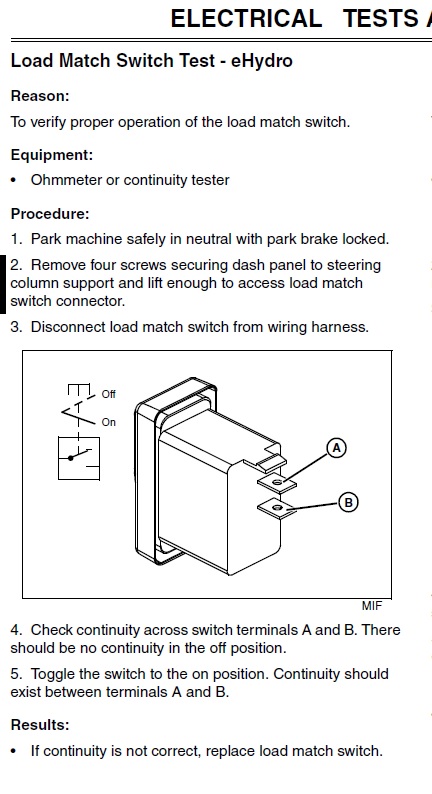

Do you have access to the service tech manual for the 4310?
Here is the test shown in the service tech manual for the load match switch. JD part # LCA11189 about $20 ??

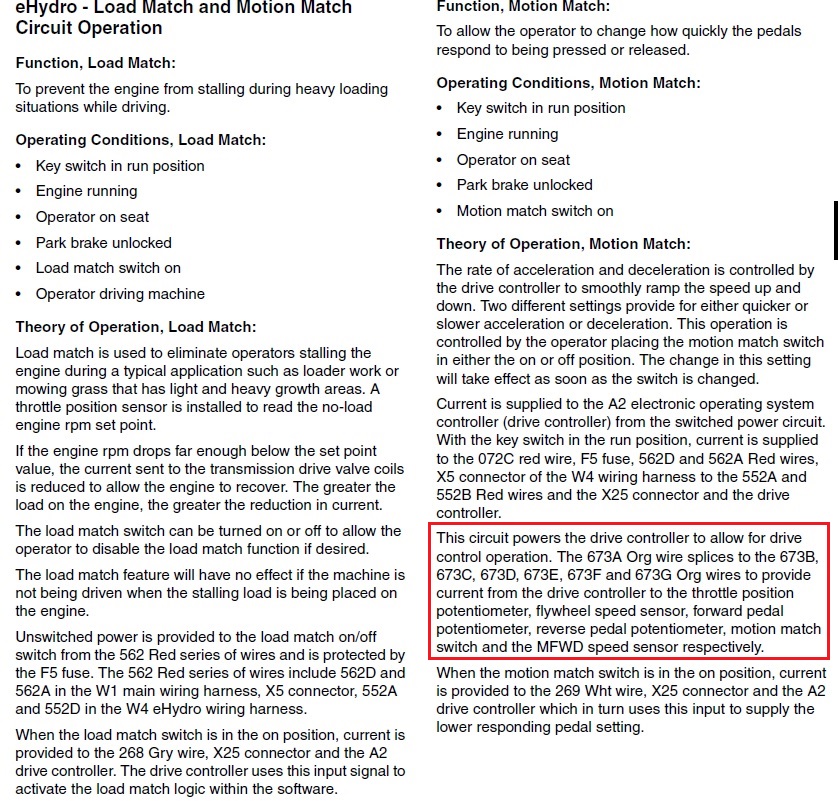

Seems you can follow the different tests in the tech manual for the 4310 and track it down. Here is a shot of the manual about the theory of the eHydro.
/ 4310 - Sluggish when moving
#9
I just finished reading that page in my tech manual . . . I will have to figure out why my LoadMatch switch is not working correctly. Thanks for taking the time . . . very much appreciated!
