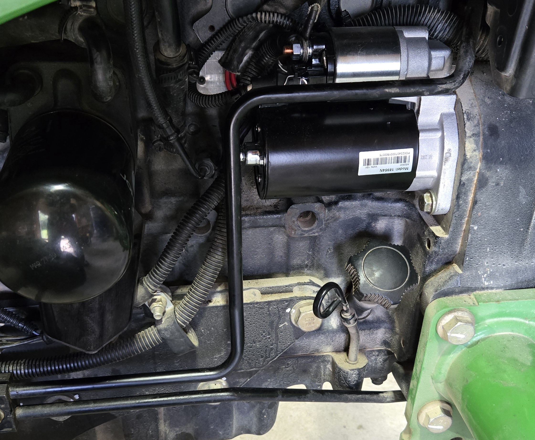

Anyone have a snapshot from the service manual of the removal of the starter on a 4320 compact tractor?
Should be easy but the second bolt is dicey.

To get at the back bolt, I used an extension on a 3/8 drive socket ratchet. I think I may have stacked (2) shorter ones together to give me enough length to swing the ratchet from the back of the starter. Changing that starter took me between 15 and 20 minutes and I think the new one cost less than $ 150 from Amazon.
Your wiring harness is in this side of the starter. Mine is jammed behind it and it isn't moving.
Damn, they must have assembled that one on a Monday morning after their football team lost on Sunday.

Success, I got it out. Had to cut a few zip ties to loosen the wiring harness enough to get the socket on.
/ 4320 Compact starter.
#11
fits like a glove and really feels more powerful.
