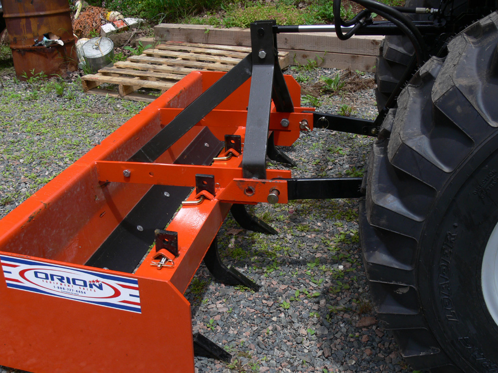

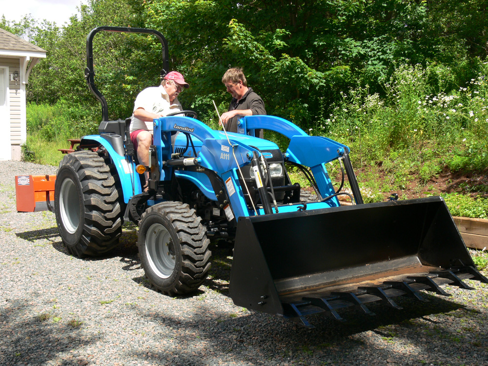

I don't think you'll have any difficulties pulling that with your 44 hp tractor. My 41 hp tractor pulls a 6' box blade with scarifiers down (looks like your unit but with the box and blades added!) quite easily.

Sure seems to me that a heavy box blade with scarifiers would be a more versatile tool for the projects you have described in your other posts. The Landpride unit would cut deeper but if your clay is like mine you will just be spinning your wheels with 6 scarifiers set deep. Hope your planning on having the tires ballasted ,loaded, on that new tractor. The L4400 isn't that heavy in the big picture of things and for deep ground engaging weight is your friend.

Why would you get a scarifier instead of a box blade? You get essentially the same scarifier function with a box blade but have the option of tilting the box down to level or move dirt after you "scarify" it. Box blades are pretty versatile tools.

Id look into a box blade,may get more bang for your buck.You can easily pull that with a 44hp tractor.
