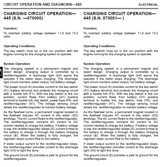

Here is the operation description of the charge circuit:

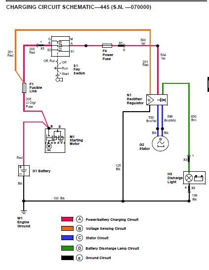

And here is the Schematic:

BBO - If you are measuring 14.4 V with engine at fast idle, that would be the correct voltage out of the regulator.
I suspect that, even though the output voltage is correct, that the voltage sensing part of the regulator is faulty. Have you removed the regulator connector and checked for good connection of the connector contacts?
