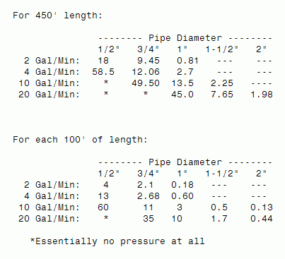

   / 450' water line #25
ToadHill said:
Any chance you could run a 1" line thru the existing line. It would give you extra protection from roots.
This could be feasible if his flow rate is low (say, less than 10 gallons per minute). But if the line is supplying a house, and someone's taking a shower when someone flushes the commode while the washing machine is filling up, there might be a problem. The drop in diameter from 1-1/2" down to 1" will obviously cut the available pressure. The loss of pressure due to friction in the pipe is determined by
  • the friction of the pipe
  • the diameter of the pipe
  • the rate of flow (gallons per minute or GPM)
  • the length of the pipe
One popular formula (Hazen-Williams) relating all of those uses a "carrying capacity" number called a C-factor. For a given diameter, the higher the number, the smoother the pipe. Both PE (poly) and PVC have the same C-factor. (the same carrying capacity).
Here are a couple of tables showing the approximate loss of pressure in pounds per square inch (psi) for several diameters of PVC or PE pipe at several flow rates on frank29's 450' length and also on a 100' length.
I read the values in the tables above from the graph in figure F103A of the Standard Plumbing Code. They don't take into account any additional pressure loss from elbows, tees or other fittings.
