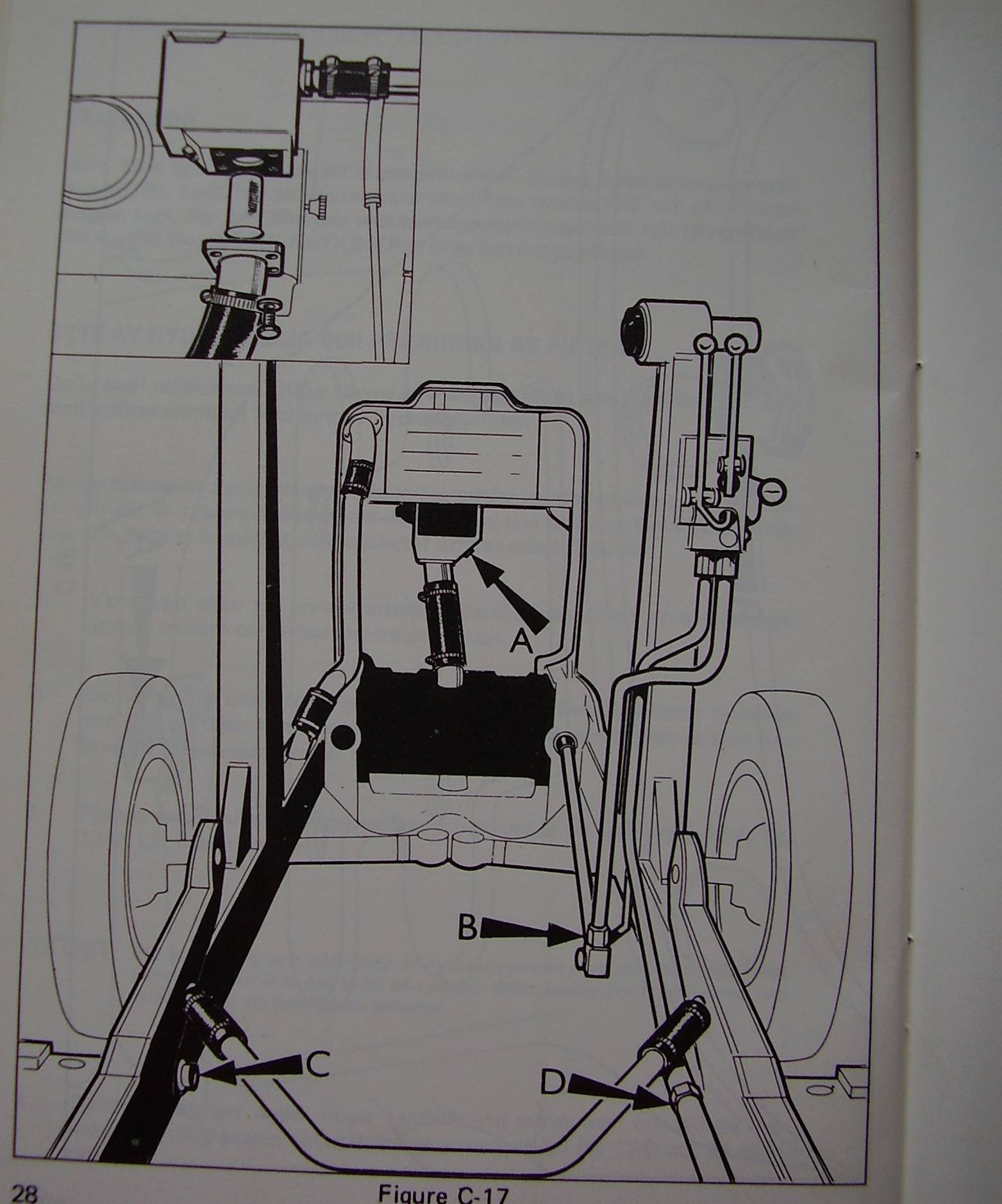

There is also a suction filter (Item #67 in the Messick's diagram), perhaps you already have cleaned it.
I have never serviced a 4500, as it turned out I have a Users Manual and took a picture of a figure that may be of use for you. Come back if you need information from the manual text. I think someone else on the forum is better to guide you, but the figure may assist.

I have to figure out exactly where that suction filter is. that thing HAS to be clogged with the crap i saw in the main filter. looks like it is in the supply piping to the pump. thanx , crossy
   / 4500 years of manufacture #27
Hakan's picture shows where it is, at the tank outlet to the pump.
