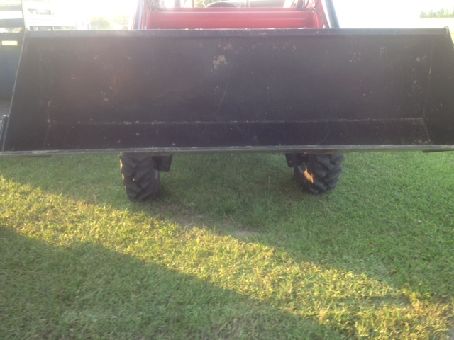

I've noticed that the bottom of my bucket is bowed, is any one else's like this? Should I weld another layer of steel under it?
/ 4530 bucket #2
Pretty common when the welded-in cutting edge gets worn...the only real solution is to cut out the old edge and weld in a new one. You can help prevent it from happening again by installing a replaceable, bolt on edge under it. Definitely an irritating problem when you can't scrape that last little bit of material in the center.

sorry it took a while, but here it is guys

I honestly cannot see much bow at all. At least not any that I could be overly concerned with.
I was expecting a big bow downward like you were trying to lift something large from only the bucket center,
/ 4530 bucket #9
So the bowed bottom is normal?
Sorry, that wasn't what I thought you meant. I thought you were asking if the buckets were made the same across tractor makes, to which I replied. As for being bowed, no, they're not supposed to be.

Bowed cutting edges can be caused by digging in hard dirt (clay) or by pushing a huge tree over with the middle of the cutting edge. Don't ask me how I know about the tree.
hugs, Brandi

A few methods....
1. you can try a bottle jack from the bow up to the top lip of the bucket. But that would likely bow the top. So you need a heavier piece of steel, like 4x4 tubing, or a i-beam across the top to spread out the load.
2. Another option is try to lift something un-movable with just the center of the bucket to force the bow back out.

Any ways to get the bow out ??
No there is not. The metal has stretched. I first bowed mine up on the tree and when I tried to straighten it out on the same tree, I just bowed it down, where it has been since. Manufacturers of tooth bars say they can not fit a tooth bar to fit a bent cutting edge. It just bothers me a little while backdragging and no other time.

My bucket bent down about a inch. Mahindra set me a new heavy duty bucket, all I had to do was pay the shipping. I got a tooth bar put on the new one.
