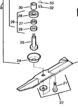

Does the PTO work with the deck driveshaft disconnected while sitting on the seat?
You can turn the driveshaft by hand I take it. Could it be something not part of the deck such as a safety switch?
It doesn't seem to me to be in the deck.

Compare the assembly diagram with how your blades are mounted. Also check the thickness of the new blades compared to the old ones. OEM JD blades are usually 1/4" thick. Many non-OEM blades are 3/16" and require spacer washers to get the blades to be tight. This could account for the bolt 455-48.JPGtightening issue.

Well, neither I nor the mechanic knows what is going on. I had the blades mounted upside down. He flipped them over, put it back on the tractor and hooked up the PTO. It started right up. The blades look the same in the mounting area - nothing raised on either side. I mowed 2 acres today with no issue.

Sounds like the upside down blades bogged it down

I don't understand how the blades being upside down did anything. It's basically flat bar stock. They turned backward just fine, but locked up turning forward.
