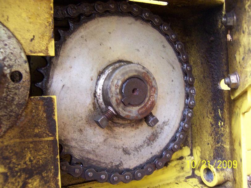

Should I be able to turn the auger by hand with the snow thrower not attached to the tractor?
I may be having a senior moment, but it seems like the drive train should spin. I can't see anything preventing it from turning. Chain looks good, no debri stuck anywhere.
Is something wrong with my snowthrower, or is it me?

hi wayne, this might be a stupid question but it sounds like one of your shear pins is broke your whole shaft and gear should rotate. did you get your cab yet.

it should spin by hand, even if you were to just reach in and try
to move the impellar a little bit.
if not, maybe the chain is bound up, the adjustment
bolts are easy to get to if you wanted to loosen up the
chain and see if anything starts to move back there.
if shear bolts were broken, the auger flightings would spin
on their shafts, but the shafts wouldn't turn into the
gearcase.

Thanks for the all responses; I was pretty sure the shaft should turn freely.
I figured out what the problem was. The large gear had shifted toward the back on the impeller shaft. This caused the two gears to be out of alignment and the chain was binding on the large gear. The woodruff key was still there, but it was backed out.
I lined everything up, adjusted tension on the chain, and tightened everything. Turns really smooth now.
BTW, I remember some posts in the past about noise with these snowthrowers. It made me wonder if this alignment could have been the problem.
Thanks again, and happy snowblowing!

I have two of these blowers. That alignment and the chain tension are critical - if you don't pay attention to them constantly, either one will destroy your chain and make a heck of a racket doing so. We check ours prior to each storm and give them a quick spray of lube. We don't have any trouble at all with those practices in place.

Re: chain tension critical - Would you suggest Labrat's 1/2" slack recommendation? I've had to rebuild the entire drive, except the large shaft to the auger. Long story with large sprocket skewed and bent, woodruf key gone, small shaft and sprocket bent, eccentric locking collars loose, entire small shaft housing bent... I got it all back together, yesterday, except for mounting on the blower and adjusting the chain tension. BTW: It was our February 21st, 17" of heavy slushy snow that did me in. The dealer had never seen so many blowers damaged during one storm.
I stopped by the J.D. dealership today and the mechanic said 1/2" depression (at center of the chain, between the two sockets). So, that's what I'll adjust to. Hope this works.
