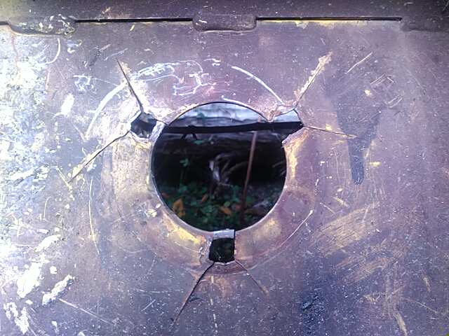

Looks like most of the parts are standard so I'm just trying to confirm from back of fan to sprocket orientation? The first pressed flange will have the raised portion in the hole of housing then bearing then next flange then locking collar? The old hole in housing is so distorted that I'm trying to figure out size of hole to drill? I'm assuming it's the outer diameter of the raised portion of the pressed flange?
Thanks
   / 47" Snowblower Rebuild
#13
This is a picture of distressed portion and why I'm replacing that steal.
