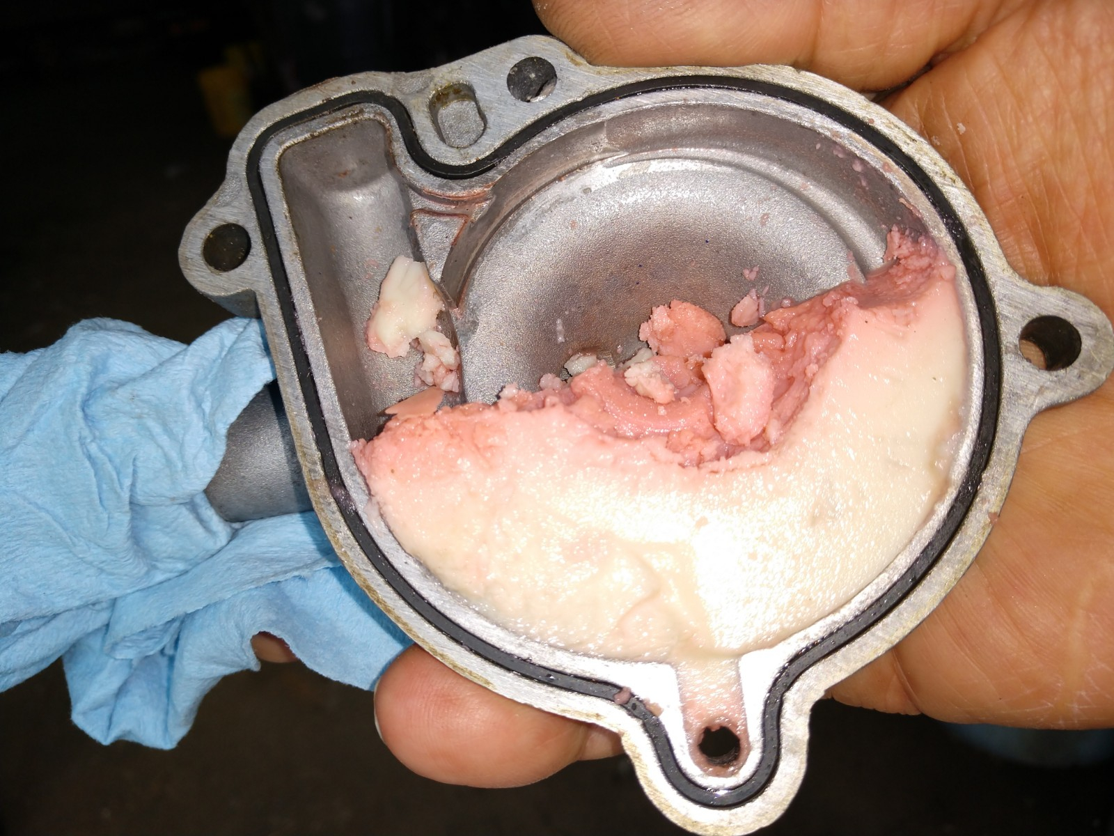

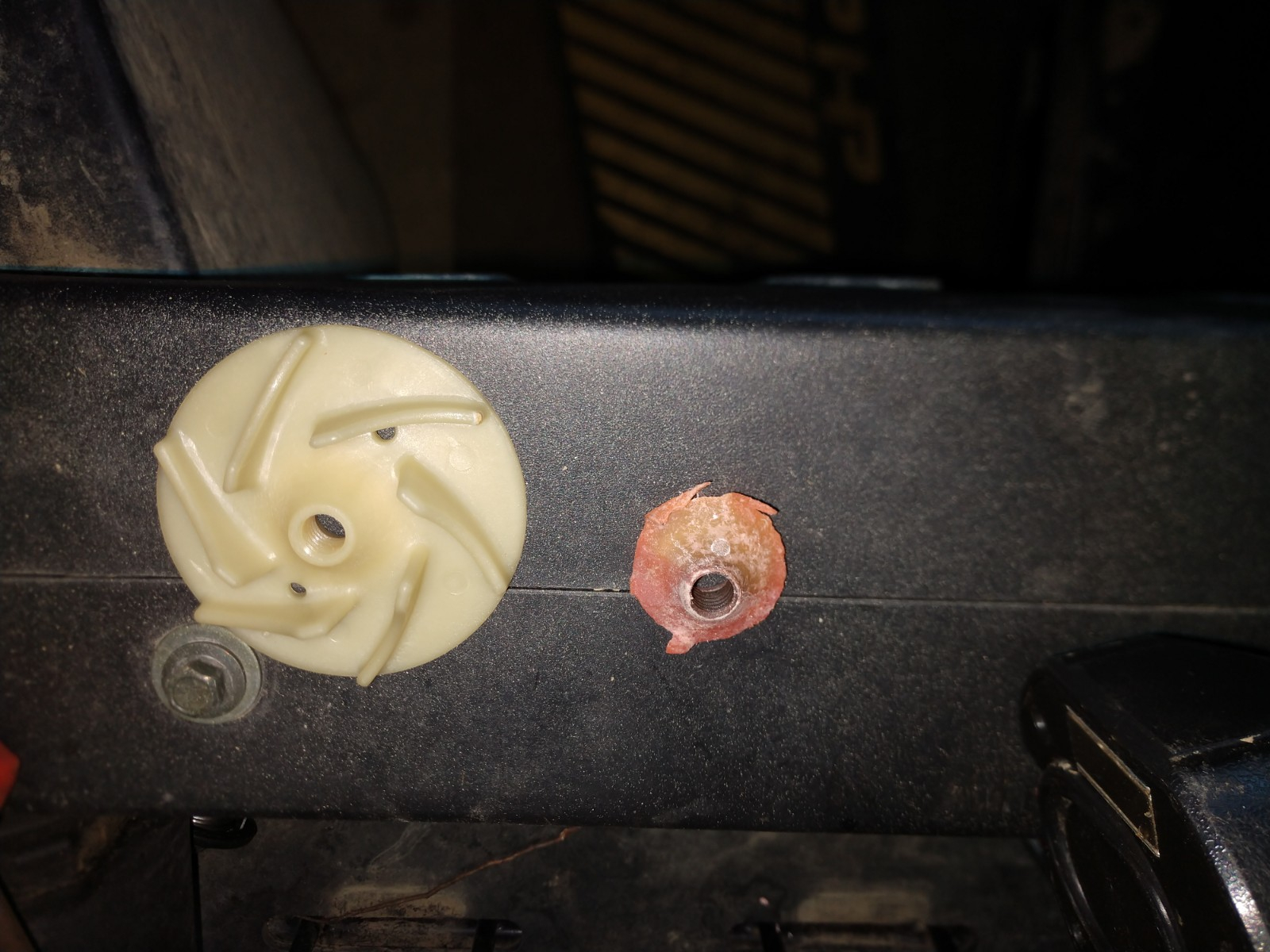

I changed the coolant in my UTV to a "long life" and thought I had flushed it good.
I have no idea what it had before or if someone had added something to the coolant system.
But I ended up with a hard waxy substance that seemed concentrated in the water pump
with just a bit in the lower section of the radiator.

And here is the new water pump impeller compared to the one removed
So I have no clue what to tell you other then be careful, and if you change it I'd recommend a really
complete flush which will be difficult to do in cold weather as most engine do not have a low point block drain any more
and draining the radiator will leave a gallon or more in the block.
