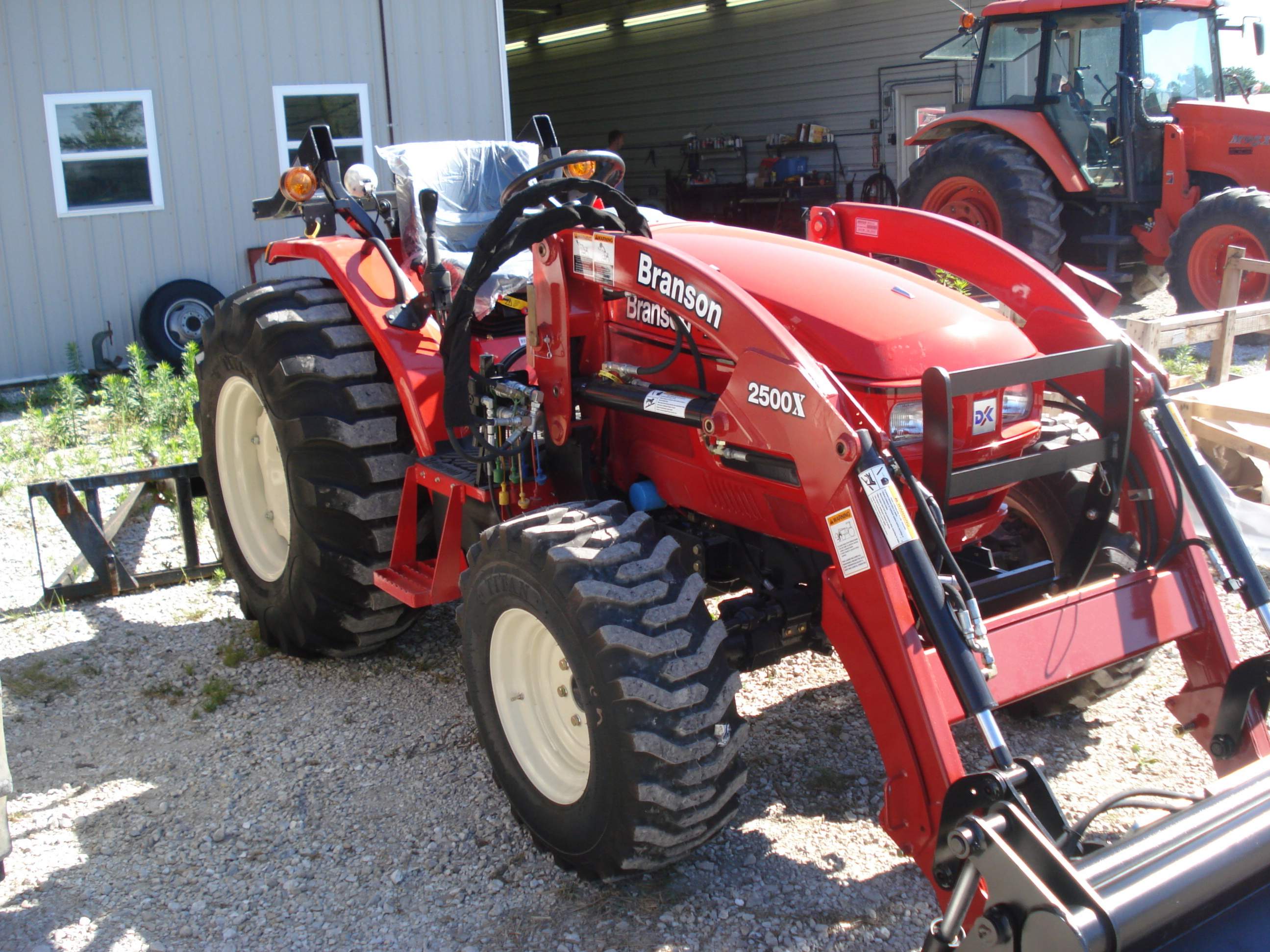

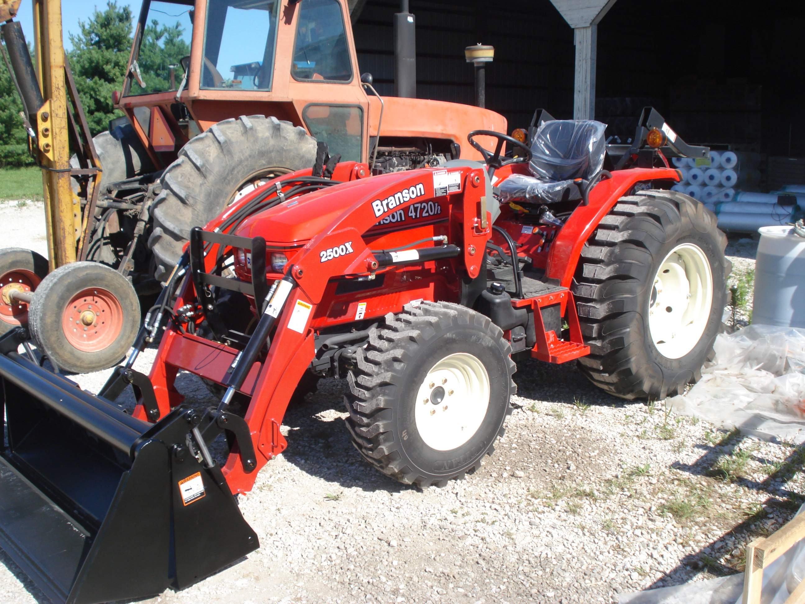

Haven't seen any specs on the new loader yet. I even emailed Amerequip, but didn't get a reply. The dealer called today to tell me the tractor is in, so I stopped by to take a look and get some pics. I like the new loader much better than the BL20S. It has better visibility, fender mounted joystick, third function, and it just looks nicer. Of course, it would be nice to know the specs before laying down the money. I noticed the label on the loader is 2500X instead of BL25S. Not sure if that has any significance.
It should be delivered next week. The dealer still has to swap the tires for loaded ags and install the rear remotes. He is trying for delivery Tuesday afternoon and it can't get here quick enough. I have renewed excitement and a lot of playing....err work.... to get done.
