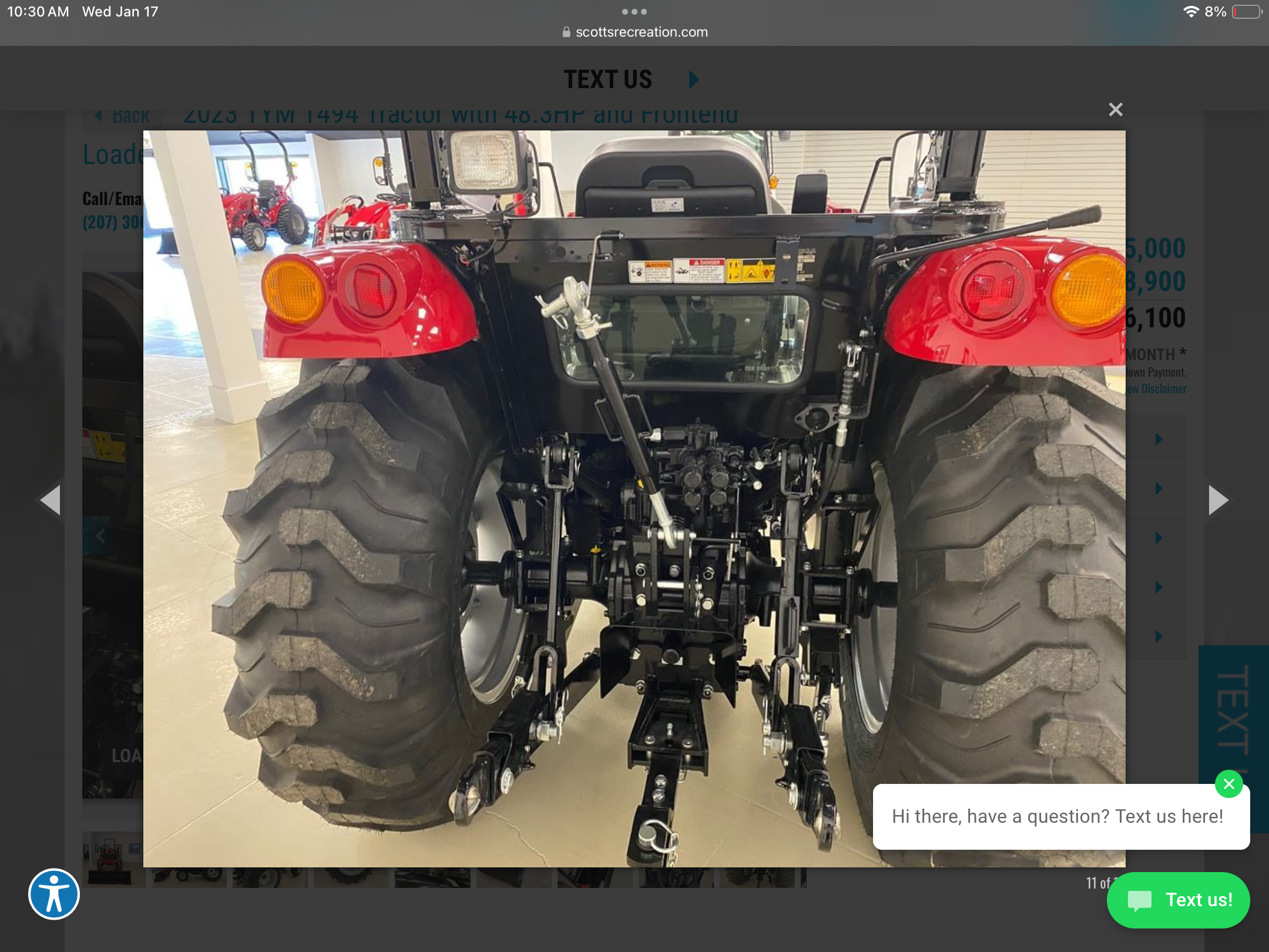

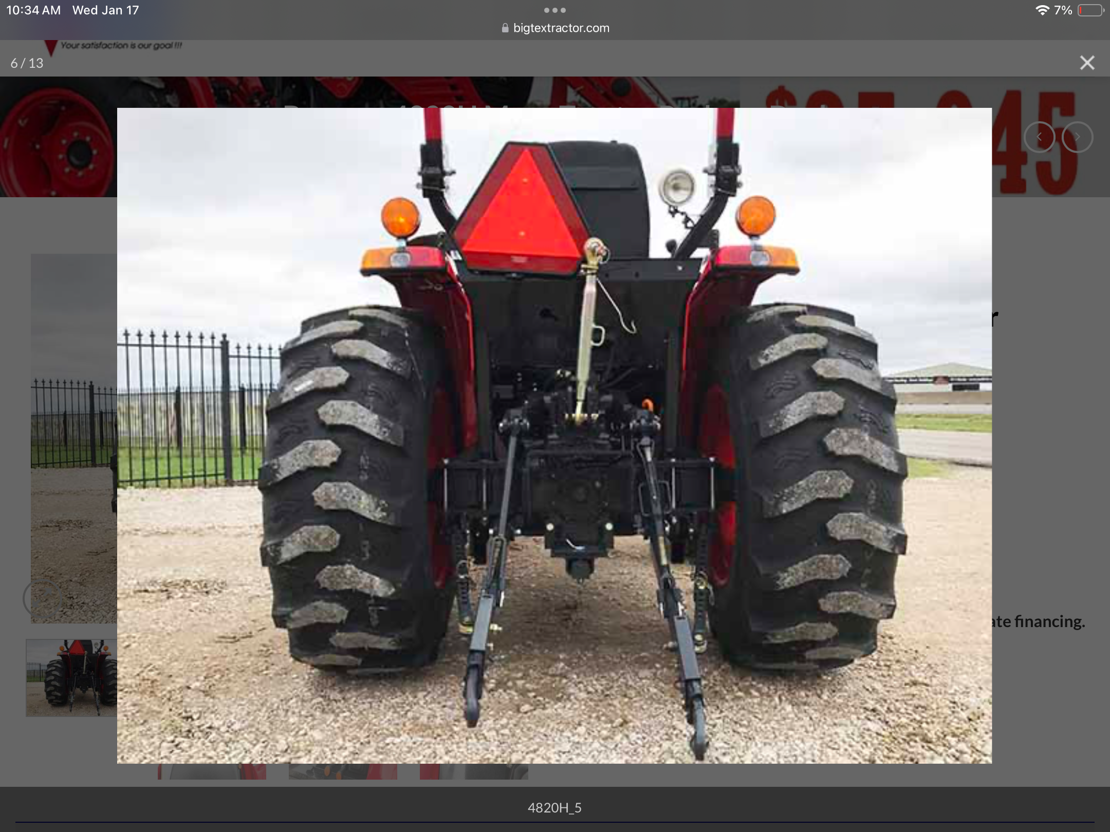

/ 474 v 494 #39
Having seen them in person on the same lot, the 4820 and 494 are very similar in size.
4820 is a heftier built unit for sure. just missing a few bells and whistles like the lever on the back for the 3 point hitch (the 494 has this)
Id go with a 4820 all day long but that's my 2 cents....
