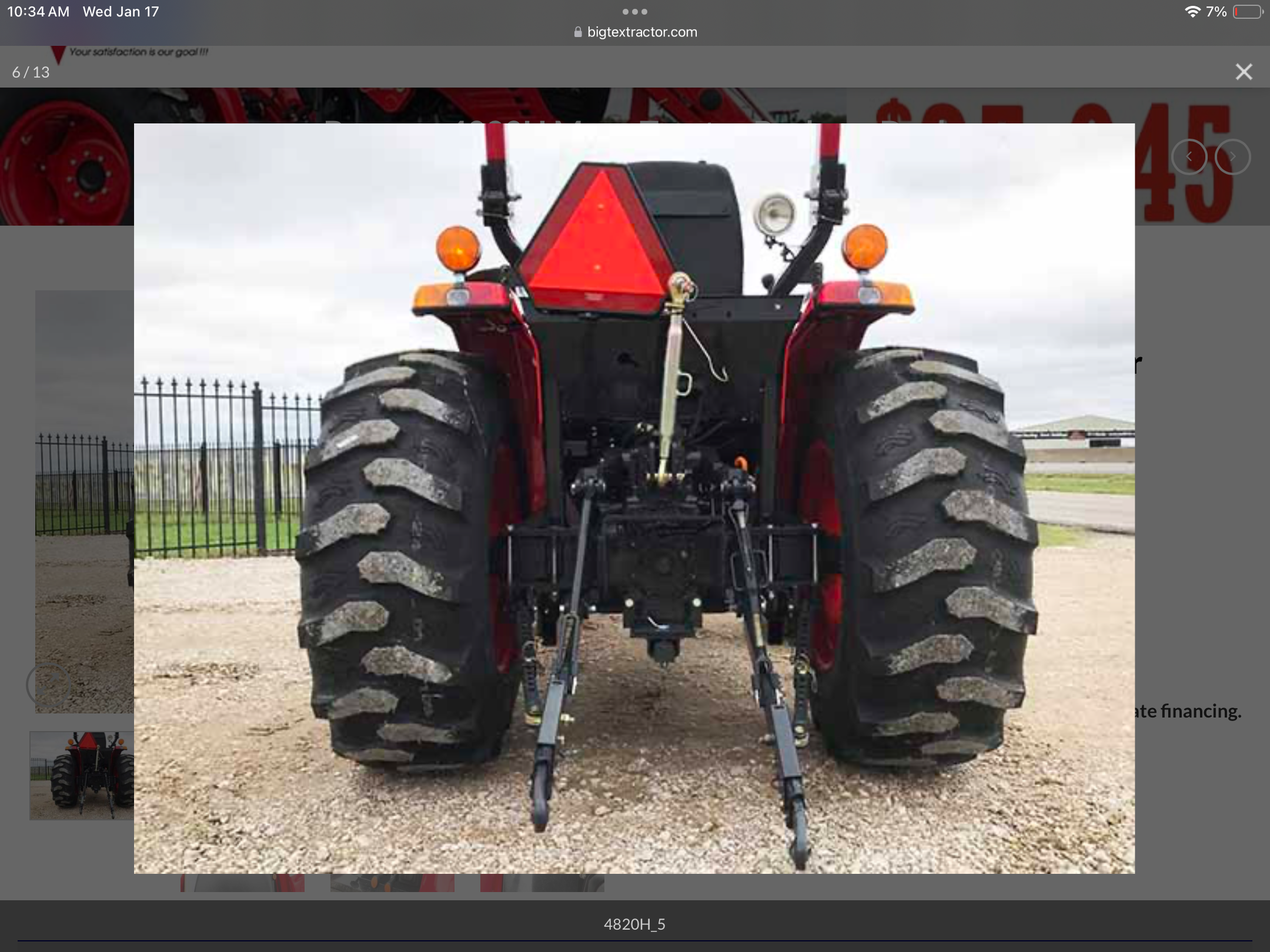

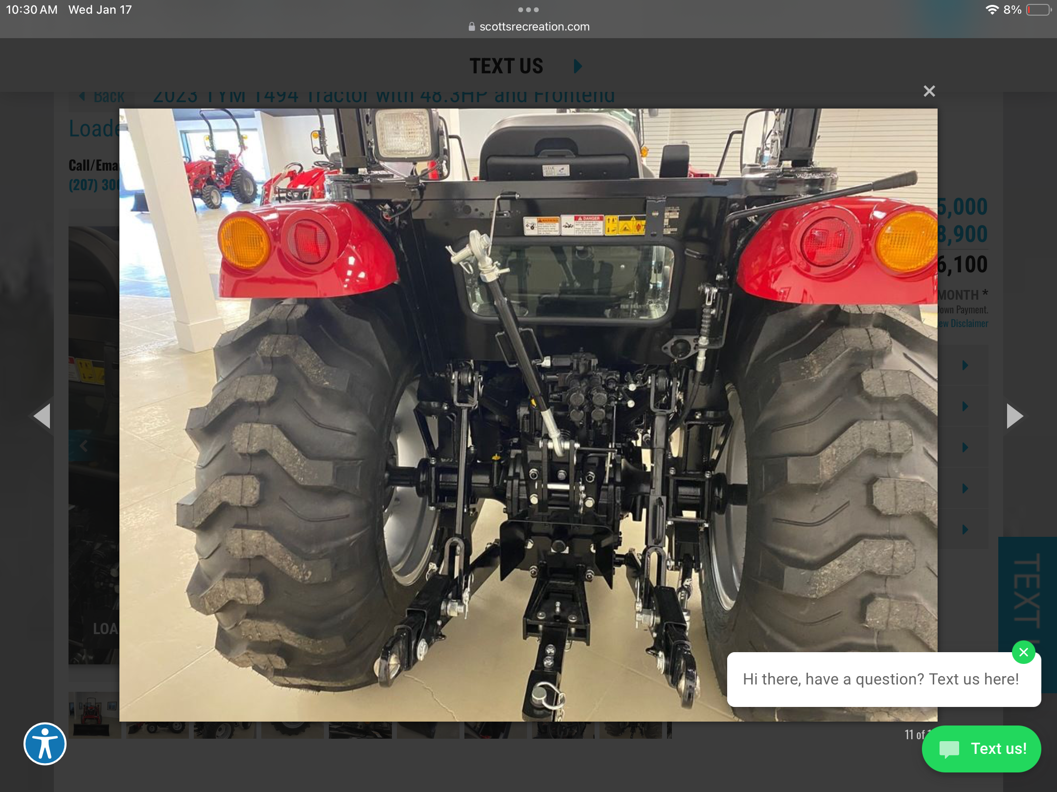

One thing I used to say all the time, was to look at the rear end of a TYM and a Branson model. Branson will have big axle housings all the way to the wheel, big and thick 3 pt components, amongst other stuff.
