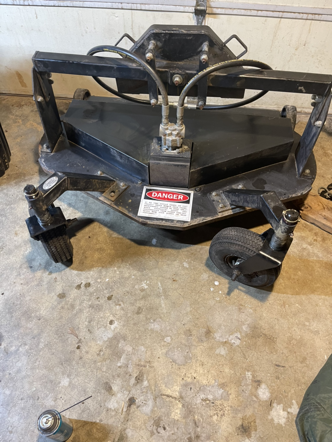

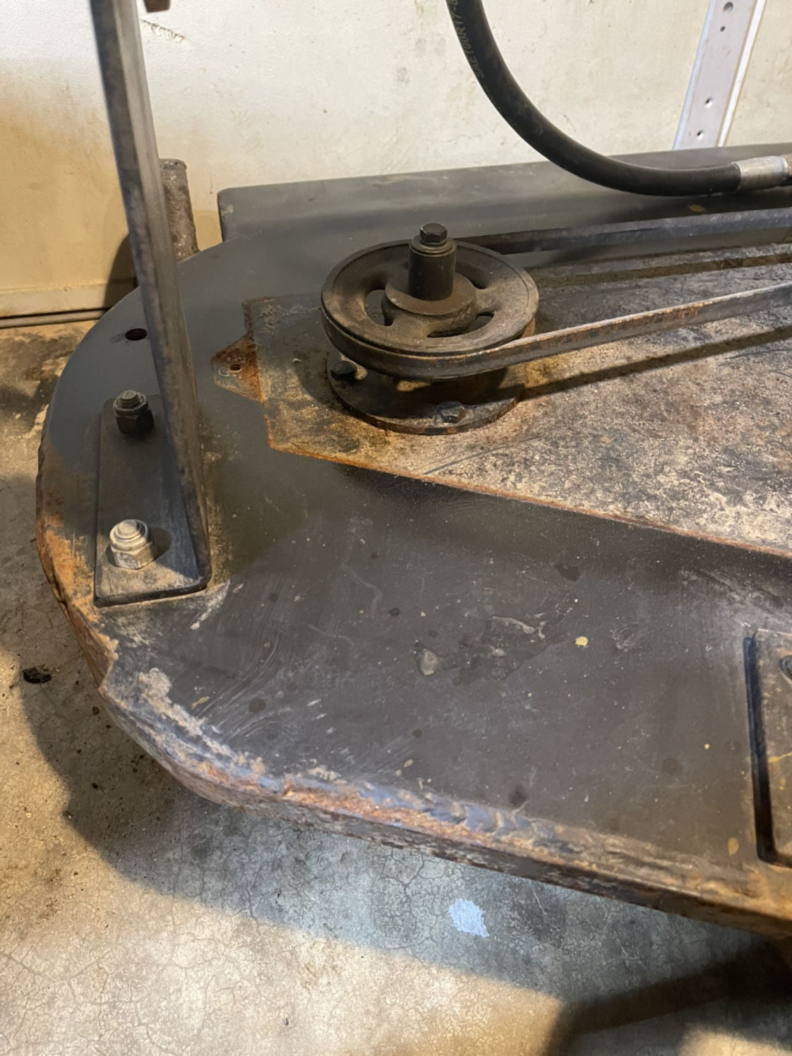

Massey 2706e
Not sure if this is all factory, as it was used, and I’m not sure of the age
But I was surprised to not find grease zerks, for the spindles, only to be told to look under the deck, and voila, there they are.

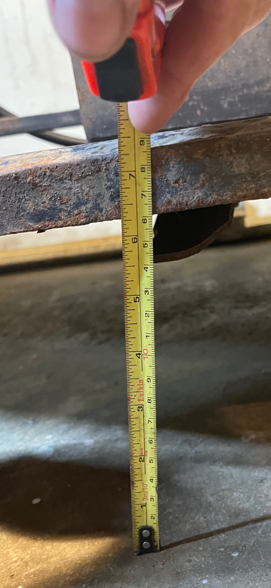

and that it has a cutting height of up to almost 6”.
Also a few years of neglect, can lead to a lot of acorns and debris under the covers.

Looks like there are collars on the wheels, might move them above the fixed journal. Not sure though.
   / 48” finish mower.
It does adjust to cut lower, by moving the collars around on the shafts. And moving the rear wheels to different holes.
I was just surprised it would cut up to 6” high, as I thought they told me it only went to 4”
I wanted it set as high as possible, to cut a clover patch.

Your deck's leading edge is at 6. I don't think your blade height is, though. I have. the same setup on my 60" deck.
I "lost" my belt covers a long, long time ago. :unsure:
