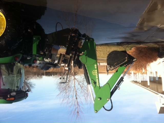

I think I have one more side view. It is off of the tractor now or I would get another one.
   / #48 backhoe attachment #22
Sorry I am not sure why it posted it upside down! Can you change it in your image editor or not? If not, I can try reloading the file.
Carl
   / #48 backhoe attachment #23
Will I have enclosed it a zip file, see if this opens in an upright view!
   / #48 backhoe attachment #24
Thanks, I was standing on my head trying to look at that picture though:laughing: The second was a little easier to see!
Does look like a pretty neat set up though:thumbsup:
