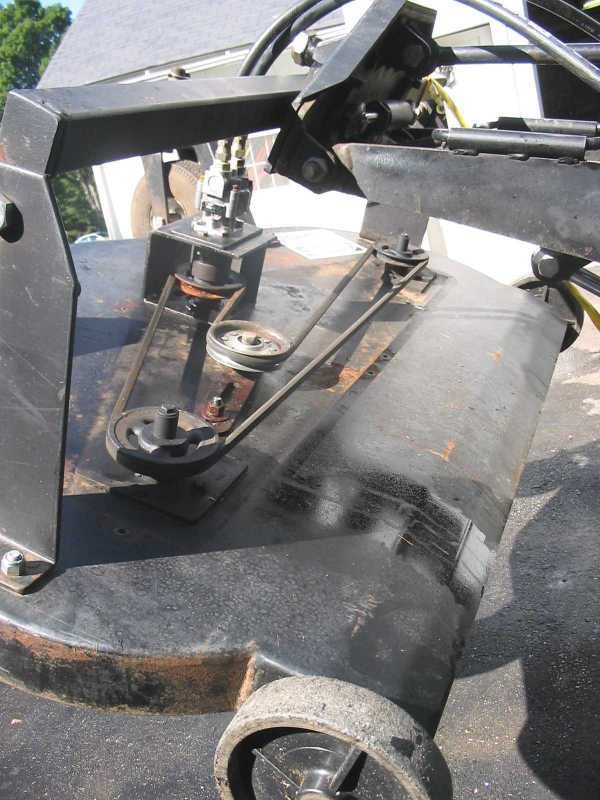

Boy, this is a weird one. I thought of all the things you guys did, too, like proper rotation, belt routed incorrectly, etc... The blade should rotate so the bolt gets tighter, so that made me thing if incorrect direction. The center blade is probably connected directly to the hydraulic motor through the spindle and has no slip connections. The outer spindles are powered by the belt which is rotated off of the center spindle and through the tensioner. The only way for the center blade to spin in the wrong direction would be if the hydraulic motor is turning in the wrong direction.

   / 48" Finish Mower Blade challenge #15
I've attached a pic of the belt rounting on the 60" mower deck -- I don't know if the 48" is the same. As Moss described, the center arbor is driven by the hydraulic motor.
Thanks. I checked the belts and all seems to be normal.
