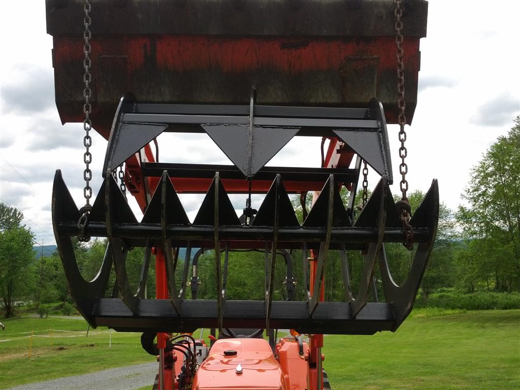

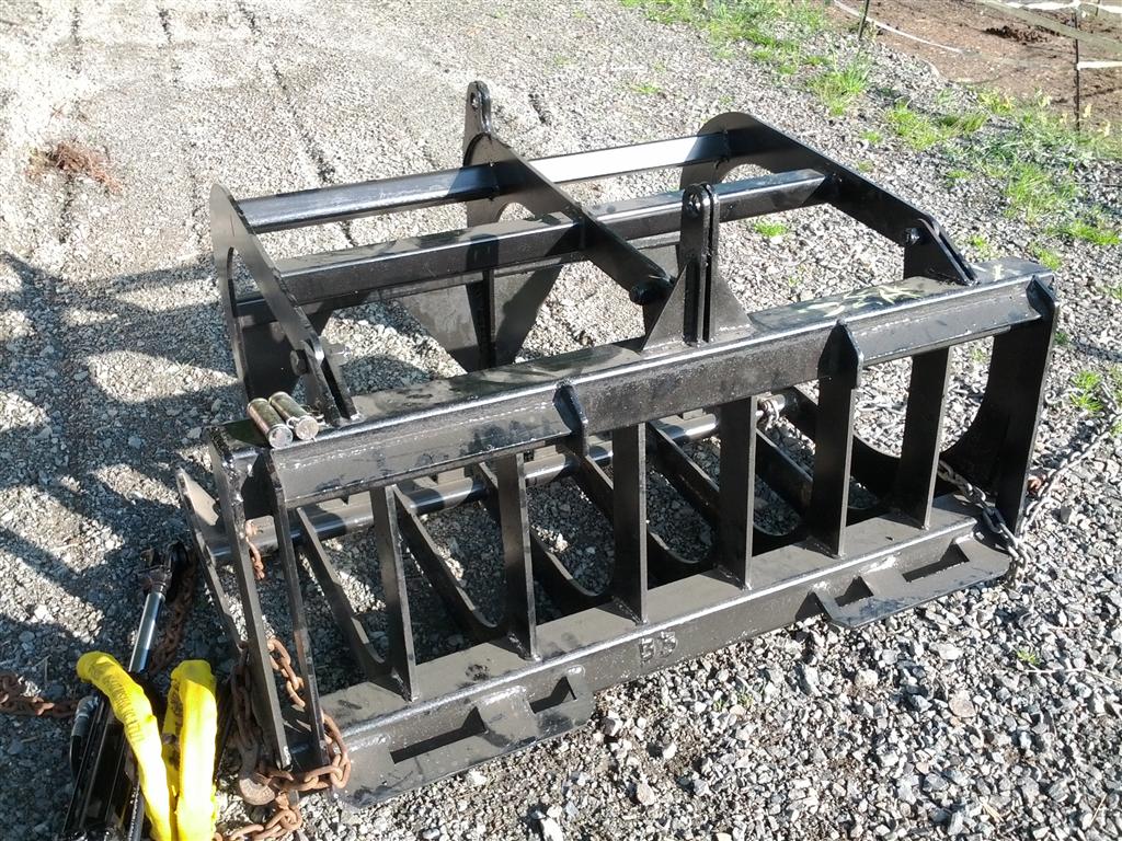

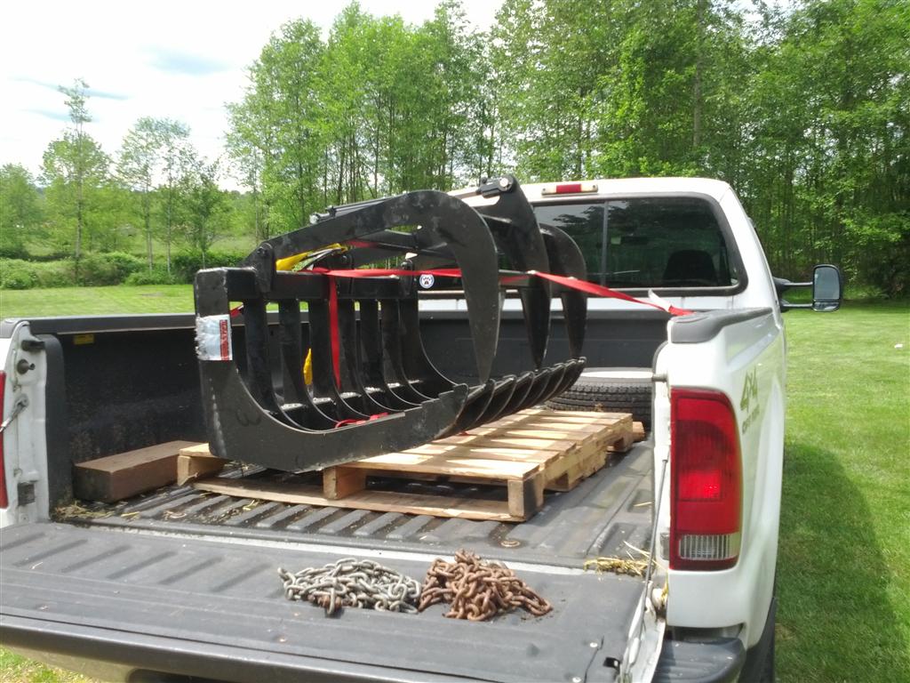

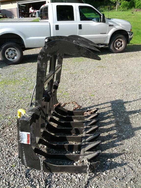

i picked up my grapple today, got it home and unloaded safely. i am really excited to use this thing can't wait until i get the rest of the parts to make this go. i was able to find a QA coupler locally at a dealer i don't usually work with, they are willing to take one of a tractor on their lot and backfill with a new one so i don't have to wait a couple weeks for one to come from georgia. i was a bit worried because this one is off a newer tractor and none of the part #'s match up with what i was expecting (L2216 vs L2230A) but i measured and it looks like a perfect fit though so 2 parts down 1 to go - last is the hydraulics. i was leaning towards the kit from wr long but from what i have read some of those are acting as a diverter on some tractors so don't want to spend the extra $$ on the 3rd function if it's not really 3rd function. i have priced the fasse and rankin kits but not decided which way to go. i think i want to have hoses built specfic to my specs since i don't want have extra hose to deal with. anyway here are some pics of the grapple!

i installed the QA adapter today (L2216) on my L3400 and discovered there is a pretty big gap between the pins on the QA and the bottom plate. the difference is approximately 3/8" on the right side and 1/4" on the left side. also noticed 1/4" between the bottom of the QA and the plate. i am guessing this amount of play is not normal and needs to be corrected. i was planning on welding some stock to fill the gap's so the fit is more solid, is this something to be expected with just these low priced grapples or is it common among skid steer style attachments? i would expect some amount of tolerance is expected but 3/8" seems pretty big. i don't want the thing to pop off so plan to fix it before i use it..

you are corrrect to fix it, there should be no play at all. It should be under tension as the beveled vertical spring loaded pins come down into the slots they should make good contact under spring pressure as the lever breaks over. There have been several reports of the gap, easy to fix and if you don't fix it , you run the risk of it popping off and usually pops off of one side and twists your QA adaptor torque tube.

I had the same issue. I called Connie and she sent me shim plates to weld in. Mine is perfect now. I am surprised they are still having this issue. She told me that some other customers had the same problem and they sent him shims out.

Big, my econo had the dreded gap also. If you don't shim it you will have no latch effect with your quick coupler. the pins have no preload to "cam over" and it can come unhooked. I just used 1/4" plate and adjusted both sides to give me about 5" of preload on the handle. It now fits tighter than my bucket. I also added 20" of bucket on each side of the grapple and use it as my firewood hauler!! It is good for about 3/4 of a face cord! I have had no problem with the 3/8" gap but I also extended the plates over past the pin to lessen the gap to 1/4". I could have used 3/8" thick plate but it would have been tight. I have about 20 hours on the grapple with 0 movement or wear. CJ

i just got off the phone with connie and she is shipping out 2 of the coupler plates which should take care of this problem.
