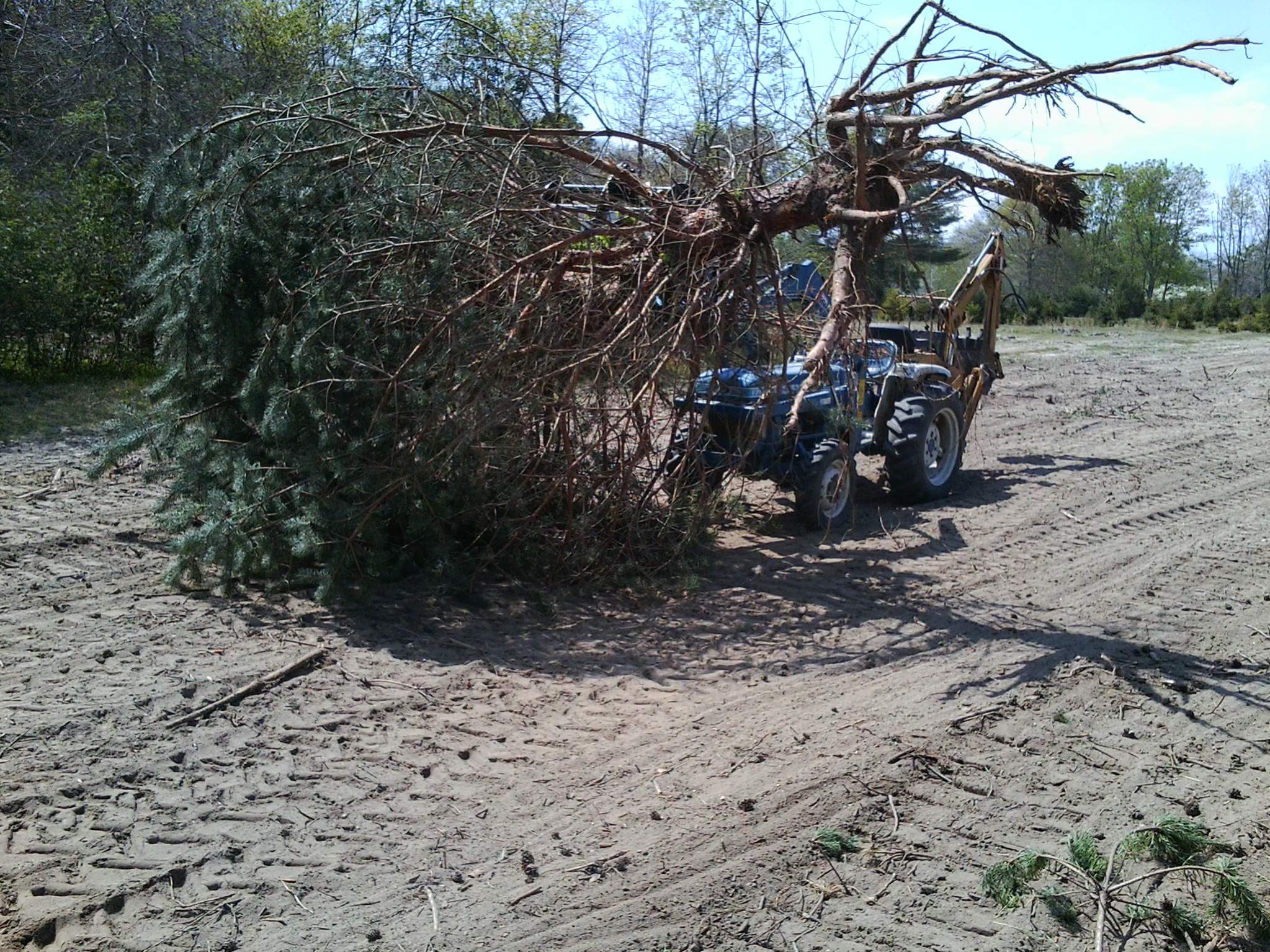

Thought I'd throw up a picture of my little Ford 1710 with the 48" grapple and a Long pin-on to QA plate . This is as much as the little 1710's hydraulics can lift.
Most of the old Christmas tree clearing was done with my Allis HD-9B dozer, but there were a few stragglers where using the dozer would have damaged other trees so had to dig them out with the hoe can carry them to the back. This was an overgrown Scotch Pine.
