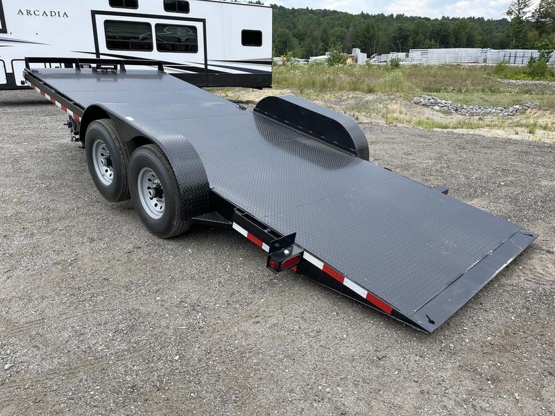

Yes, 10k GVW trailer, minimum. Trailer will probably weight 3k, 4820 cab weights 7k with loader and ballast.
My trailer is steel tilt deck. Never need to deal with ramps or rotted boards.

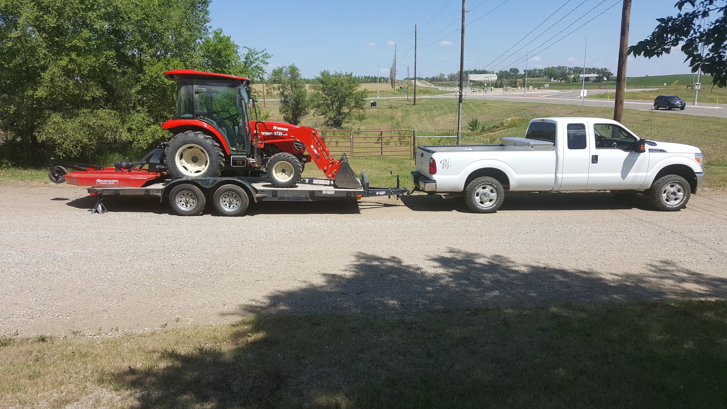

This is overweight on my trailer too. Not to mention over length (18 foot trailer). I do put a flag on the back. Notice the cheap Harbor Freight jack stands I set under the back of the trailer when loading or unloading (I just put the ramps away from loading, and hadn't chained it down yet or taken the jack stands out). I also hadn't put a shot of air in my air bags on the truck yet (F-250).
As the tractor sits in that picture, it weighs 7100 lbs. Trailer weighs 1900 lbs. Yes, it's overweight (by 1000 lbs), no I shouldn't be hauling it this way. Trailer brakes work well and it will stop just as well as the truck would by itself.
It "works", and I'm getting by with it. All of my trips with it have been short hauls and on flat ground. Doesn't make it right though.
