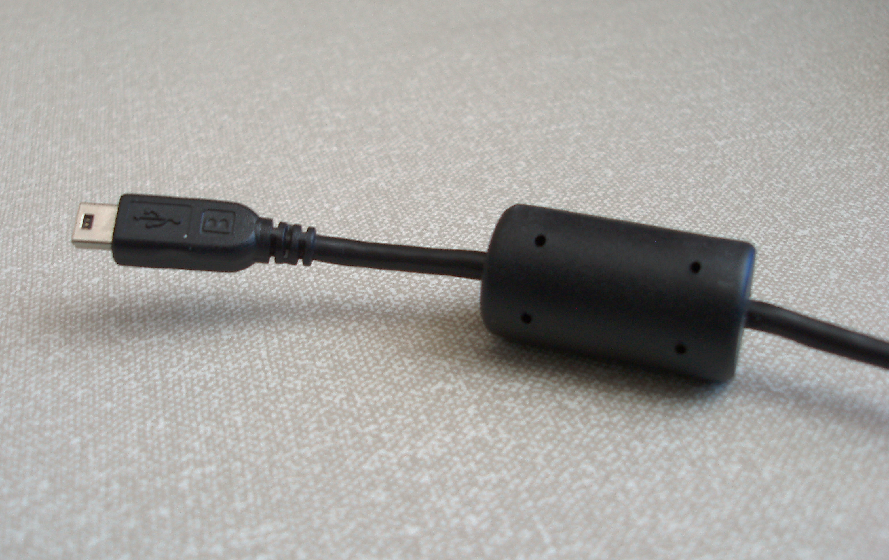

Try ferrite choke (not core) on the lights as noted, but not the one shown from Mcmaster. You see these on a lot of power cords for electronic devices. Digikey or Mouser or one of those type places.
ferrite core cable - Google Search
This should look familiar to you. The round thing on the cord is what you should try.
