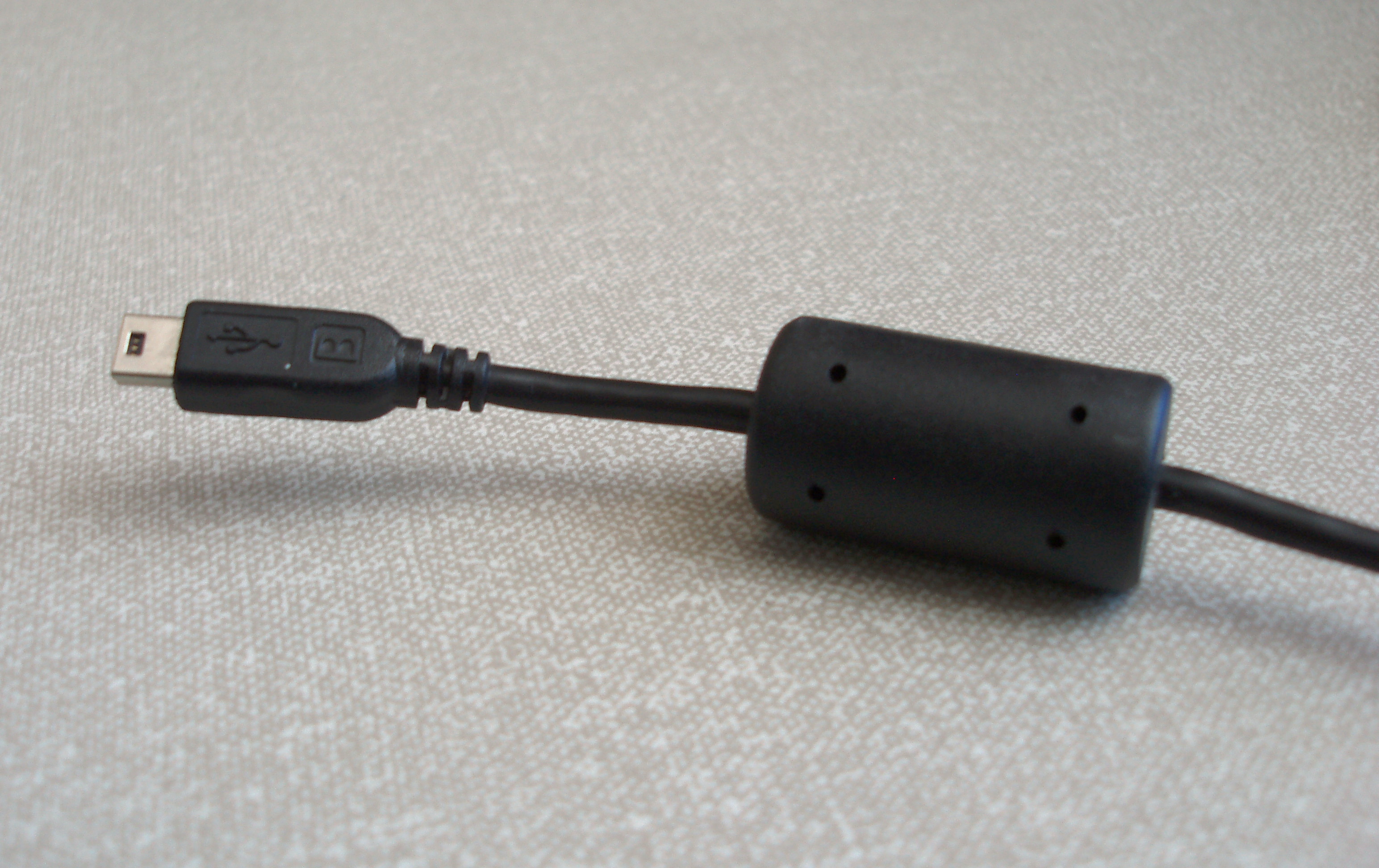

Try ferrite choke (not core) on the lights as noted, but not the one shown from Mcmaster. You see these on a lot of power cords for electronic devices. Digikey or Mouser or one of those type places.
ferrite core cable - Google Search
This should look familiar to you. The round thing on the cord is what you should try.
I use the snap on ferrites to cure my problems when I operated on my HF radio I would turn the light on as well as open the door at times! Solved the problem!
https://www.amazon.com/Parts-Express-Ferrite-Noise-Suppressor/dp/B0002MQGEK
Yes, what these two gents said. I'm not an electrical guy and couldn't think of what they're called.

Got them yesterday, installed today, no change.
Talked to an Electrical Contractor today. Said he has two buildings with same equipment, same problem.
One last thing I'm going to try. My shop is 35ft from my transformer and meter pad. They are grounded with a copper rod driven into the soil. I did not do that at my shop. Tomorrow I'll add a ground rod. I'll report my results.
