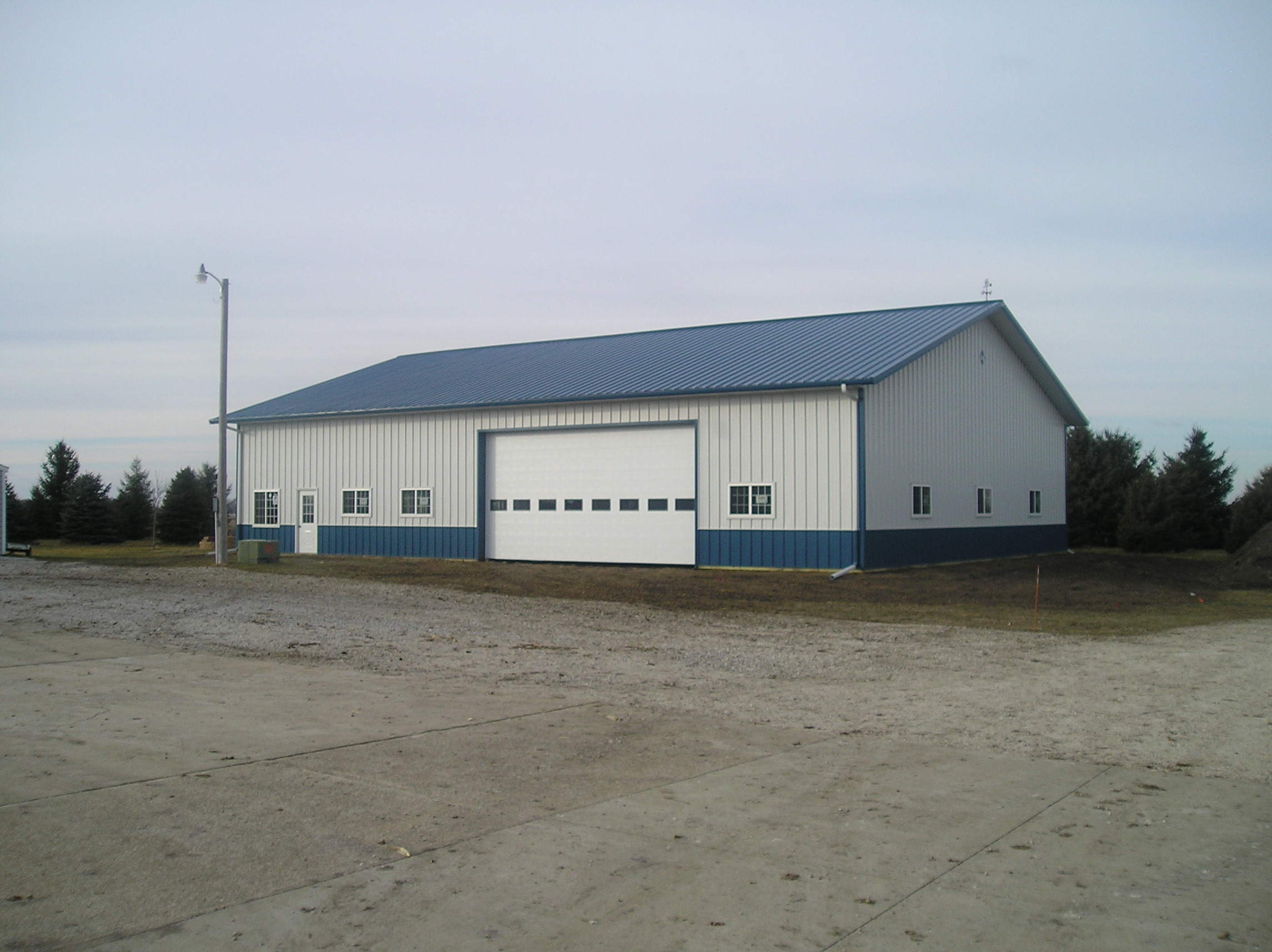

I'm almost positive that my problem is the ballasts. They are emitting a radio frequency very similar to the frequency used by my openers. This creates "noise" that the opener can't handle. So it never "hears" the remote signal.
If your lights function without similar ballasts you should be fine.
I can't find anyone with this problem. I've talked with others that have range problems. But none that are as specific as mine. Just my luck... :)
Not quite true... Any cheap power supply will have issues. You are right on a noisy RF enviroment drowning out your opener though. The cheap LED light bars I put on my tractor cause RF issues as well. 2 different brands & sizes. The front only causes maybe a 75% loss in signal when I flip it on (radio is pretty much useless) & the rear a 25% loss in signal.
LEDs run at 1.8 to 3.3v DC generally. So generally every power source needs a power supply to convert things from 110v AC or 12-24v DC. These days it's all switch mode power supplies. They switch on & off really fast to lower the voltage. Generally cheap & efficient, but all that switching is at RF frequencies & can be as noisy as the flourescent ballasts.

My 5 year old tin shed has never been a problem with the radio or opening the door.
But I got to thinking, I never have the 20 - 6 tube T8 florescent lights on.
I have 8 windows in the overhead door, one in the service door, and 10 in the west,east & south walls.
so I really don't need the lights on very often.
Today, I turned all the lights on and tried to open the overhead door..... no love, just like you.
I had to be inches away from the door to open it.
So I am watching and listening.
I will also be calling my lift-master door installer after the holidays to inquire about a solution to this problem. P1010058.JPG

Yesterday afternoon I installed a coax and remote antenna outside on one opener.
With lights on I can now open that door outside with a range of 20ft. Opener without remote still requires touching the glass.
With lights off I saw a little improvement in regards to blind spots where the opener with antenna has less issues.
With lights off driving toward door end of shop I have a range of 300ft on both doors with and without external antenna.
   / 48x39x14 shop build #350
Did you connect the coax internally or externally to the opener? The instructions I posted above for internal/direct connection was to overcome interference more than just the extended range, and the interference most people were posting about was due to LED light installations. I think LEDs stand a very good chance of having similar interference, so I think you're on the right track with the coax extension.
