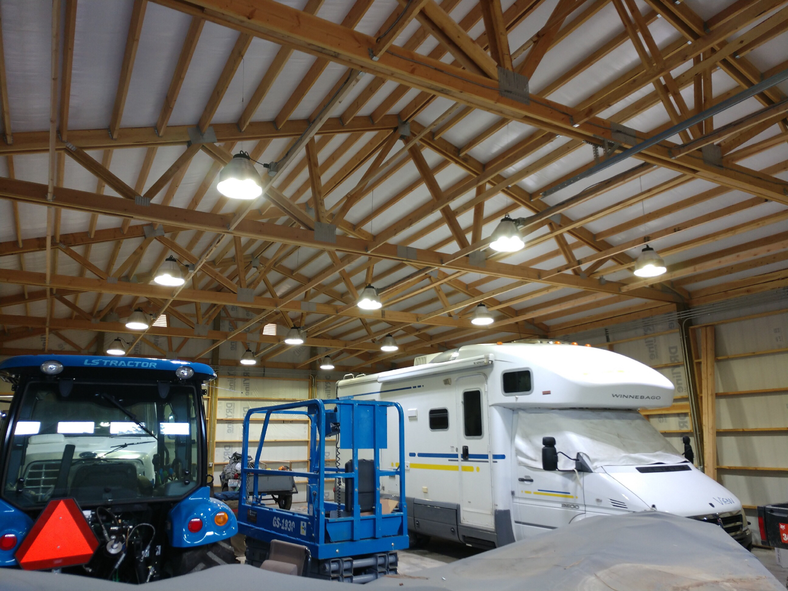

Well, if all else fails and I can tell you loath the idea, high bay LED lights are an option. My neighbor has a 40x60x14 shop with no ceiling and installed just 4 of them in his shop. Huge difference in lighting that size of shop. You literally can not look at them they are so bright. He order them off of Amazon. I think he paid $130.00 for each.
   / 48x39x14 shop build #329
Here’s my 40x60x14, no ceiling with LED high bays (15 of them to be precise)-don’t lack for light!!! Image1545407972.960818.jpg
