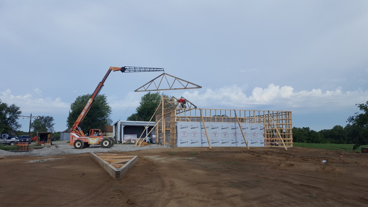

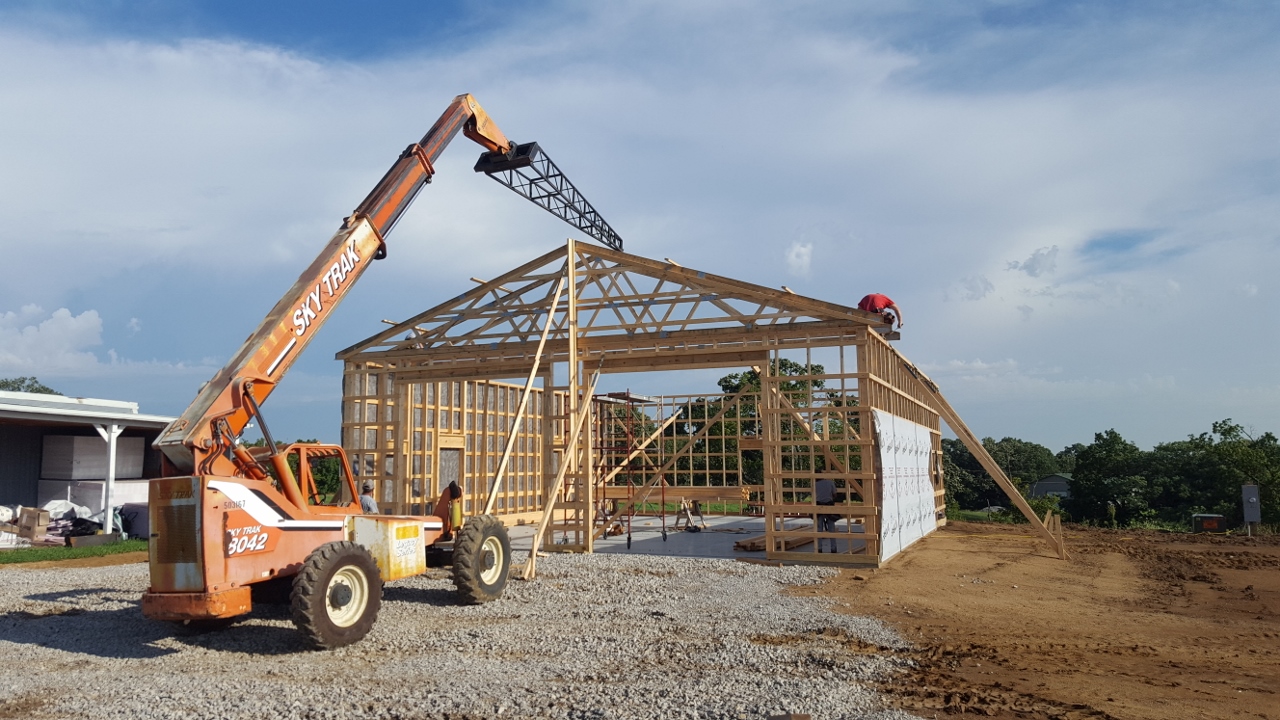

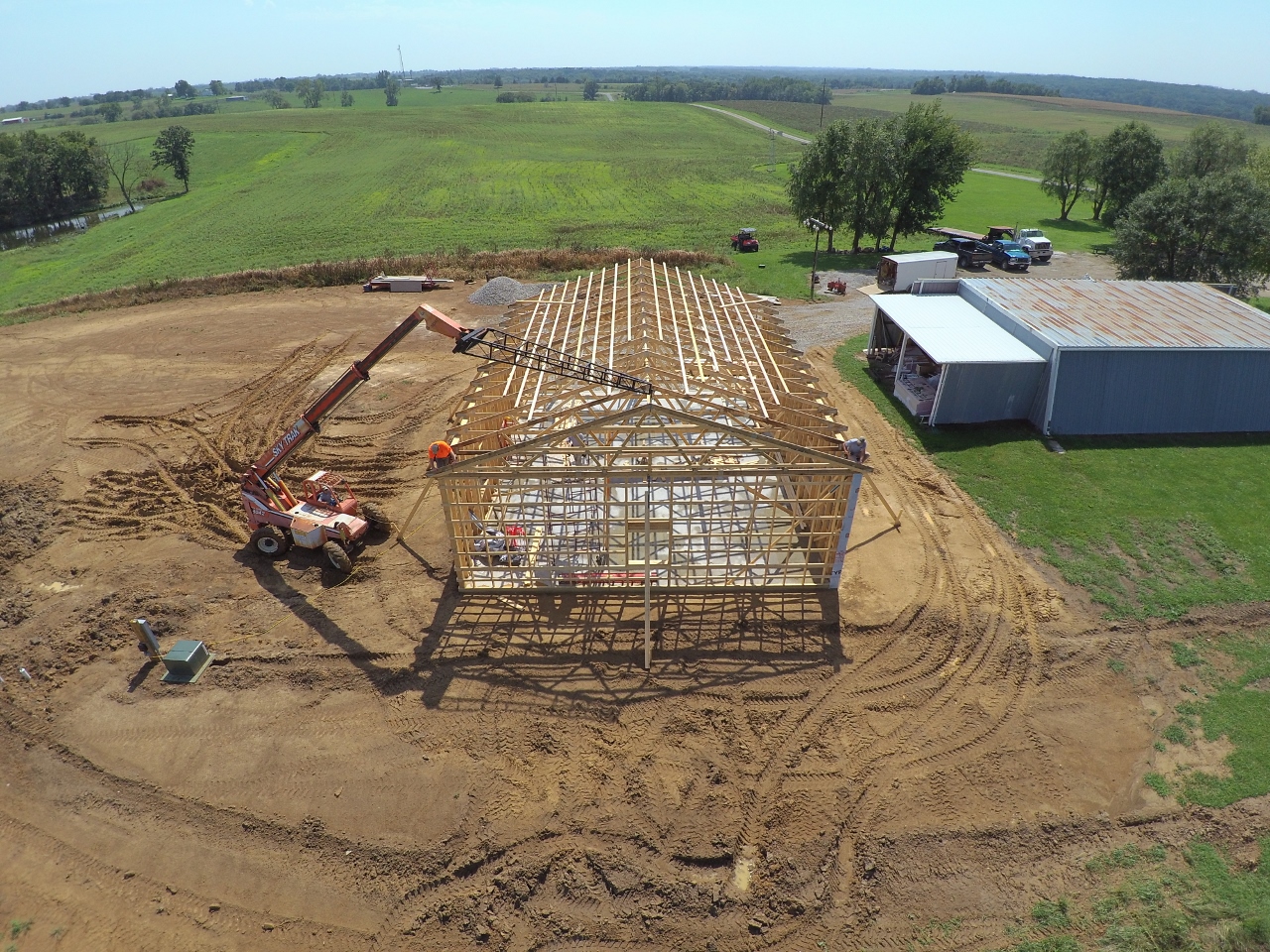

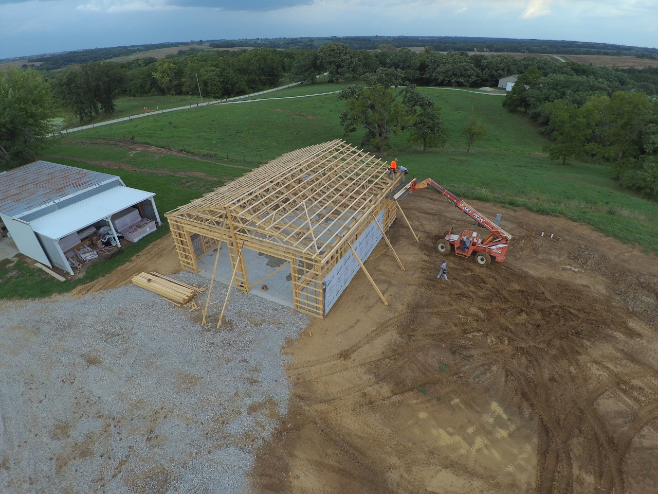

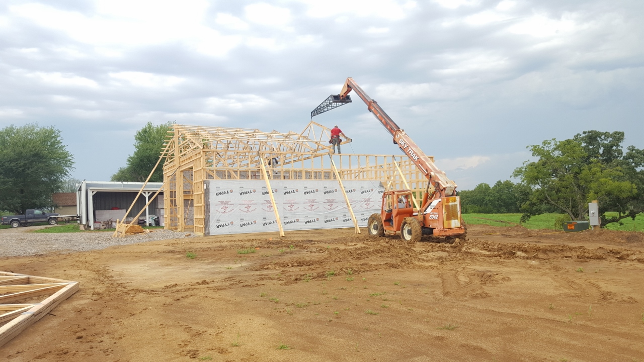

Installing rafters. Stiff wind blowing. The Sky Trak makes it look easy.
Rafters are on 4' centers. 2x4 purlins laying flat spanning the rafters on 2' centers. 12" eave overhang. 18" gable end overhang.

I'm really enjoying your drone pictures. The give such a great overview of your project that I've never seen before. Makes me want to get one!!!!

Thanks Eddie. It's a hobby I enjoy. I shoot a lot of video and pics of people's properties. Especially new builds. I'm following two new house builds now plus my own. When I get time I'll edit and post some video.

I see trusses, not rafters. Am I confused, or just a terminology difference?
